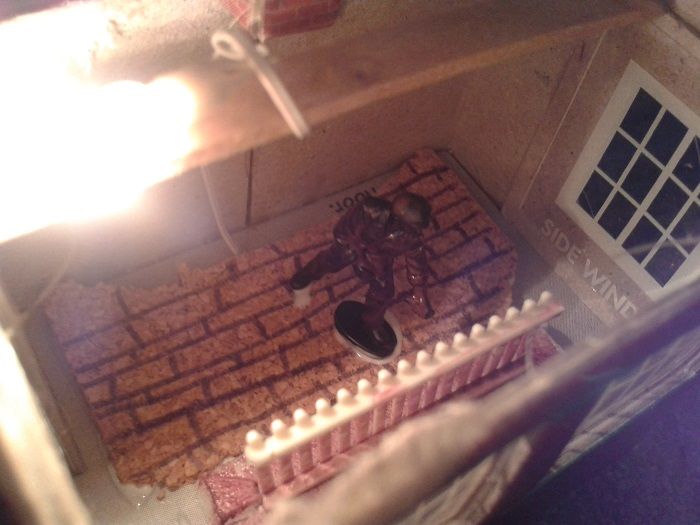

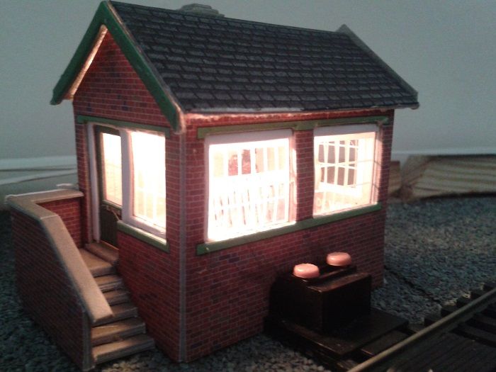

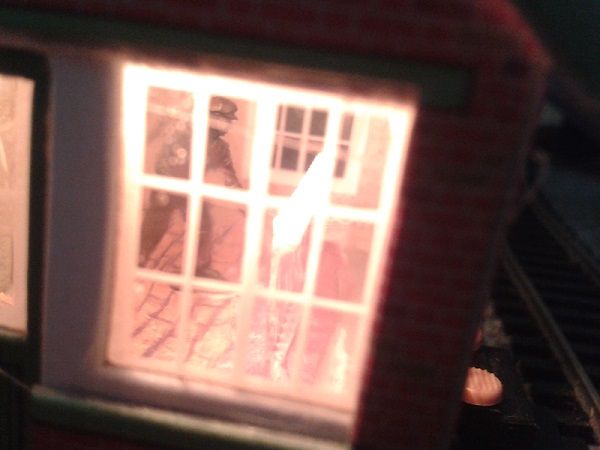

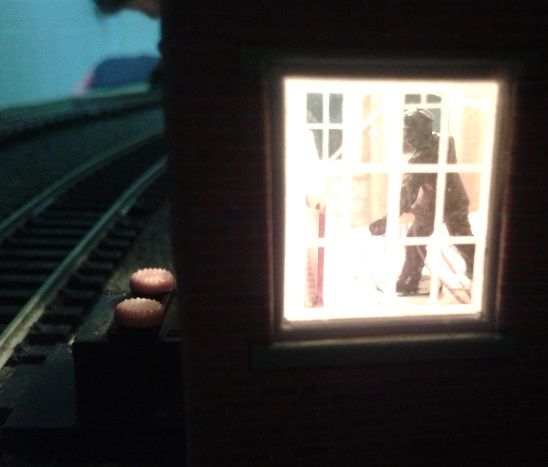

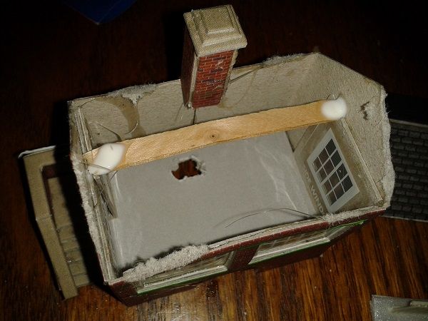

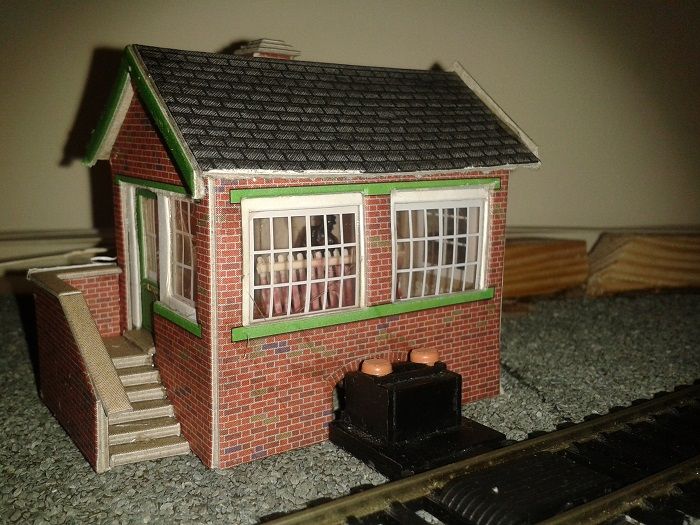

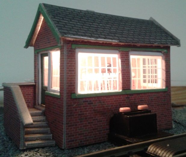

Ok, Piccy time, though Graham you may have seen some of these on my facewacey book, here are some pictures of me lighting up and detailing the Metcalfe signal box that came with Railway Modeller aaaages ago:
The Componants at my disposal
Glueing a wooden bracket into the top of the signal box from which to suspend the light
With flash and lighting inside box
Box lit, without flash on the camera this time
Cabin interior
From the front
The bulb is a skale lighting one from the lighting stuff I bought off a member on here ages ago, the flooring is cork with biro on to draw the wooden floor planks, the signal man is a fireman with his shovel chopped away, less convincing like this but from outside he looks the part, fencing which underwent some cutting and some styrofoamy stuff from a pizza which was cut up too were painted kinda purple (only colour I had, also covered signal man in but its too soft a colour on the black to be noticeable) and glued in place. I wanted to make the bland and all too visible interior slightly more interesting :)
From the other side window
Looking in the door

Outside with flash again
Outside without flash (the light leakage from the rood is noticeable llike this, but when you are stood up next to the layout you can't see it)
What do you think of that then???

Not a BR Period box then. You'd only be allowed a 30 watt bulb in a box that size :( Serious though if it was too bright you couldn't see the signal lamps. Unless that is you'd been upgraded with the high tech oil lamp detector, a thermistor in the top of the lamp housing, with 2 wires for each signal going back to the frame room where there was a mahogany framed cabinet with rows of telephone switchboard style winking eyeball indicators which closed if the lamp cooled down. The eyeball closing sounded a bell upstairs and the lampman, or at night the poor signal man had to trudge down to the signal with a spare lamp.

That all sounds very high tech, My signal is operated by a wire that has one end going under the box and then down through the board, and its a Hornby one which doesn't use lights (shame really, maybe one day I can afford to get a dapol operating signal fitted, now that would be awesome). I don't model any particular period, but I think any signal man would be pretty annoyed at a light that bright just above his head, its no wonder my signal man looks so tan!

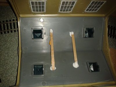

Some more pictures to bring this thread almost up to date (will get some fresher pics tomorrow):

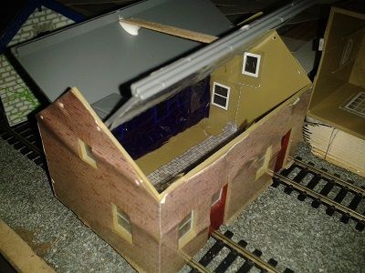

Gluing the roof brackets for the lights on the white cottage's roof and the inside of the cottage painted grey to avoid light escaping like a flood on a plain.

By using left over sweet wrappers from quality street's that I cunningly put aside for this cunning plan, I cunningly celotaped different colours to the inside of the cottages to make the window give off a different glow, warm orange for out the front, and a cooler more night time pinkish glow for the rear of the properties.

You have been busy! Nice work on getting your buildings illuminated. Budget method done well!
