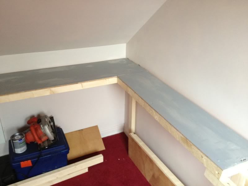

Work begins. Like I say, I am no joiner and this is my first project, ever...at least one where I need to be pretty specific in measurements :lol: It doesnt look it but the boards (as you see them here) can hold my near-19 stone frame with ease so thats sturdy enough for me :D

This was todays work - I did try to cover it in the halfords primer that I've been reading so much about but 1 spray can did a board and really stunk the room out (yep, I had the window open) so this is Wickes (my workplace) grey undercoat. I am colourblind but I think it is the same colour?

If you have more plywood to cut then it's best to pin another sheet to it. That way you won't get splinters at the edges. Also adjust the saw depth so that it only just cuts through it. You'll get a smoother cut that way.

Nothing wrong with that joinery there... There is no specific right or wrong way anyway, if it works its good... Like the look of the plan aswell.. Should be a good one indeed... Shall be keeping an eye on it and see it prgress.. And I don't suppose you're planning on putting your 19 stone on it too frequently are you..? :lol:

Hi Sean, looks a good sturdy base for your layout. Putting in a lifting bridge is the right decision, but do re-consider re hanging the door to open out, even if you have to sub-contract the job to a professional. It's ok putting the bridge piece in place at the beginning of a session and taking it out at the end, but if there's a sudden need to exit the room, opening the door and hands and knees escape is called for. Also you may wish to keep the door open whilst you are in there, that little bit less isolated than with the door shut.
