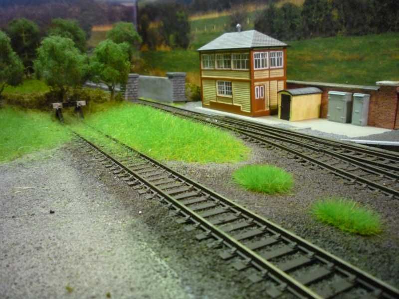

Postby jamest » Tue May 08, 2012 9:44 pm
Cheers Harry,
Doing the tufts made me think about the possibility of making the road over the station a bit more 'rural'. So I did a quick experiment with a long thin squirt of PVA and I think it has potential. I'll need to 'grass up' the edge of the road too - and make it a bit dirtier but its a good start and the long tuft is pretty resilient and easily move-able.
I've also placed the base for the signal box down and covered the last bit of cork! I've ballasted around it and placed the bits and bobs on top before I paint the surface. Does this arrangement make sense to everyone?
I've also re-jigged the embankment down from the road bridge - this was my first attempt with the Grasmaster and I wasn't too happy with it. I've also added a tree in place of the bushes:
And while I had the camera out I snapped away at some of the scenery completed:
Grass tufts in place (a bit green at the moment):
Some other shots, quite pleased with how the scenery is developing:
And a new one from the fiddle yard hole over the bridge:
James

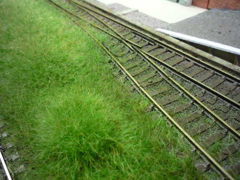

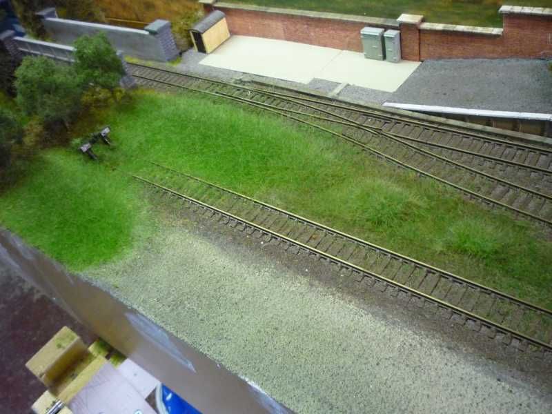

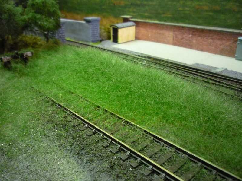

Postby jamest » Fri May 18, 2012 8:42 pm
You've almost convinced me to buy the Grassmaster...
Hi,
Here is some more evidence for the purchase!!!
As I mentioned earlier I ordered some autumn and winter fibres from international models - and they arrived yesterday. I couldn't resist having a go with them today. I've dusted over the existing grass, first with the autumn green and then with a mix of both autumn and winter. The shades seem a lot better to me.
I have to take pictures under the lights of the garage at the moment so the colours look a little greener than they are in real life. But by comparing to earlier shots the difference is clear. I'm also getting better at using the Grasmaster:

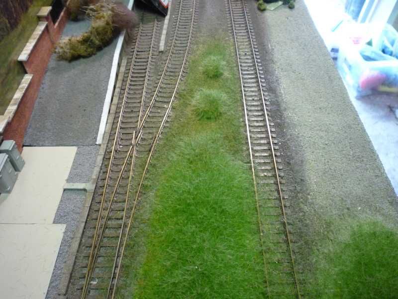

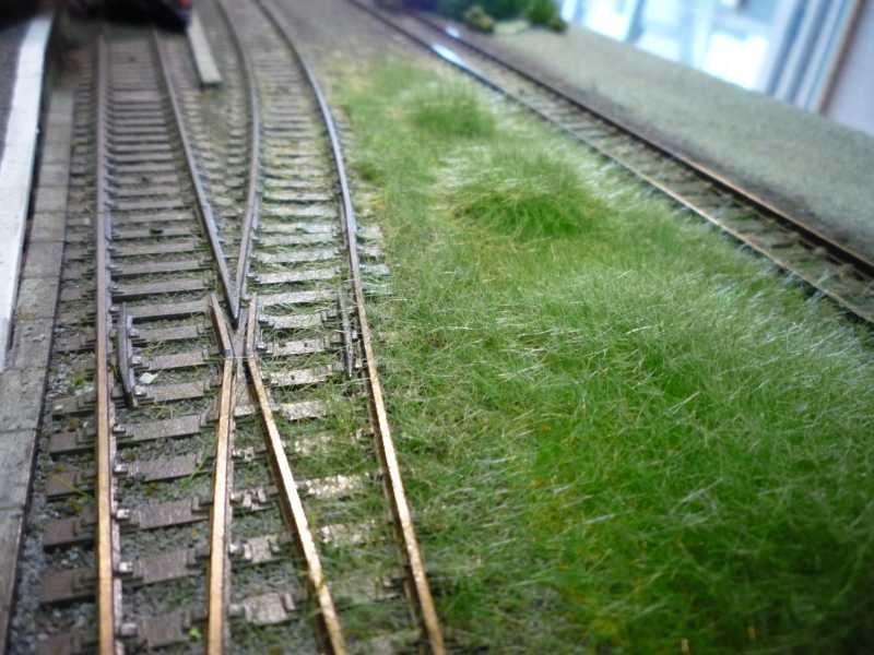

I've also extended the grassy bank further up over the tufts I placed down in an earlier post. I think I may have gone a bit over the top - would the railway have allowed the grass to get so close to the line? It also looks a bit like a lawn at the moment so I need to add some un-unifirm growth in the shape of bushes, weeds, etc.
Here are the tufts before:
And here they after a growing spurt!
I'm really happy with the effect - I just need to reign in the enthusiasm a bit! Might need to get the strimmer out!
James

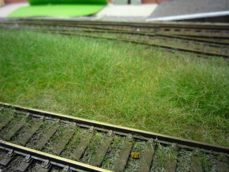

Hi again,
Bit of a photo heavy update again - but the sun was out in Bratton Fleming this morning and I thought I'd move the layout into the sun and take some better shots of the grass now I've mixed it up a bit. I've 'strimmed' close to the line with Henry the hoover but I probably need to do a little more.
It also enables me to get further away from the layout for a scenic section shot:
You can see the grass is not as 'green' now I've mixed in the autumn and winter fibres:
Thought I'd get out the 108 as well, my photoshoot companion of choice!
As I said earlier it needs to look a bit more unkempt and not like a front lawn but its getting there.
