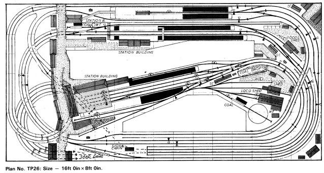

Im realy struggeling at the moment to get a plan sorted for the new layout but flicking through the peco plans book I quite like this..
The size is the same as the space that I have so it gives me a good idea of what is possable. Looks like I will be getting some lining paper at the weekend.

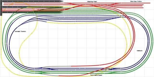

Ok heres the master plan..
The red lines are the top level, blue and green are the middle whilst yellow is the lower return loop. At the left we have Linslade tunnels as the secnic break moving on to a rebuilt trent valley junction then a 4 track viaduct before dissapearing into two tunnels. The lines to the station will be on a higher viaduct. The area between the viaducts will feature the houses and warehouses off the heatherburn with a recreation of the canal scene. The right hand side will be the end of the garage where the patio door is going. As the line now goes under the station in a tunnel I mightcurve the depot area round a bit in the corner.

Wow- that's some plan!
I hear what you say my friend about struggling through the hard times. I've just been there and now there is light at the end of the tunnel as my business is now starting to take off after going alone.
To keep my sanity I embarked on a new layout made with scraps I had laying around and bits and bobs left over from older layouts. I spent minimum money on my current layout by reducing the amount of points ( in fact none on my current layout ).
Your planned layout looks so interesting- I do hope it gives you so much pleasure when creating it for real.

Re: WCML in the garage
My N gauge trumptonshire layout is no more. Now that it and Heatherburn are out of the way tonight I got to visulise the railway rooms available space. This has bought about a rethink with my plan as I quite like the open space in the middle. Heres the new plan...
With this plan I have moved the return loop into the right hand corner. This has freed up space under the baseboards. I have also split the storage yards. Now I have up trains at one side of the room and down trains at the other side. This has allowed me to compress the width of the baseboard from 3 feet to 18". With an 18" baseboard on the other side I now have a clear 5 feet in the middle to move about in. The crossovers have been altered so that trains on the fast lines can access the new small surburban station on the slow lines. The lines to the flyover have been moved apart to make way for the new station.
Nice plan mate hope it all goes well for you!!! Sorry if this has been covered but what time period do you plan to do? Good luck and have fun
