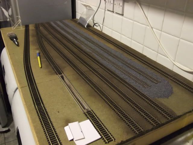

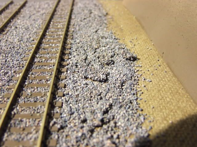

So the next job I want to tackle is a bit of ballasting. Now I have never done any ballasting before, so I am a bit nervous! Here is where I have got to so far:
How does this look? It looks ok to me, but I haven't really got a clue. Would I be best to put all of the loose ballast down on the tracks that need it, then apply the PVA / Water mix, or should I fix the couple of tracks that I have done and then move onto the next couple? Also, do I need to get every little piece of ballast off the sleepers before I add the PVA, or can these be removed later?
Any advice or comments would be very much appreckiated before I screw it up! lol

To my definitely non-expert eye it looks good! Perhaps the end faces of the sleepers towarsd the bottom right of the second photo could be a bit more "buried"? From what little ballasting I've done, I think that any stray bits left on the sleepers are easily chipped off.
Better wait for an expoert, though!

I like the overall look of that ballasting - very tidy and not all over sleepers.
Quality work in my opinion. I suppose my only comment would be that your
grain size is at the upper end - I try now to use fine ballast (commercial 'N' standard).
Fine ballast has it's problems being much slower to lay and so light that the 'Avon'
mist spray bottle can move grains around as you dampen off before PVAing.
That is of course no criticism of what you've done which is first class.
Hope the second application went as well ....

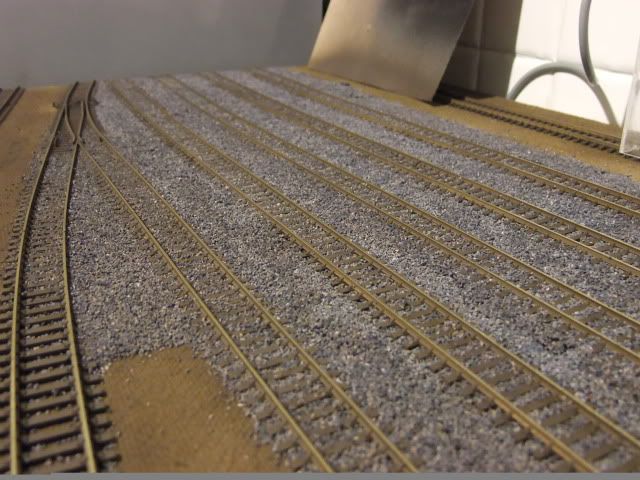

Got home tonight and inspected the ballasting and found mixed results. Overall I am very happy with the results and although a little clearing of stray pieces is required, it looks quite good to me.
The down side is some areas have not glued at all, probably due to the first batch of PVA not mixing correctly as it had lumps in it. Other areas have cracked and not stuck down to the baseboard. Again I probably expect this to be a mix problem.
Anyway, tonight I plan to break up the areas that have cracked (they can easily be picked off and recrumbled into ballast) and will give the whole layout a new coating of PVA / water mix (hopefully without lumps!)

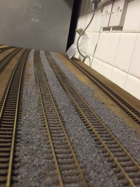

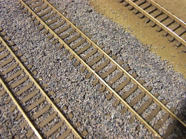

Some good news. The 2nd application of PVA/water seems to have done the trick. No lumps this time and everything has stuck down fairly well. Still the odd crack here and there but nothing too obvious. A few more areas to finish off and I still need to ballast the point, but I am really pleased with my first effort.
Now I just need to decide what's next. Maybe the concrete areas I think.
Thanks for the support everyone
