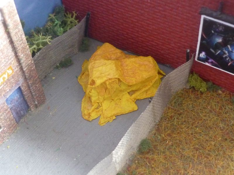

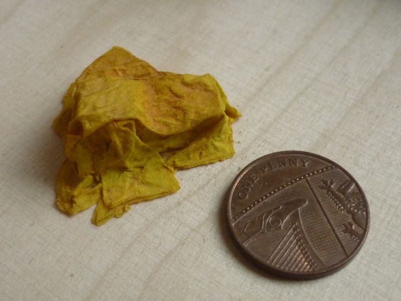

I added some goods under a tarp to the Sainbury's yard. It was made from three bits of wood glued together which were covered with tissue soaked in diluted PVA. After that had been dry it was painted in yellow and later dirtied up with diluted acrylics.
and in situ:

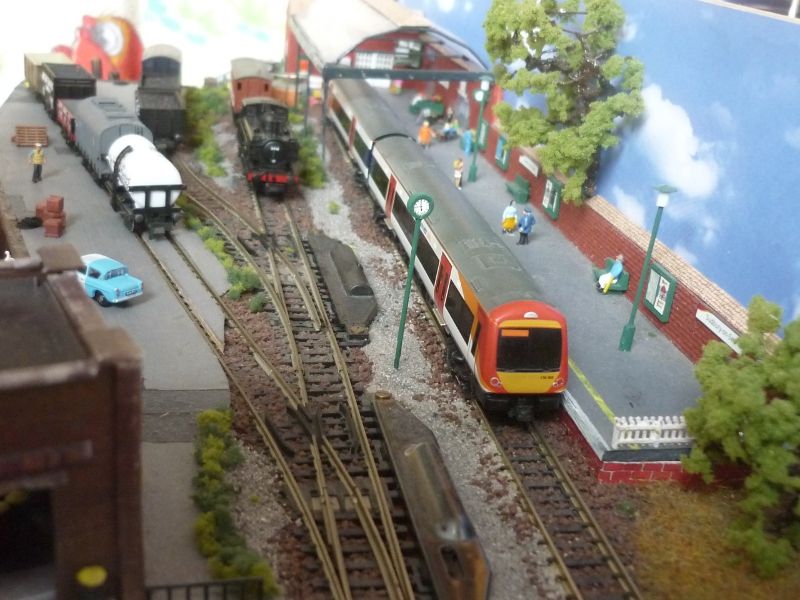

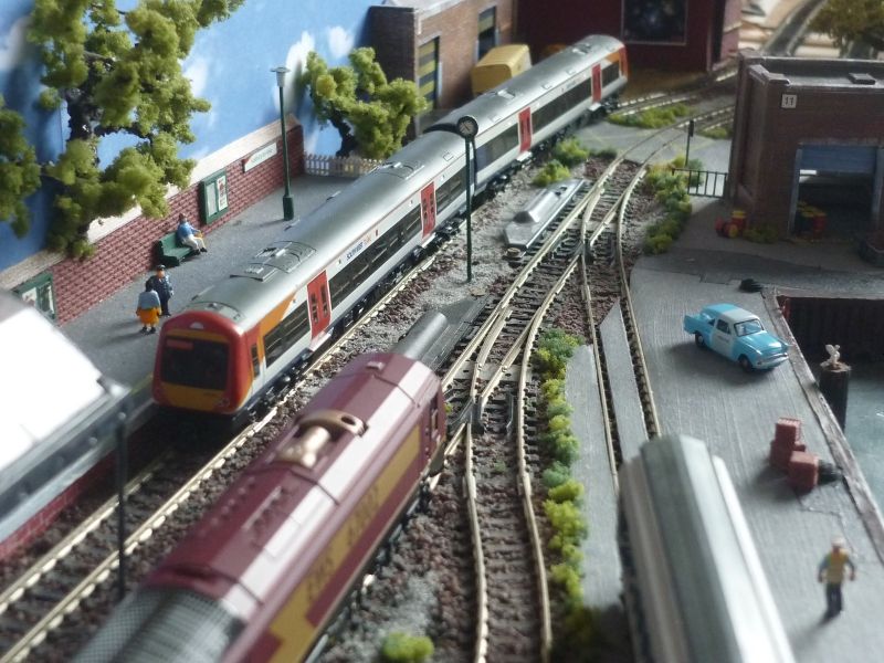

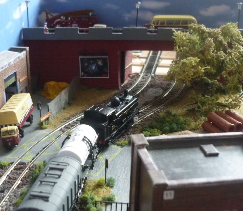

Pictures from the running session:
Pannier with a mixed freight departing Sudbury-on-Sea:
SWT 170 arriving with the 14:35 from Waterloo:

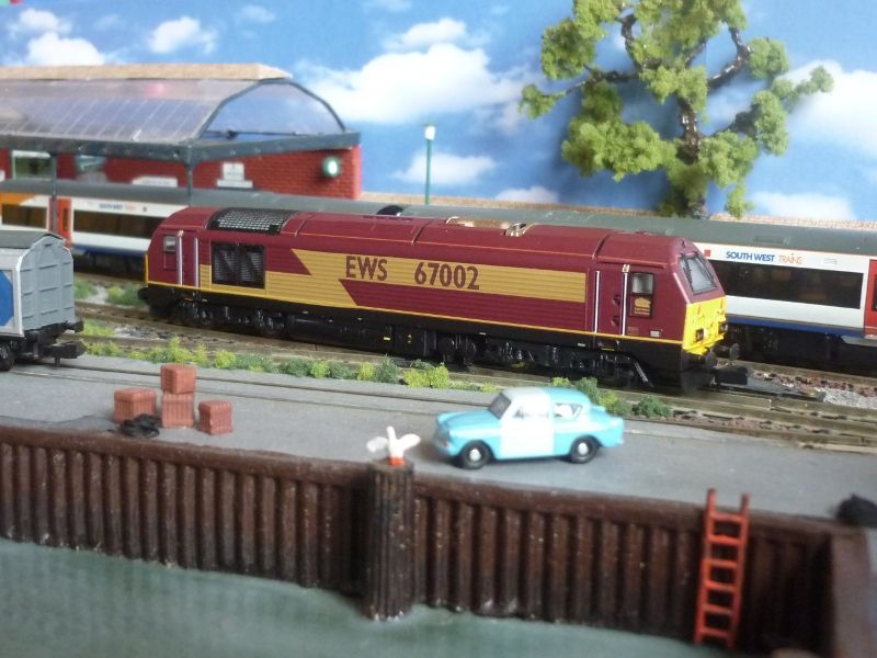

67002 shunting at Sudbury harbour:
SWT 170 with the 17:03 for Salisbury:

Waiting at the platform:
And on a short mixed freight in the harbour:
