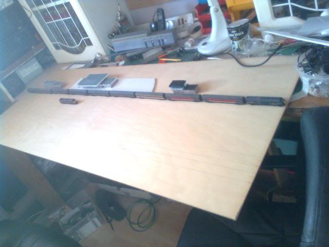

Another westcoast miniatures baseboard job has provided me with the opitunity of progressing with the AC lines project. The next new module is being built as part of a magazine artical that I will be writing on how to model the WCML. The new section mesures 5' x 2' and will be built to the AC lines spec. At the moment the new section consists of a sheet of 6mm ply but it allows me to visulise how the module will look. So to give you an idea of the size available heres a few pics. First up a few with some N gauge stock on as I had a crazy idea of rebuilding potters in N !
The HST is an 8 coach rake...

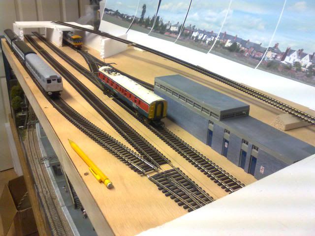

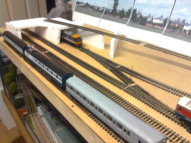

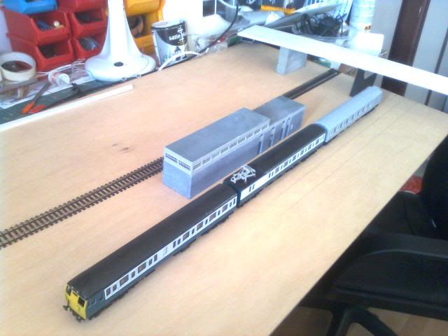

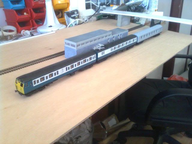

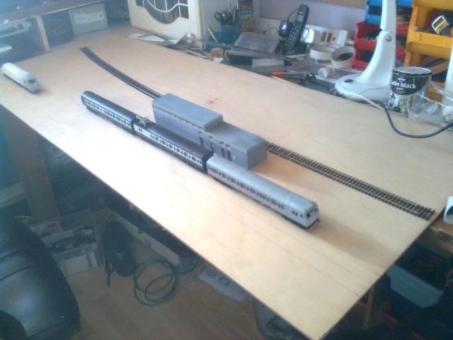

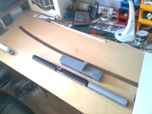

Ok the idea for the next section is a feeder station with a WCML relay room. For the mock up I have used the existing 00 gauge demo building but for the layout a slightly smaller one will be built.
A road bridge will be built at each end. One end will be done using concrete porthole sections. These will be cast in resin and will eventualy be available from the westcoast website. The other bridge will be a rebuilt arch. At one end there will be an access road down to the relay room that will be situated between the tracks. The double track mainline will pass across the front whilst the single line at the rear will split away. This line will link up with the headshunt behind the signal box on potters and will give us the opitunity to run stock in and out of the depot at shows independently of the main lines.

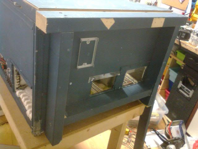

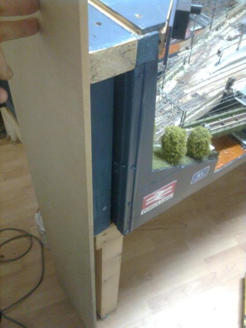

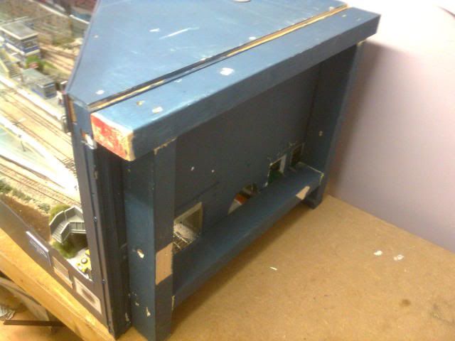

Work on the first phase of the AC lines project has started with the conversioin of Potters Lane from a YMR module to an AC lines one. As Potters is a self contained box unit I have decided to do away with the old support frame. Instead I have fitted extensions to the layout that will allow the legs to bolt directly to the module. This will elimanate having to transport a seperate frame and should make setting up easer. This is the left hand side...
And this is the right...
The legs will fit into recesses at each end...
The end extensions will also allow the track to secured better and should elimanate some of the problems we have had at shows by removing the point work from the edge of the layout...

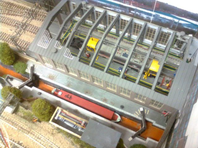

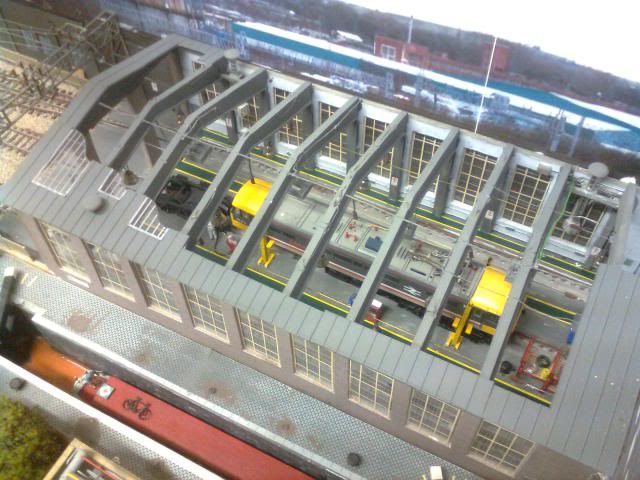

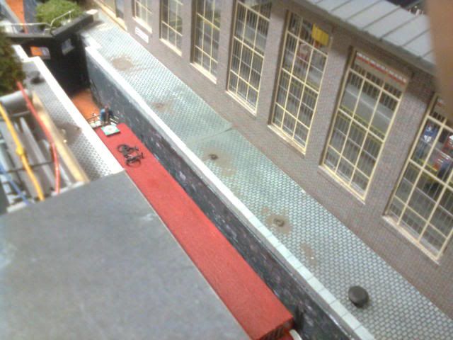

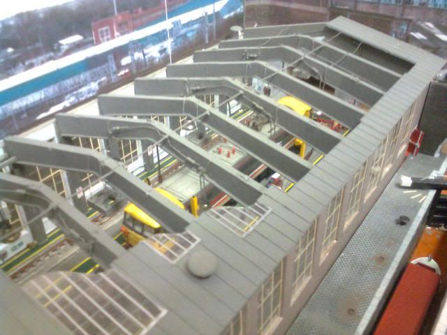

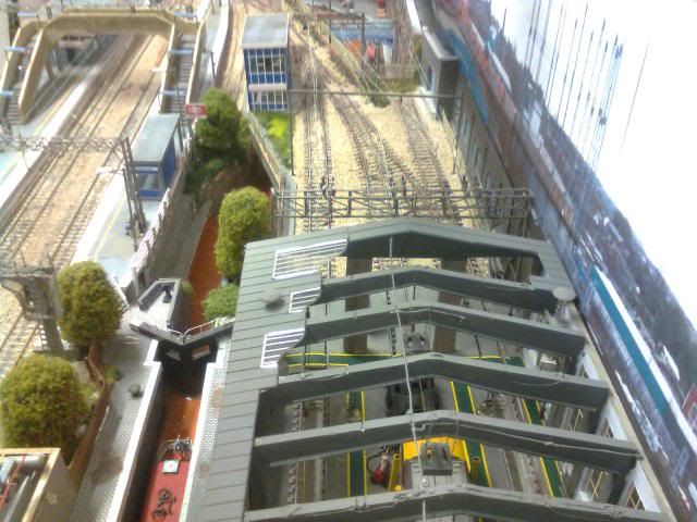

There is still a plywood panel to fit at each end. This will have holes drilled and captive nuts fitted so that the fiddle yards and additional modules can be bolted on. I will be making a metal template for the end panels so that they are all made the same. Whilst the top of the layout was off I took a few pics of the shed..

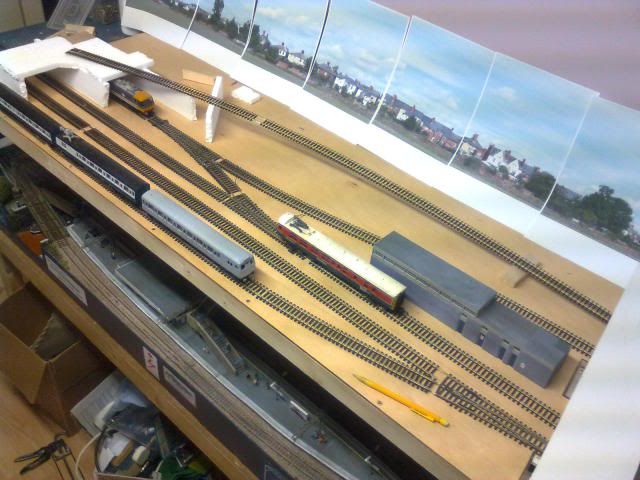

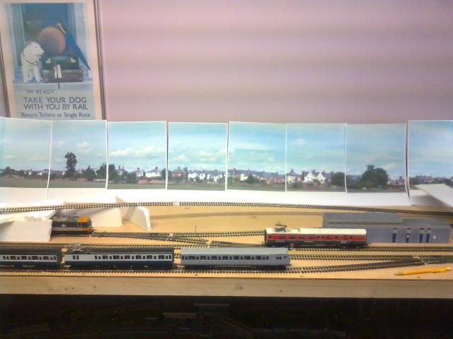

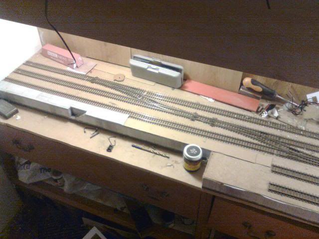

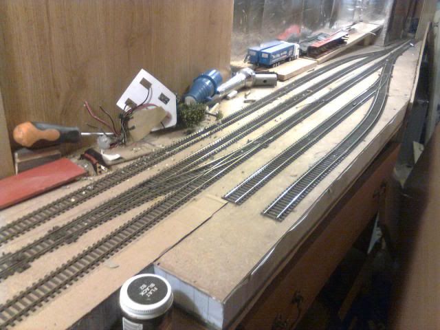

Some of you will remember the Albert Dock branch on the Heatherburn railway. This never realy got past the track laying stage as I started building Potters lane about the same time. With the new AC lines project I need some track so it was time to make a dicission about the branch.

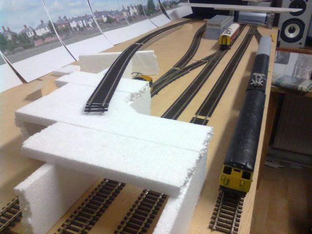

So tonight all the track has been lifted so that it can be reused on the current project. A plus point on loosing the branch is that I have gained a shelf so that I can get some of the junk off the garage floor ! Ok here is my current idea for the new section. At the front of the board will be a turn back siding. This will allow EMU's to stable before working back via the crossover on potters. The two track main line will run through the middle whilst the line from the depot headshunt will swing in behind the relay room before dissapearing under the flyover. A crossover will also connect this track to the main line. At the back I will attempt to build a flyover in the style of Rugby. This will be a challenge as there isn't enough room to fit the incline in properly so it's just as well that it will just be cosmetic !!
One idea is to fit a shuttle unit to the depot line so that a light loco can move between the depot and the flyover maintaining intrest for the viewer. The backscene is another that I have stored on the PC although with the new change of plan I may have to change the backscene.

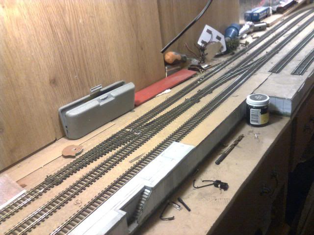

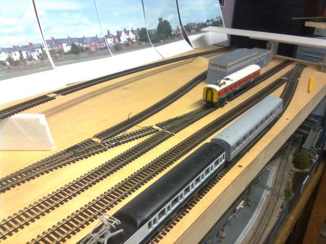

Thanks guys well last night I cut the rest of the 2"x1" baseboard frame and then screwed and glued it to the 6mm ply sheet. Now that I have a soild base to work with I can start marking out all the track and then make a start on the concrete flyover. Poped over to B&Q this morning and priced up the timber and T nuts for the new legs for potters so I might get these tomorrow. Last night I mesured all the boards and the living room / dining room and discovered that I can put all four sections together with about 4" to spare !!
