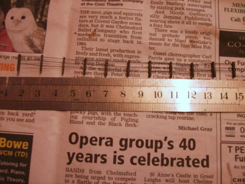

A section of fencing was inspired by the wire fencing on Pauls' Welton layout. When I said "That looked fiddly to do" & he said "he wouldn't like to try it in n-gauge"........ The words red flag & bull somes to mind :D

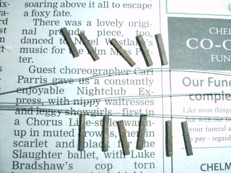

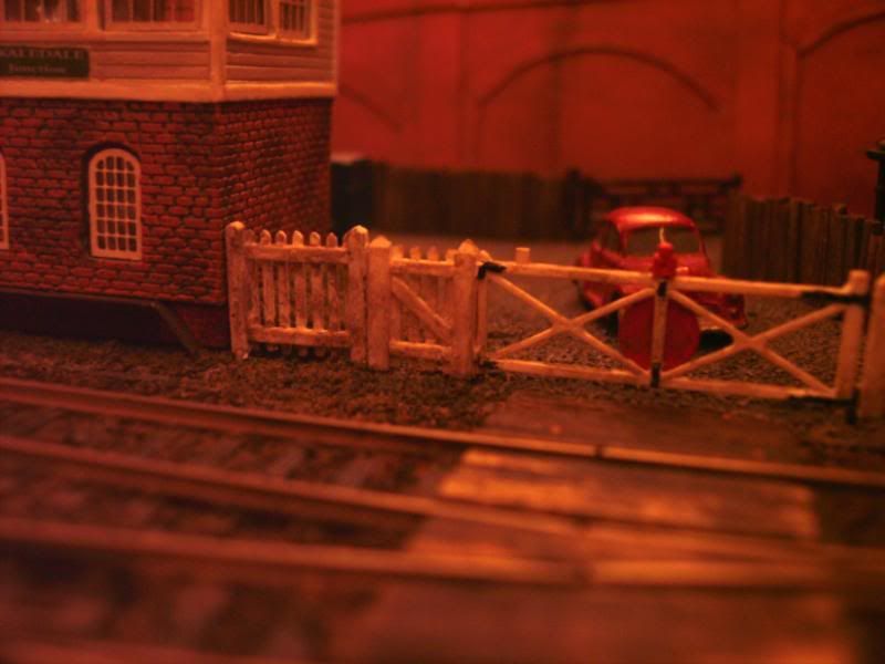

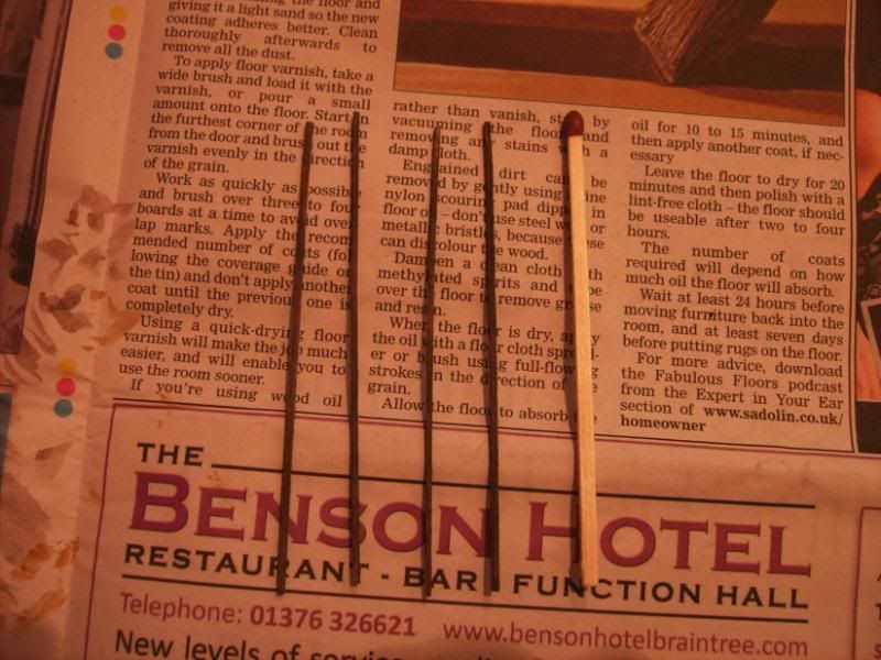

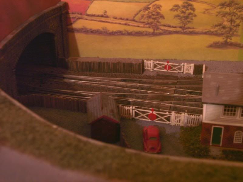

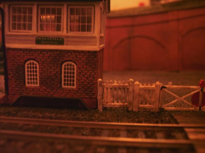

1st of all I added a single gate rail crossing for access from the yard to the otherside & fencing made from large match sticks cut length ways in quarters, filed to shape, painted & cut to length ~9mm.
photo prior to yard completed.
Grass & weeds to be added at base of fencing, as do the arch retaining walls also require too.

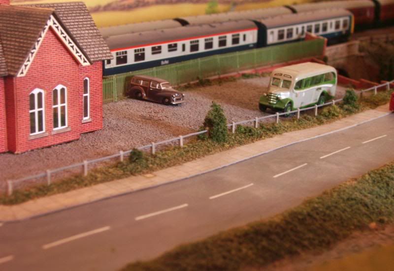

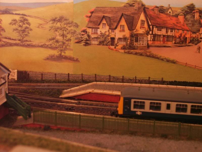

Fencing for car park, made from single core wire & plasticard rod & brick wall at side of carpark.
This was the fiddly bit 3wire fence from crossing to loading platfrom. Only short section ~14cm but took a No of hrs to make. Mmmm shall I really do the other 37cm on the other side of the platform like this? :? :lol:
Wire & fence posts painted up.

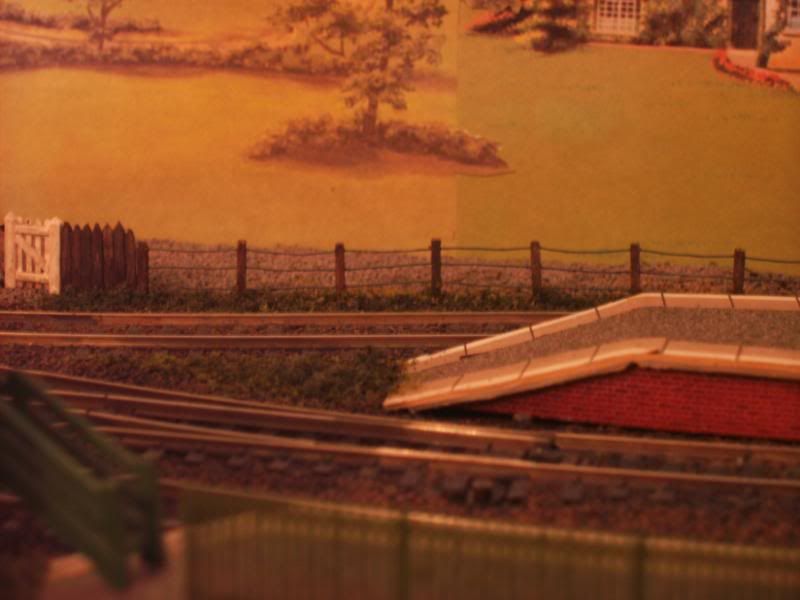

Completed section
Close up
Wire fence in implanted

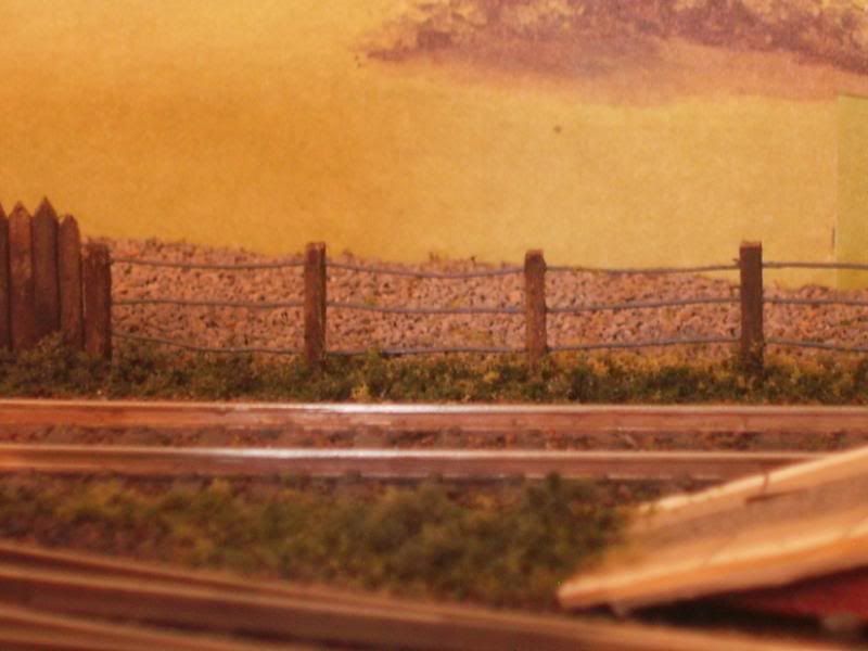

Couple of close ups

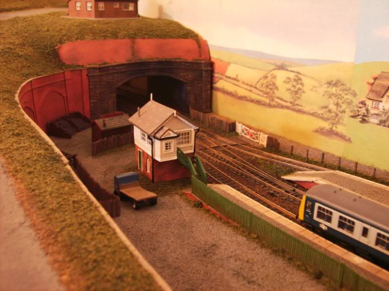

Overall view of yard area. Grass & weeds added at base of fences. But still need to add detailing, coal staiths, oil drums etc.

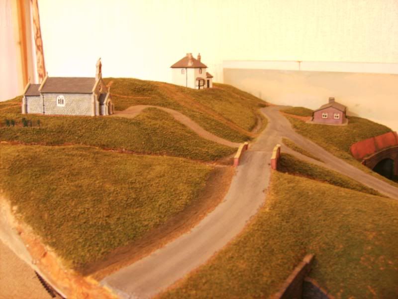

Greened up remaining scenary. Plenty more required, fences, bushes, trees, ivy on bridge etc

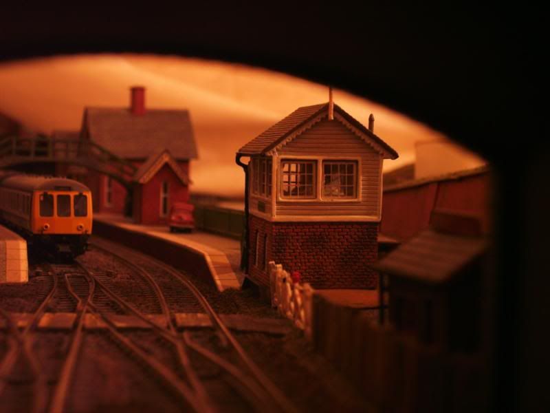

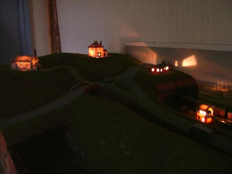

And added a few lights.... They a bit bright though 8) 8) 8) Need to reduce the voltage, the resin cast models leak like mad.

This is a really excellent layout Steve! I especially like the hills with the houses and the hydraulic buffer stops. This promises to be one of the nicest N gauge layouts on the forum together with Frankland by SouthernBoy.

This layout is looking fantastic! I like the rural scene on the hill, it really gives a sense of the layout being 'somewhere'

Hi there... Just been looking at your last update.. Loving the attention to detail pal.. Very nice indeed. Even better considering its all in 'N'. And yup those resin buildings dont half bleed light.. First stop for me is always black acrylic paint slathered over the inside, works a treat everytime...

Yup, would second the black paint tip (or black insulation tape).
Superb work on the scenics. The photos are really atmospheric. The wire fence is a fiddly job (I should know!) but definitely worth the time & effort. It is surprising how everyday items can be used to great effect as demonstrated here.

Thanks for your kind comments Jas & Chris & the tip about using black acrylic paint, I'll definitely be trying that one. :D :D
Was also thinking of adding a resistor in the circuit to tone done the brightness. Not sure if it needs to be placed in the + or - side of the curcuit. Better do a bit of googling. Otherwise if I get it wrong I think it'll increase the voltage :o :lol: :lol:

on the + side if I remember correctly, otherwise on the - side :lol:
