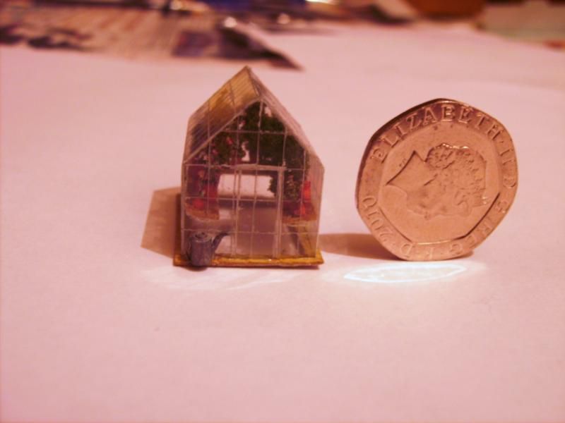

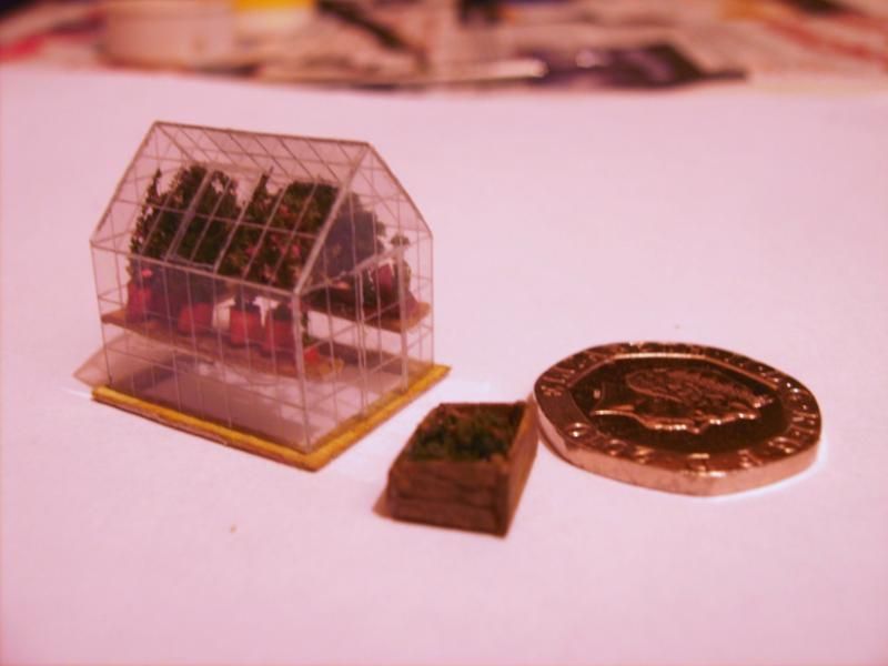

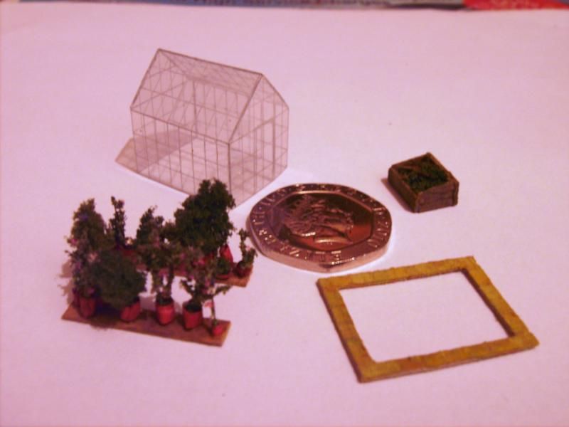

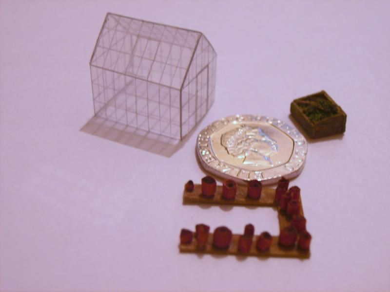

1st is a greenhouse I made from plastic sheeting (this the window of an old metcalfe pack). A compost heap made from a cut & whittled down match stick, compost slithers of painted match stick & various flock. The shelving for green house from cereal cardboard & plant pots from rolled prepainted strips of paper. Scale size 10 x 8ft, actual size 20 x 16mm & 20mm high at top of apex.
The green house was made from one peice of plastic, from a drawn template. This made it a lot easier to assemble. The window frames where made by aligning & scoring the sheet over the drawn template. Painting the surface with dilute acrylic & wiping away the excess. Though with this process, if you dont leave it on long enough, you wipe all of it off. Or too long it part dries on the panes & you spend ages scrapping off the excess. I made both mistakes :lol: :lol: :lol:
Add flowers and make base from cardboard for green house to stand on.
Assemble.

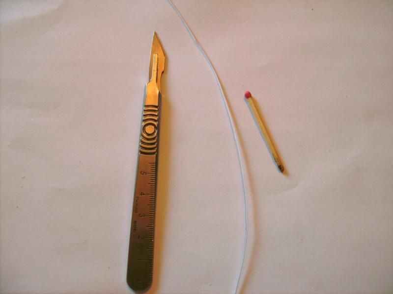

And add watering can. Made from a strip of prepainted A4 paper. The top of can was created by controlling how the paper is rolled. Handle is a slither of paper glued on. And spout, is paper rolled & formed to shape.

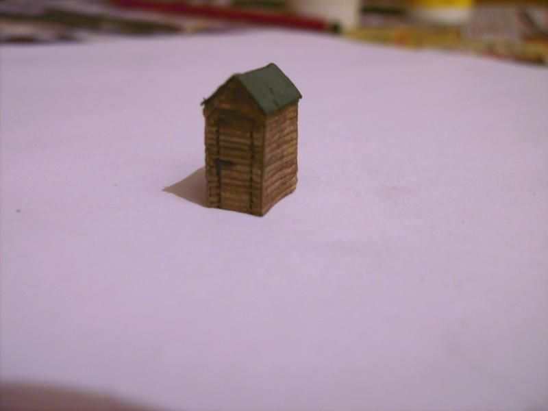

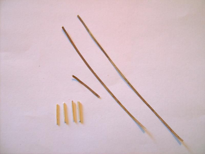

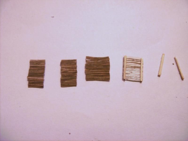

For my next item take 4 strips of 1mm wide paper cut from the side of a sheet of A4 paper (just 1 shown here) & 1 match stick.
Do you now what it is yet? (note Aussie accent :lol: :lol: :lol: )
Chop match stick into posts of approx 0.6mm square & 12mm long. Paint paper in rough mixes of acrylic & water colour.
Cut strips into approx lengths of 7.5mm & 11.5mm & overlay them to up to 15mm high. Repaint the backs with PVA, this'll add strength to them.
When dry square off into 2 lots of 6 x 15 and 10 x 12 sheets. Add your posts to just inside of the 2 10mm long sheets.
So is it a fence or something else?
Cut a 3mm apex to each of the 6 x 12mm sheets & add 0.5mm wide strips to inside of apexes.
And start to assemble.
Add a roof and you have a garden shed.

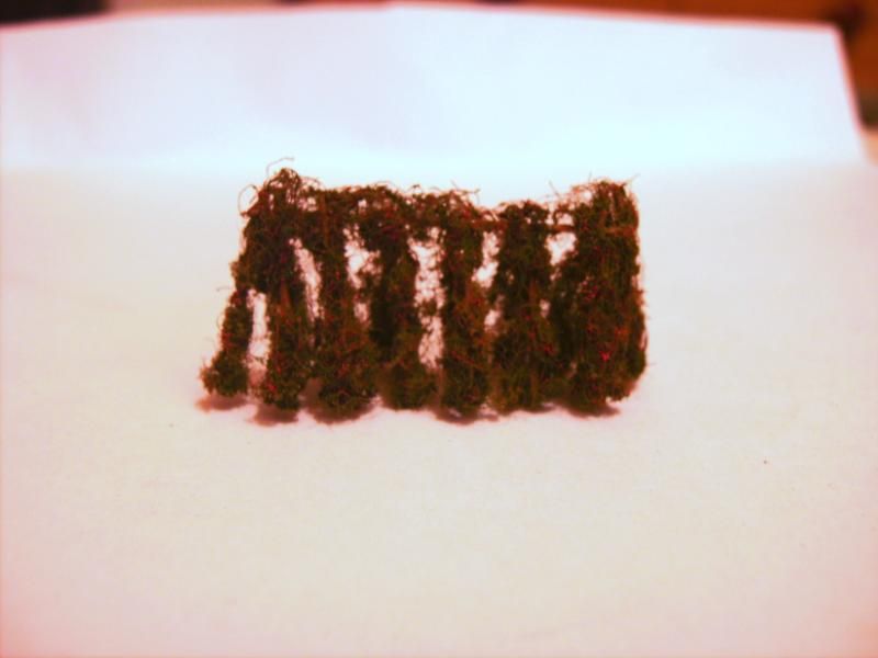

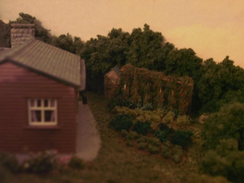

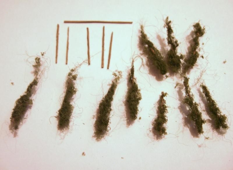

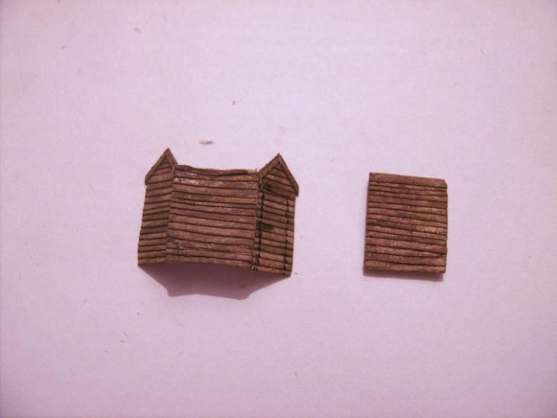

Next chop a couple of match sticks into 14 off approx 0.6 x 18mm, paint light brown & twist some woodland scenics fibre foliage around them. Also make stick of 0.7 x 32mm with no foliage.
Any ideas?
Assemble wigwam style & trim legs so they'll sit on you prepared area. Trim off excess foliage & twist some excess strands or add to support bar.
I repainted with acrylics to darken the foliage & flicked & added some red paint for flowers.
And you have a rack of runner bean plants.

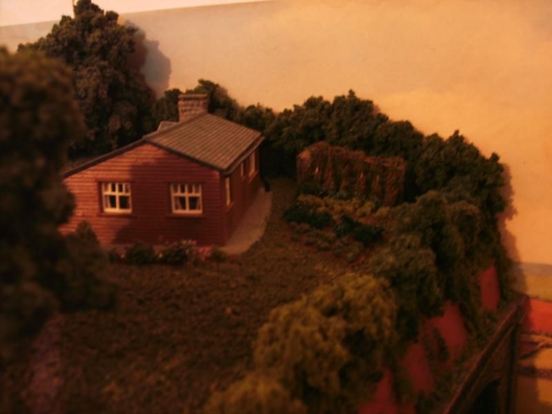

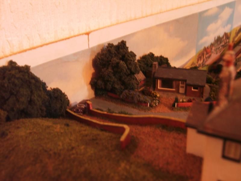

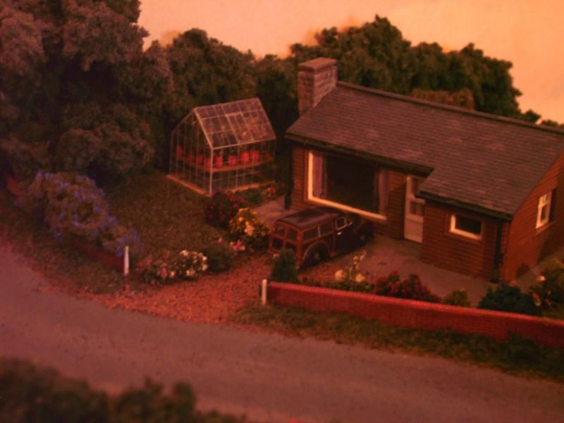

I added these items to the bungalow garden, which I had readied prior to the scratch built items. Hedges, couple of trees, walled garden with flowering shrubs & a vegatable garden. Vegatables made from bits of foliage & lichen to represent cabbages, brocolli etc.
Oops need to add a washing line :shock:
Looks like Mr Hodgson is in.

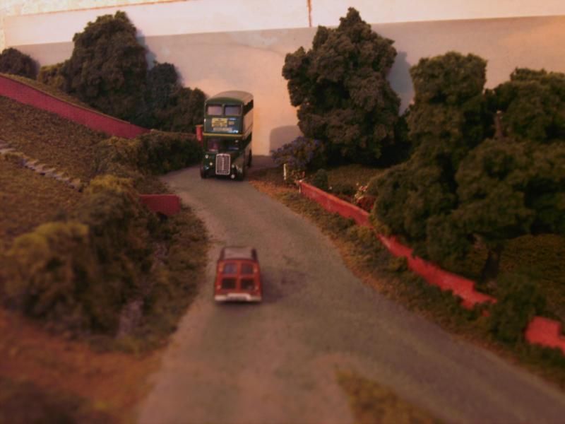

View up the road. Still plenty to do around the house opposite. Am please with how the ditch feature is comin along.
Mr Hodgson visits his neighbour. Cos of a dodgy knee he decides to drive :D

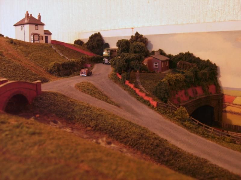

The views from further back & station, shows there's plenty more to do.
Not to happy with appearance of the brick work above the tunnel mouth, think it needs more weathering.

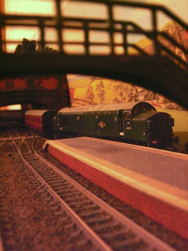

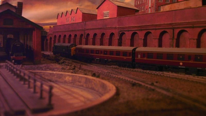

So here's a few photos;
Class37 D6707 pulls into the branch line station
Class37238 leave Rayne St platform 1, while the City of Hereford sits in the engine shed.
92018 leaves the goods yard with a rake of wagons
Class108 sitting at the buffers at platform 7
Thats all for now. Comments, questions & criticisms are always welcome.

that's very impressive :shock: . That garden looks brilliant and the use of every-day material for your scratch-building is absolutely inspiring. Particularly, I like the watering can.
One question concerning the greenhouse (which, by the way, is very neat work). I tried that scoring-painting-wiping technique too but it didn't really work. I think, I'll have to give it another go, now that you've shown that it can be done :lol: . You said you used diluted acrylics. May I ask what the ratio was?

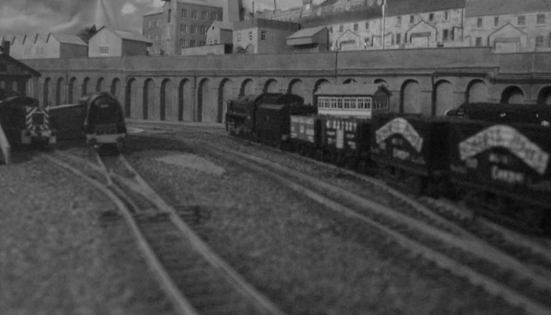

Well I've been back and read-through from the start - I can't believe it's only two years ago you started this layout - you must be really pleased with how much you've achieved in such a short time!
And I've a special request ... I'd love to see a few pictures taken from the operator's perspective - it will be interesting for instance to see how the view below compares to an overview of the same scene now :)
