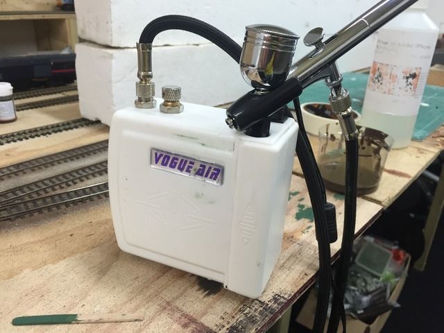

I have wanted to try an airbrush for a while but was put off by the cost of the equipment. So, I thought I'd look on eBay and see what was what. I found a compressor and airbrush set for £20 from China. I ordered one with the intention of trying it on some track that I had started to ballast. I wasn't expecting much. It did, however, arrive promptly and I set to opening the box and rigging it up. I mixed my paint (rail match sleeper grime) and nervously pulled on the stick for paint. I tried on some scrap ply first and was surprised at how easy it was. The airbrush is easy to hold and operate. Press down for air and pull back for paint. I was amazed at how easily I could regulate the flow and coverage. Photos below show the airbrush set and some weathered track (photo doesn't do the track justice at all I'm afraid).

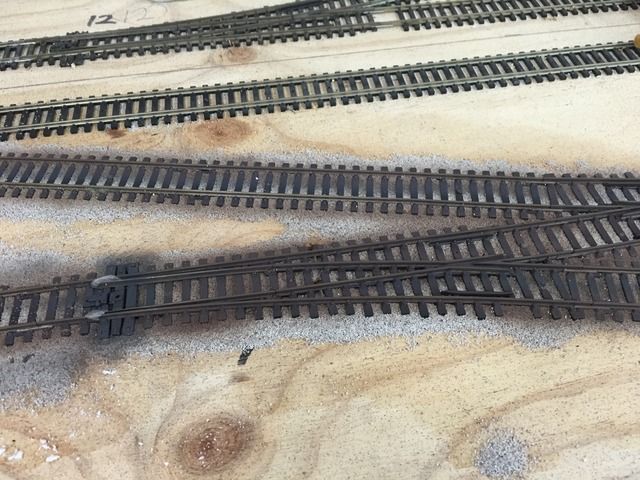

As I mentioned above, I have started ballasting. I really like doing this. I have my own little way of doing it. It suits me and I seem to get fairly good results. The weathering is only making me more determined to get ballast done so I can make it all look dirty!! Good incentive eh?!

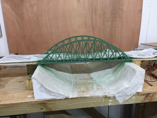

My girder bridge sides are 3mm MDF from somebody on eBay. I have had them installed in their bare state for a while now. So I thought it was time for some paint. I fired up the airbrush and thinned some dark green Humbrol that i had left over from my Faller tractor fertiliser spreader (more on that later). It went on well but I think it may need another couple of coats. Then I can set about weathering it. I have also started to landscape this area ready for a river scene.

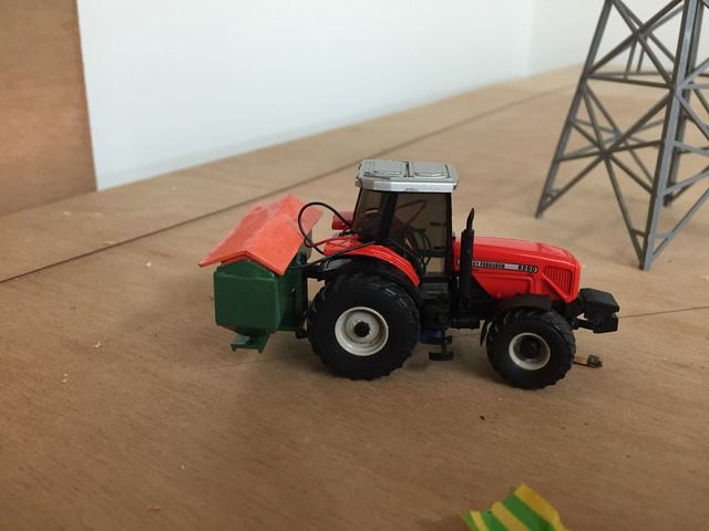

I am now getting to be quite pleased with the fertiliser spreader I have made for my Faller tractor. It is still a little rough round the edges but I'm happy so far. The tractor runs fine having halved the battery pack from two to one. This is now housed in the spreaders body. Pictures show a (not fully assembled) tractor and spreader and the mock up of the field the tractor will drive to and work in.

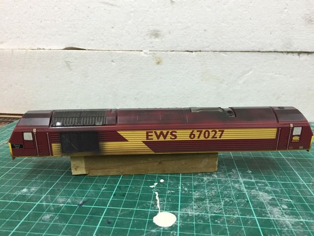

Finally for this update. I have made my first attempt at weathering a loco. This airbrush thing is addictive!! I separated the wheels and bogie frames. These have been done separately. Chassis is detached from the body. I have used sleeper grime around the chassis and bogies and roof dirt for the roof and grills. I need to mix some black to go around the exhausts next time I'm in there and after this first lot drys.

Not much progress on the layout as I'm waiting for more ballast to arrive. So I have been getting on with my first ever loco weathering project. Pictures are below. I am quite pleased with it. It's not the best model in the world but it does run well. I am planning a lighting upgrade as it only has front lights. They are directional but no reds on the back look odd. I also added a driver. The cab is short of detail too. So maybe something else I can tackle at a later date.
I tried to be subtle. I didn't want to over do it. I made the sides grubby with a wash. My thinking was, that in service, this loco will see a train wash occasionally.
Anyway, let me know what you think and I am open to constructive criticism

I really like the grubby wash. I think the underframe detailing works very well indeed. However, I'm less convinced by the blackening around the body grills - I can't find a single picture online of any real 67 where the body - rather than just the grill - has been soot-stained... I'm open to correction, but I think you make need to remove the black paint from the maroon and gold...!

Hi Black Marlin,
Ah yes, I see what you mean. Shall I keep the dirt on the grille but not spill over onto the paint?

Hi Dan
Yes, I think that would look very well indeed :-)

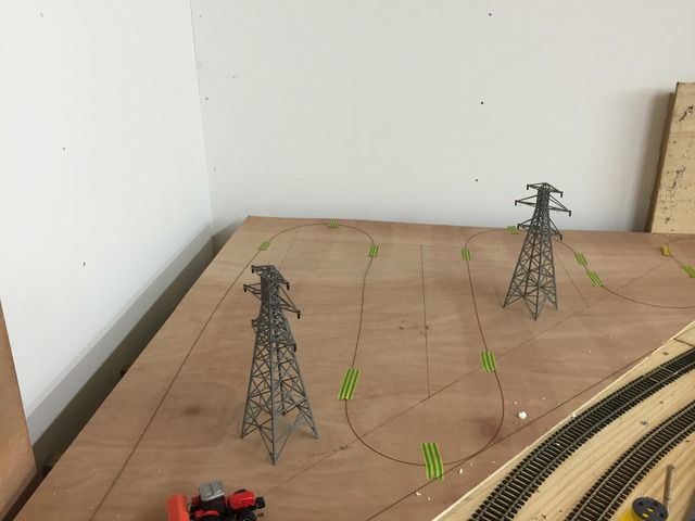

I realise it has been a while since my last update but I have been flat out busy on the layout. I have started a new town scene which will incorporate the faller car system. This has a track plan all of its own. I have also devised a method of using a point motor to direct cars with the faller system. It's basically a point motor with the pin knocked out and some guide wire bent to pivot in the road and the point motor. This is covered with thin plasticard And painted to blend in with the road. Much cheaper than the faller items that do the same thing.
I have mainly been hard at work wiring up the main station side of the layout. All point motors are working as of tonight and I am about half way through the control panel led wiring. When this is done I will have illuminated routes at a glance. It has been a bit of a faff but I think it's worth it.
Photos show: new town scene, faller car system vehicle collection and control panel

I wish I had discovered the Faller road system some time ago as I think it looks brilliant accompanying a model railway layout. I'm not sure it could be retro fitted without a lot of headache and upheaval. The space you have given over to your town scene deserves a system that allows movement of vehicular traffic. I don't think I've ever seen a roundabout modelled before either which is a nice touch.
Have you tried fitting the Faller motors in to Oxford Diecast vehicles? The gauge difference between HO and OO is sometimes glaringly obvious when it comes to the cars and van. There's a chap on YouTube who has done it quite successfully.

Thanks for the reply Paul.
Roundabouts are everywhere so I thought: "why not". Both roundabouts incorporate my 'points' for traffic control. It works really well. Especially when the tanker is snaking round them.
All I did for roads was: superglue the guide wire to the baseboard. Then used the woodland scenics road tape and plaster. This isn't very thick after sanding and seems to work well with the vehicles.
Also, I have made the decision to go all HO road traffic. This is due to commercially available faller cars. Any other vehicles I add or convert will be HO to match.
