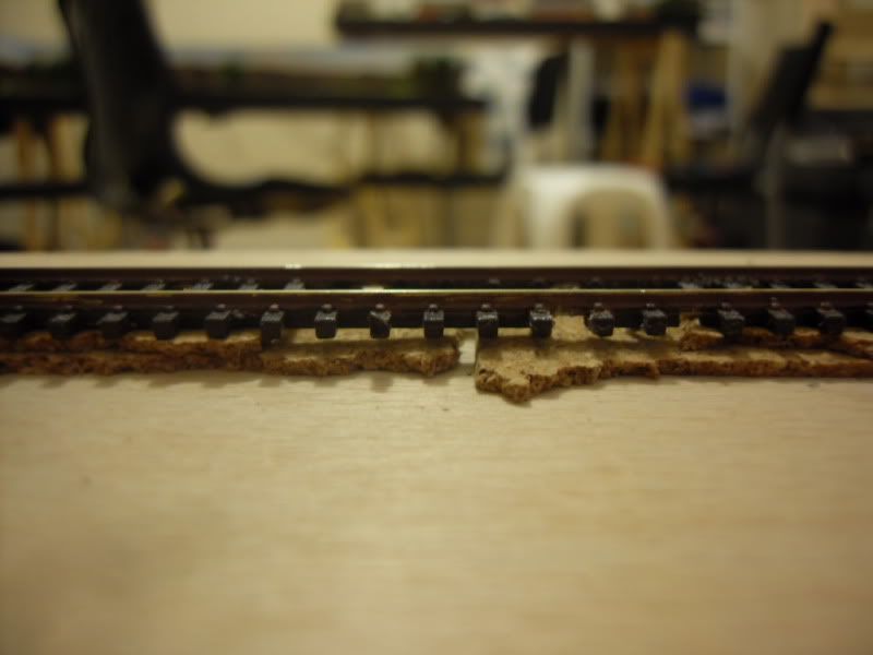

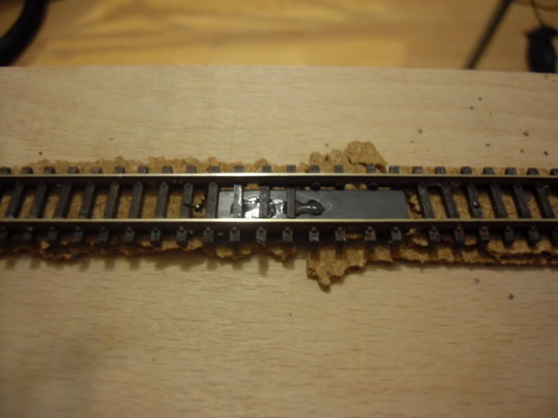

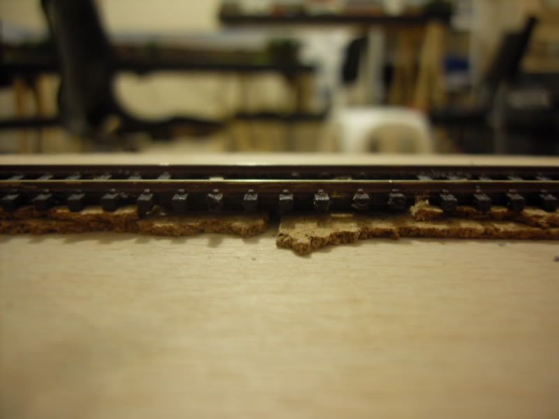

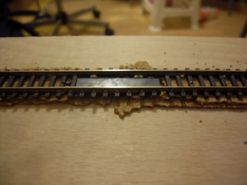

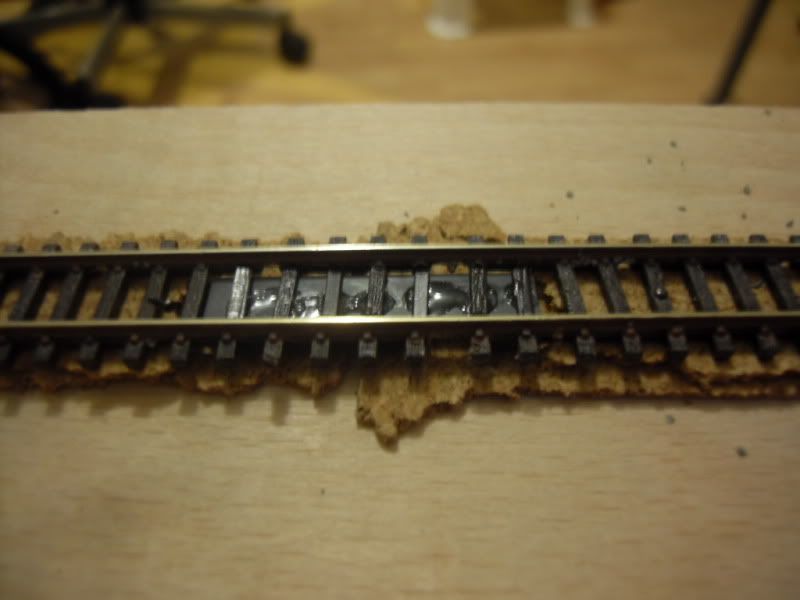

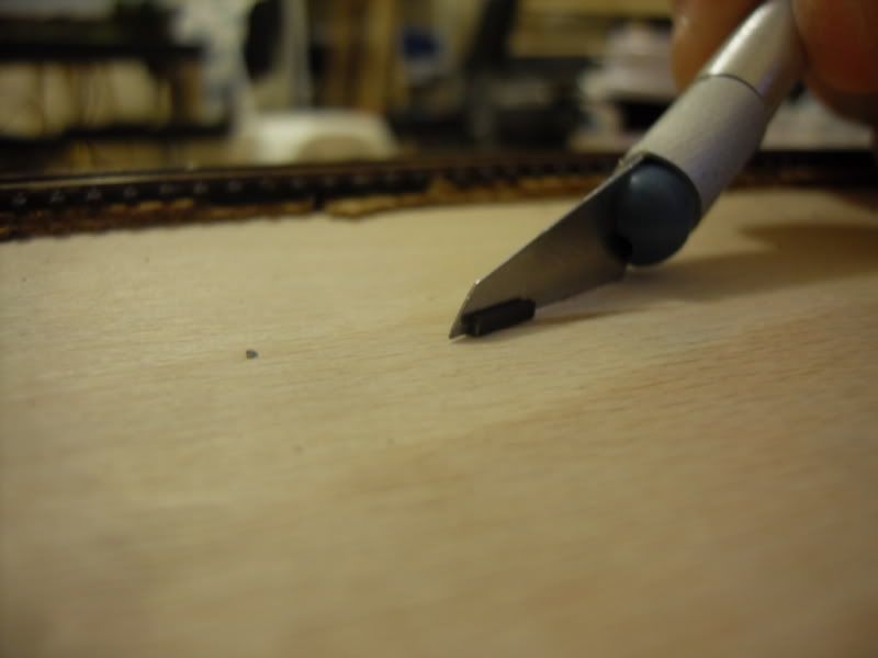

As i'm sure you are aware Dapol have recently released their magnetic couplings and magnets. They work very well indeed but the one problem i had was that in order to fit them you have to cut out sleepers between the track and you are left with a rather ugly magnet in the middle of your track.
I didn't want this on my layout so i've come up with a way to 'hide' them from view. I first tried putting the magnet under the track but i found that the uncoupling wasn't 100% reliable but i have found a way :D
I realised that under the sleepers wasn't high enough so what i did was lay a test piece on two pieces of 1/16th cork to give the height of 1/8th. I then did the usual of cutting the gap inbetween the sleepers but i also cut the gap out of the top layer of cork.
I did this so when the magnet was added it sat lower than the tops of the sleepers.
I then took the sleepers that i had cut out to fit the magnet and slices them in half lengthways.
Then i took the 'half-slices' and glued them on top of the magnet lining up with the sleeper edges.

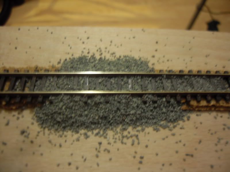

Once ballast is added it is very had to determine where the magnet is.
