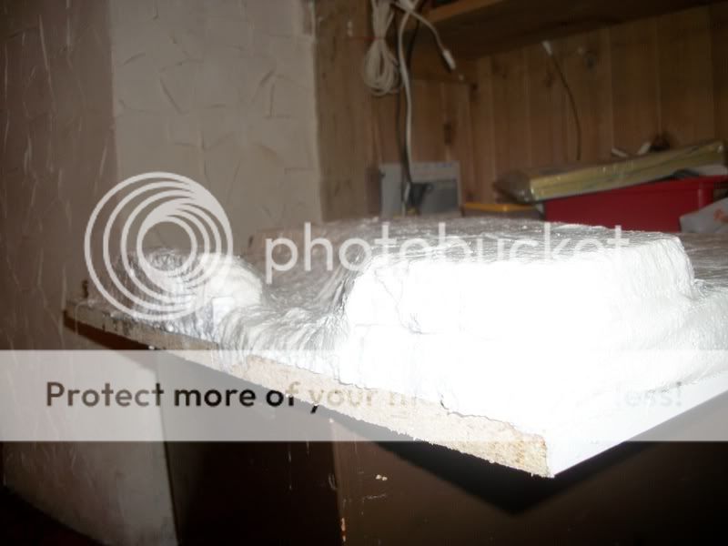

A couple of pictures of tonights progress, the whole diorama/scene has been covered in plaster cloth. This is due a coat of plaster of paris hopefully tommorrow. Then paint, scatter, track etc etc.
By the way, does anyone know of a fairly cheap way of creating a river? I've got a decently big river to make. Was thinking about pva, but it seems to go cloudy after a while. Advice please
Looking down the river.
Overall view of the thing. The river is the whole cutting to the left of the railway bank.
Stew.

You could ask Charlie DimmockStewart Gethin wrote:By the way, does anyone know of a fairly cheap way of creating a river? I've got a decently big river to make. Was thinking about pva, but it seems to go cloudy after a while. Advice please
I've seen plenty of water products around - no experience of them, in fact here's some I was looking at only this evening on my newfound Czech website, I am sure it's easier to locate things like this in the UK than it has been for me til I found this website - http://modeltrain.cz/products.php?kind=70401
I have had quite good results by using water clear resin I bought on ebay, much cheaper than all those artificial water products and much the same thing !!
http://cgi.ebay.co.uk/ws/eBayISAPI.dll? ... K:MEWAX:IT
This is the sort of thing I use. Well worth a try as 1 kg does a lot of water. Shrinkage is good too so not too much building up to do .

Does it come with instructions :O? Because for once, I would actually read them because I've never mixed that stuff up.m1racleman wrote:By the way, does anyone know of a fairly cheap way of creating a river? I've got a decently big river to make. Was thinking about pva, but it seems to go cloudy after a while. Advice please
Oh yeah, any chance of a photo of the water you've done?

That brings me to your enquiry about resin ....... I used that on the stream going under my embankment, see earlier in this thread.
It's good stuff BUT, the waterway needs to be fully painted as it's clear, you can add a touch of water based paint to give some look
of depth. It remains in a liquid form for around 16 - 20 hours and will creep through any 'holes' in your streams banks. As it stays liquid
it's self levelling which means you can't use on a falling waterway.
If you can find my Scottish diorama you'll see it used in the ford across agravel road - I'll add a link here if I locate quickly.
Glentruss Halt - see pages 6 & 7 http://www.newrailwaymodellers.co.uk/Fo ... &sk=t&sd=a
