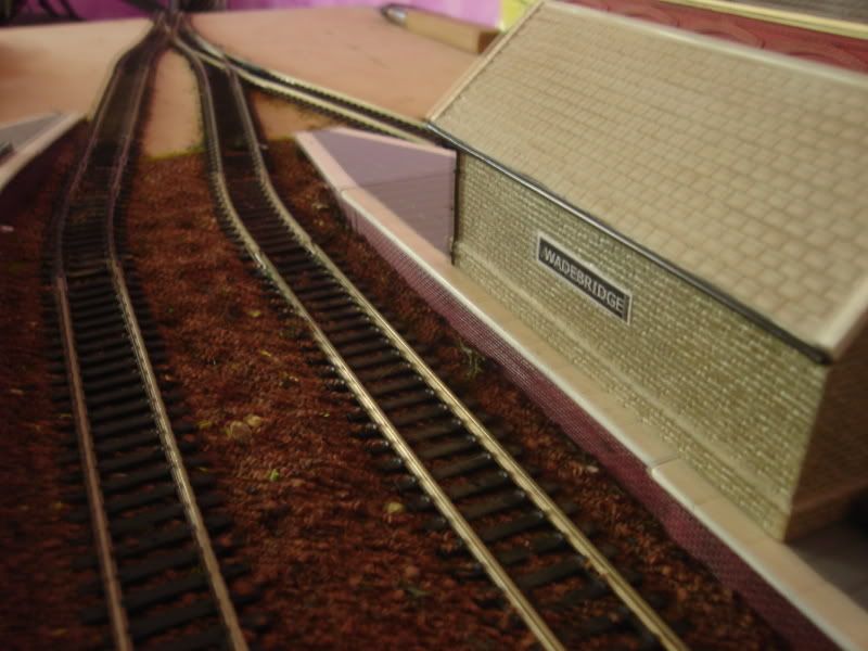

Just thought I'd keep you updated on the progress I've made on "Wadebridge", now that I've solved an earlier problem that I had.
You'll have to excuse the state of the track - Alot of it is over 20 years old.

The gap between the rails in the above picture does look a bit on the longish side.

sishades wrote:The gap between the rails in the above picture does look a bit on the longish side.
Perhaps a real hot summer is anticipated :)
I know what you mean.
Unfortunatley, if I tighten all the joins this happens. :(

A short piece of flex in there cut to length will fix that. Cut away two sleepers worth of chairs so you can slide the rail joiners right back on one end to be able to squeeze it into place then slide the joiners home. Bobs your mothers brother :wink:

Zunnan wrote:A short piece of flex in there cut to length will fix that. Cut away two sleepers worth of chairs so you can slide the rail joiners right back on one end to be able to squeeze it into place then slide the joiners home. Bobs your mothers brother :wink:
Never thought of that! :oops:
Thanks. 8)

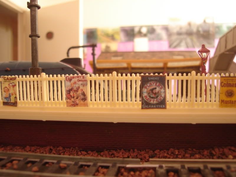

Also found a permanent home for my adverts too.

I meant to replace the two short setrack pieces with one longer piece of flex to fit the overall gap in the track. That way you also remove a number of track joins, which is always a good thing :wink:

Agree with that, better to replace the short and the even shorter section and saving you 2 fishplates too!!

Ah well, It'll do until I can eventually replace all the track. I've got pretty secure joins now at least. 8)

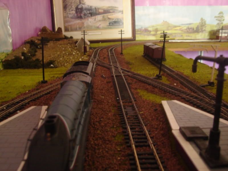

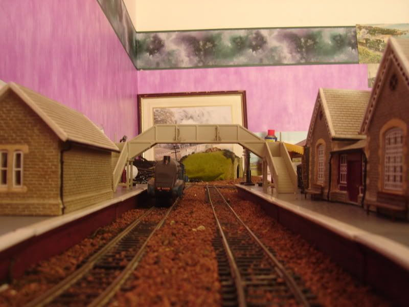

Did some more to it today, including a 4 foot extention of the board.
The single line, which will eventually find it's way to Grogley Halt

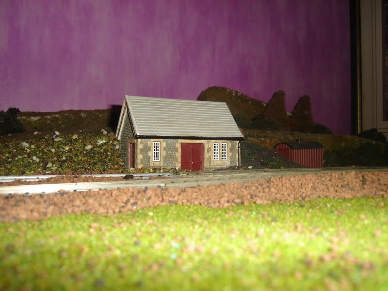

Also found a use for a spare Skaledale station building and a couple of pieces of platform fencing.
My 1975 Airfix Prarie waiting in a siding
The extention
And a new addition to the fleet stretches it's legs.
