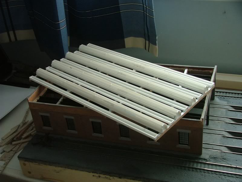

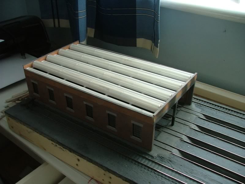

I made the drainage channels, glued them in place, then made the smoke ducts.
Each smoke duct is 16 pieces of styrene. I hoped I could make then as a clear duct but unfortunately they weren't solid enough so they had to have a base in them.
These pics show the ducts laid in place and also show that the whole roof will lift out to give access to any stalled locos, not that I intend having any hidden in the back.

Thought I'd better put in an update in case anyone thought I'd not been doing anything with the warm weather and footy.

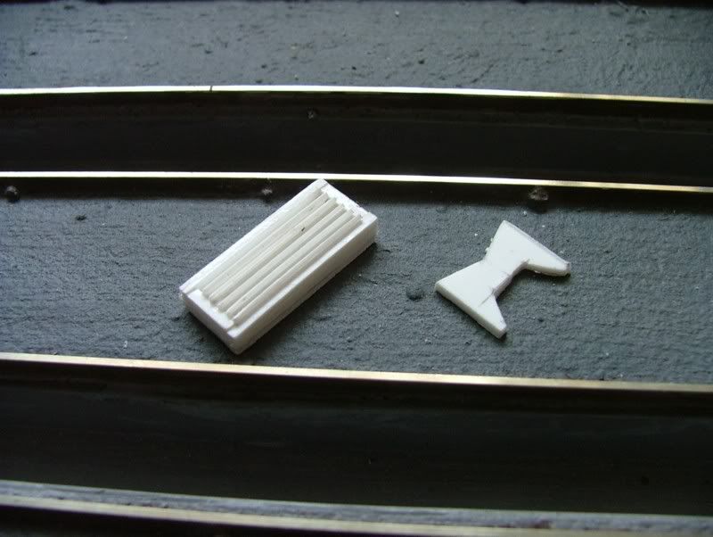

Spent about an hour this afternoon making a first attempt at a louvre panel, although having made one the next should be quicker -
Took a pic of it between a pair of roads before I cleaned it up to show the size. I'm not optimistic of being able to mould these so I may be setting out on making 48 of them - I may be gone some time.
Mac

Just in case anyone is interested in how I'm building the louvre units (chorus of boring!!) I'm loading a few pics to show it.
Slight change since I loaded the first pic - I decided they needed to be wider and to include the vertical frame in the middle.
I start with a piece of 0.5mm styrene, 5mm wider all round than the unit, fit 0.5mm guides round 3 sides and add the bottom, side and middle frames of 1.5mm x 2mm strip. At the moment I'm cutting strip from sheet but I think I'll soon get fed up with that and raid our local model shop who claim to have it in stock. In the third pic you can just see a length of 0.5mm rod in the bottom. This gives me the angle I want on the slats.
I then start building up alternate 0.5mm x 2.5mm slats (5) and 0.5mm x 1.5mm spacers (4) to fill the frame, then add the top of the frame. All the fixing is done with Mek-Pak as, in this job, it's so easy just to apply with a paint brush. You have to be very careful with something like a wagon kit not to get any on the outside surface as it will melt it and ruin the finish but in this case as these represent concrete and wooden frames which have been out in the elements for years it shouldn't make any difference, especially as it will be weathered. At this point I usually allow half an hour to let everything finish drying then trim off the guides.
