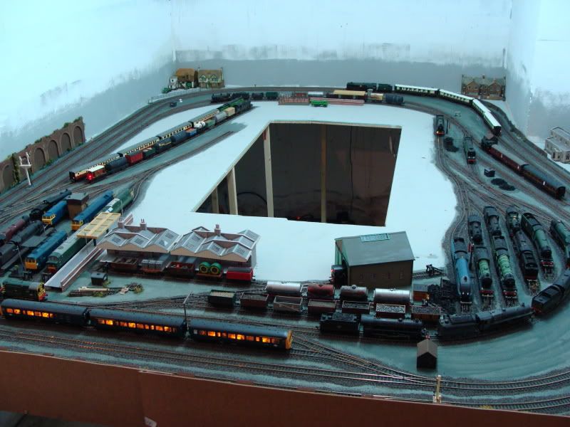

Well what can I say........I've moved location again......dear god! It wasn't really working out in my sons spare room so I'm back in the dingy basement with the blessing of the President......I think I've truly moved this layout for the last time.....
All will be revealed tomorrow.......but here's a taster.....
It is the same layout plan just shortened and I had to move the loco sidings as there just wasn't enough room, the layout is also flat without the inverted figure of 8 that I wanted.
DCC purists hide your eyes.....
As I have already dismantled this layout twice before so serious cost-cutting measures were in order with regard to the track etc.
So I made my own track connectors using fishplates with the wire soldered to the bottom, (Horror) and they all work perfectly well. I know some people don't like the idea of using the fishplates to connect the power but they work perfectly well and I've had no problems.
Also I have not powered up every single piece of track (Horror II) I have powered alternate fishplates on the running lines and it works perfectly, obviously any reverse sidings and pointwork have had more connections than this but again I have gone against common thinking and it's all ok, working wonderfully in fact.
Finally although I used a fairly standard wire for the bus wire, similar to something on a kettle or a heater, (Quite thick) for the droppers I have used de-stranded LAN wire.....(Horror of horrors) LAN cable is so great to use, comes in 4 twisted pairs which you have to strip into 8 singles but it is very cheap, you get 8 lengths of wire for each segment and they come in conveniently coloured wires to help with your DCC wiring......I used the white wires with the coloured stripe for my outer rail and all the 4 coloured cables for the inner rail.
I know using LAN cable might be a big no no for some people but I can assure you it's working fine for me.
See you tomorrow then for a big update.....

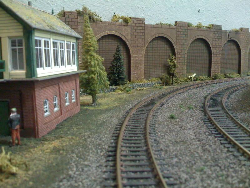

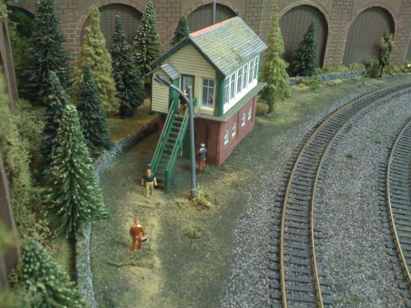

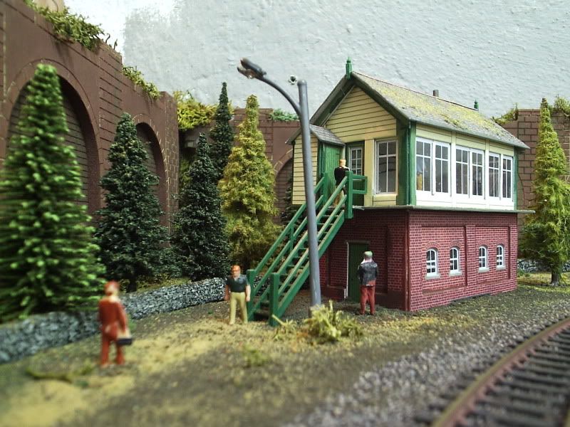

Here's Corner One
This is where I have put the signal box, a Superquick kit of course! A small wall and some fir tree's, touch of scatter and hey presto....needs some fencing and I'll be pretty happy with it...
More later with the next corner....
Thanks,
Gav.

Spavo wrote:Here's Corner One
This is looking great! You really mean Metcalfe of course - not Superquick!

Spavo
Posts: 1273
Re: Gav's Train Set
Postby Spavo » Sun May 02, 2010 11:58 am
Doh! Metcalfe of course!!!

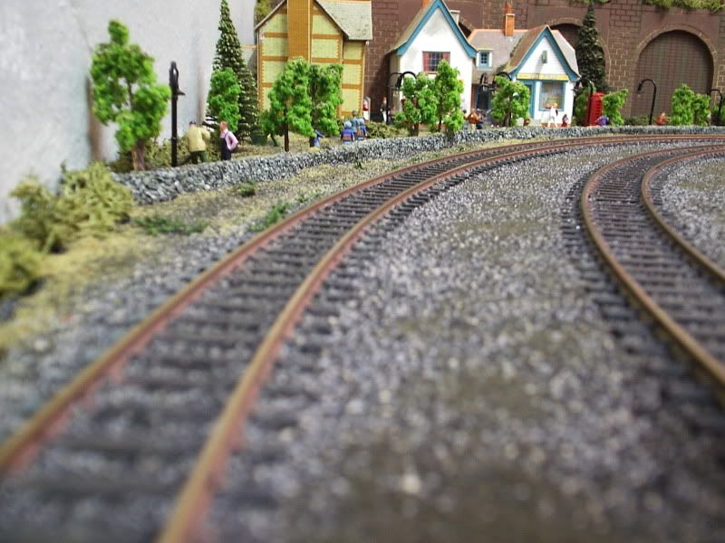

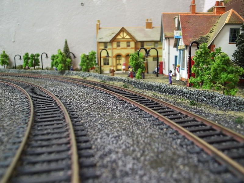

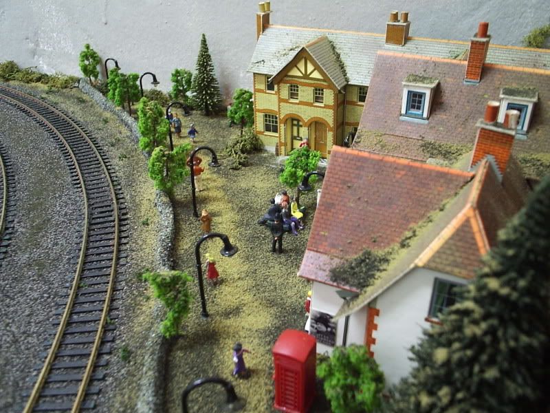

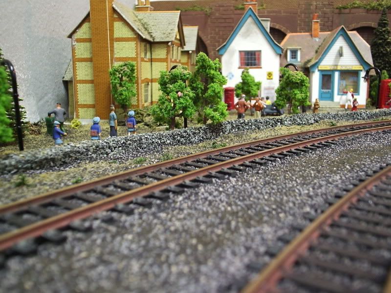

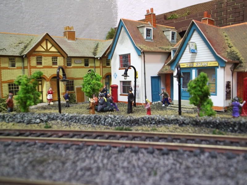

So onto Corner Two then.....
A small town scene with a couple of townhouses and the recycled bar/shop from my previous layouts....
Here you go....
Thanks for looking,
Gav.

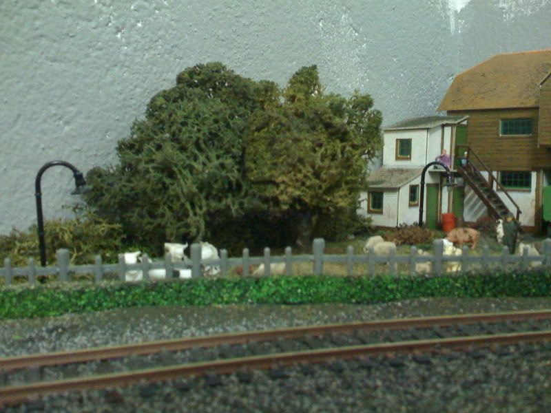

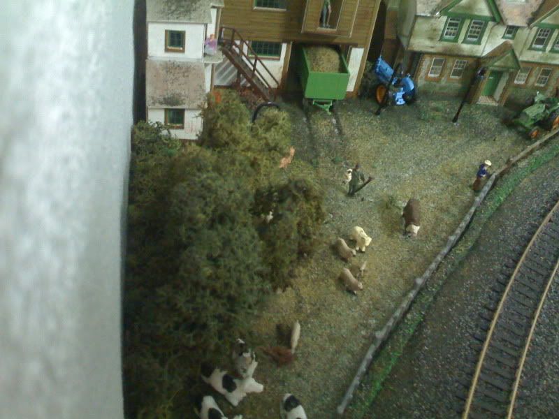

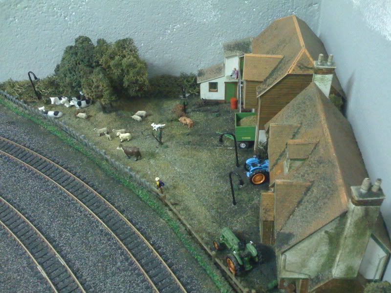

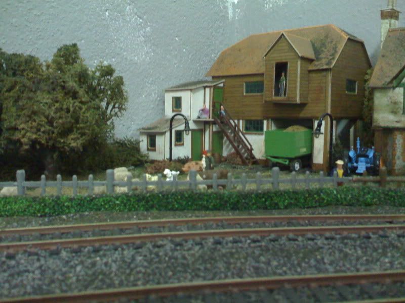

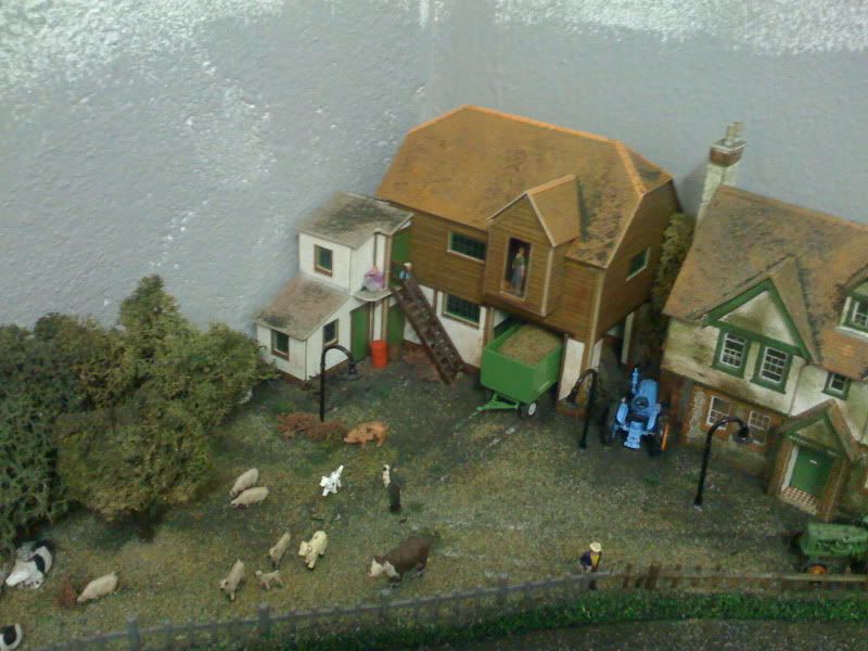

So onto corner 3 which is my recycled Farmhouse and Farm building.....yes it is indeed the smallest farm in history but it is amazing what you can squeeze into a corner....
Here you go...
Hope you like and thanks again,
Gav.
