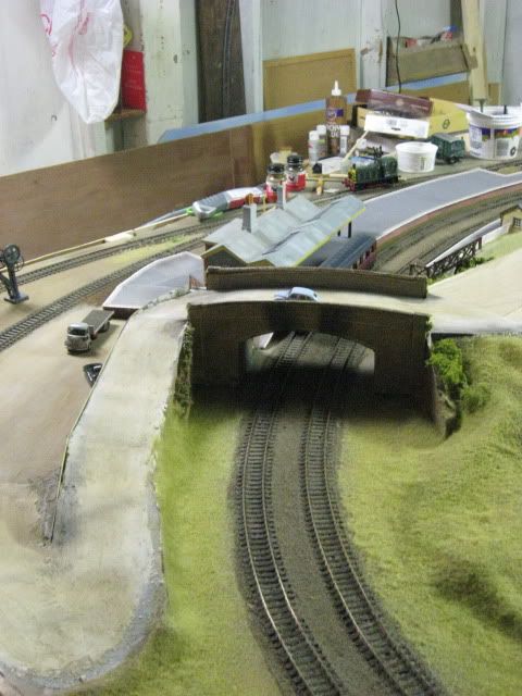

Well on to an update - disaster struck when I decided to add a gray wash to the road bridge - doh - the cardboard started to buckle up when it got wet. Started looking like a rollercoaster :roll: This time, I tried to save it by liberally smearing the surface with some wall filler and then used some powders. It still needs some work, but looks a little more acceptable. I also used some plastic card to surface the side of the bridge incline. This needs more colouring and detail. The access road and two sidings are also coming together although a fence is probably in order to stop people wandering onto the line.
On the other side I have added a couple of layers of static grass.
I think I need to crack on with another section of the layout as I seem to have spent an inordinate amount of time on this section.Stay tuned!

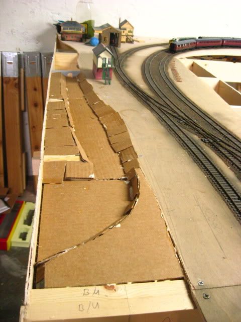

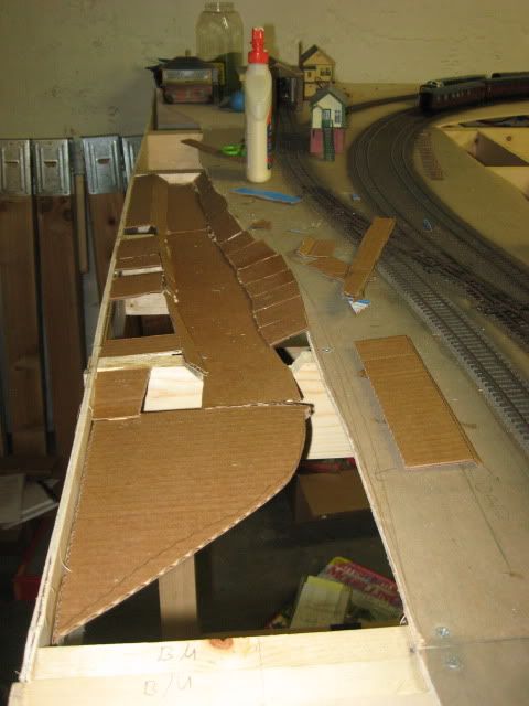

Not a great update - Idecided to move a little down from the station and work on a small dyke/sluice of sorts. I thought that this would probably add some variety.
I cut a little section from the cross supports and started shaping the profile with cardboard.

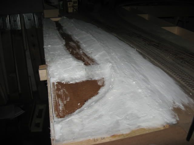

Next I used some filler and paper towel and dilute pva to contour.
Seem to make a right mess!
But hopefully with colour and covering, will turn out better.

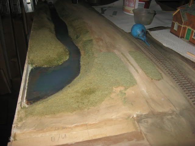

This is the start - unfortunately, the light was pretty bad...
Added paint and tried that Woodland Scenics 'Realistic Water' - initially it gave looked good- but has now become flat, showing the corrugated cardboard. (This does look like ripples though - we'll see)

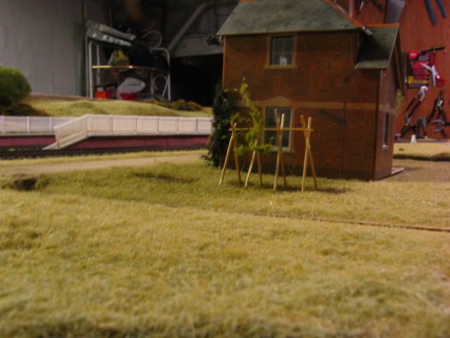

I have also been working on the static grass and adding other elements - I am please with the results of the grass, although, I am sure I would have got better results the electric apllicator rather than the puffer bottle.
The sides of the sluice need some more work with shrubs, bushes, weeds etc - have to also put some trees down as well. The shot would great on a Fenland railway - marshes, cold wind off the North Sea.... but we are supposed to be over in the West of England!
And a shot from the station complete with fences - all need weathering and some grasses/weeds added.
I have also been experimenting making some gorse bushes with some brown polyfiber and fine scatter. And that's it for today!

Been smearing a lot of light weight filler over pva soaked paper towel and boards to build up a textured base. Once dried, I add another layer which smooths out the ruts somewhat. This will then be painted and weathered.
As this is a modular layout I am trying to make it as light weight as possible, yet have some strength. Only real issue presented is the gaps between the base boards. Either covered with foliage or made to lokk like a drain?
