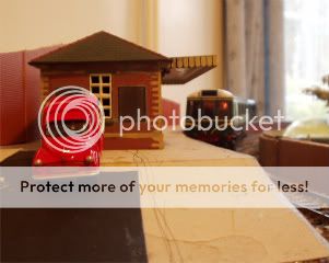

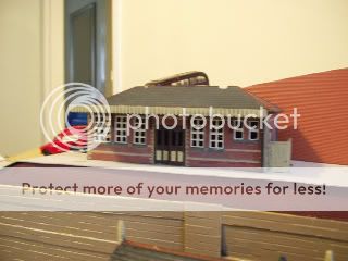

Well I did a fair bit of work this weekend on the layout because the dearly beloved was away again. I made some progress on the topography behind Gwynraven Station. This hill will disguise the end of the colliery exchange sidings with Gwynraven Station in front of it. The colliery sidings are mostly in the open but the point, headshunt (a whole 56xx long!) and about 6 inches of the loop are hidden by the girder bridge. The top is removable to allow access to the sidings which will be lifted out by lifting the buildings. I am hoping to give the impression that the colliery is on the side of the valley and that the colliery line goes somewhere (in my mind to another colliery in the area).
The station at Gwynraven ( the terminus) is a Dapol Kit which fits the site well. It will be paired with a GWR pagoda lock up. The station is perched above the running line below which looks unrealistsic to my eye but it forced upon me by the small sixe of the layout. I have crammed such alot on a 5 foot 6 inches by 7foot 6 inch board. Three stations, two junctions, a colliery and a three road fiddle yard.
I really like this view of the terminus and so I'll detail the buildings better for the future.

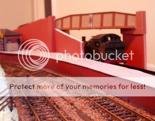

This is what I mean about crammed in, above the retaining wall to the left is Gwynraven station. The signals and signal box are only temporay at the moment but the signals do work! I like looking at pictures of my own layout, not through narcisism but it makes you look at everything more critically.
I mean, I really need to line that tunnel!

Hi Si
Coming along nicely
The photo and check works very well particularly for the dreaded white spot in scenery
or just the bit you missed.
For the Dapol kit terminus step one buy SWMBO a nice box of chocolates in a hard clear plastic box
then steal box for making glazing its better than what comes in the Kit.
If you intend lighting the building paint the inside black so the light has no choice about coming through the windows and not the walls.
If lighting also leave the glazing off a window or door that will be out of sight.
Suitable tiny signs posters and GWR or BR WR signage will help a lot as well
Oh! and if you have the patience and a book of British birds a couple of suitable birds on the roof as well Langley does those.
With the Dapol structures its the extra effort that makes the difference they have not changed from the Airfix railway kits from the sixties
I like them there don't seem to be many plastic kits for UK buildings around any more well not over here at any rate.
Properly built with a little bit of extra work they can look real good

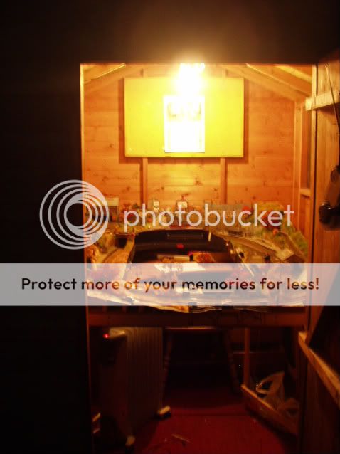

This is where I go when the :x X Factor is on! SANCTUARY. OK some of you have better modelling rooms but all 8 x 6 foot is mine. I have carpet, electric, a heater, light, a radio and brew kit. What else does anyone need?

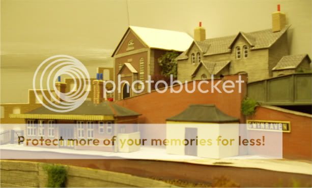

I did alot of work on the layout this weekend. I did the very last but of wiring and added the last of the teddy bear fur grass. It's still ginger but it'll be painted soon.
I took the opportunity to put the two halves of the layout together to play trains for a while - it's good for the soul. I also took a few pics, the best of which are attached.
Kits Hill Halt with Gwynraven Colliery looming behind. Note the difference between the raw fur grass and the painted part. I'll paint and blend the two this coming weekend.

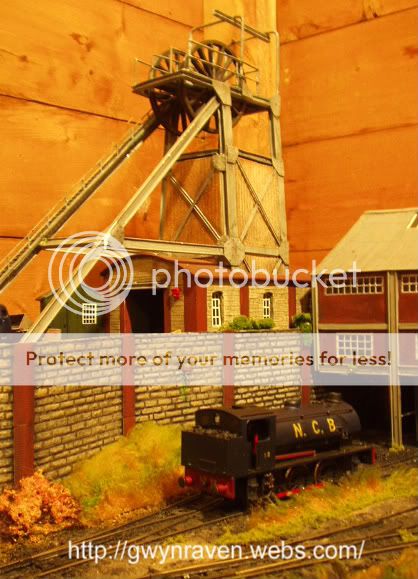

Postby Si_Donal » Mon Nov 22, 2010 7:46 pm

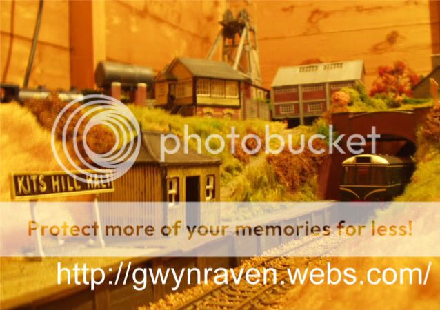

I love this view, it turned out exactly as I planned which makes a huge change for my modelling!

Postby SouthernBoy » Mon Nov 22, 2010 10:15 pm
Good to see an overview of the layout in that first picture - seeing how it all fits together in your little den :)
Well now you've done it once you'll be able to do it again :)
Nice work - very atmospheric.
Have you thought of painting the walls the first foot or so above your layout sky blue? I think it would make a huge difference.

hey SouthernBoy,
The backscene is on it's way. The boards have been cut to shape and the fixing screws fitted to the frame. It's a 2 foot high one because of the height of the contours - much larger than commercially available ones. The sky will be pale grey reflecting the autumn feel and I'll attempt dark clouds. I'll try to paint it but my fall-back plan is PECO backscenes, slightly modified.
I plan to be finished by Easter. (yeah really!) :lol:

Postby buz » Sun Dec 12, 2010 2:51 am
Hi Si
A model railway is never finished it can be completed but never finished.
there is always something you can do to it.
Looks like extending the railway could have real estate problems :wink:
The mine should be prominent its a signature piece that identifies the location of the railway
The way you have got it to tower over the layout and the trains is absolutely brilliant
you cannot miss it.
And with the GWR buildings it screams Wales I wish I was that good.
