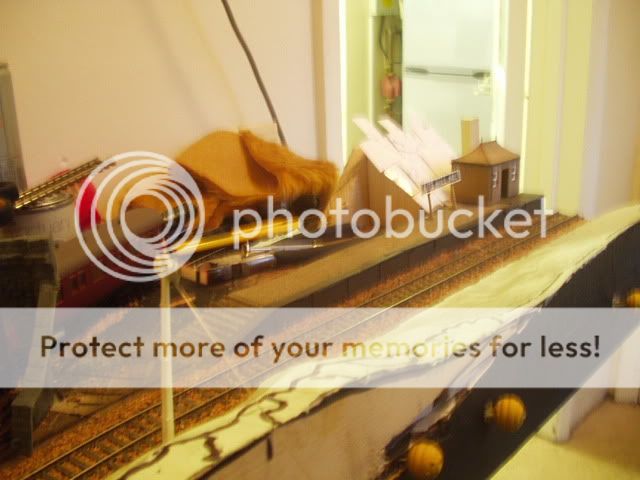

The last job I undertook today (as a little relief from those signals) was to turn the fiddle yard's only dead end siding into a station. It'll make more sense when I have the trackplan scanned and loaded here but there are three loops in the hidden sidings plus one closest to the operator. That last siding is a dead end so I can reverse trains but, rather than just have it hidden, I have added scenery to it. That has two advantages, one, the siding is easier for me to get my hands too and secondly it adds another modellable scene to my very small layout. It is a simple GWR Halt. The "pagoda" is from Wills and the platform is built from balsa (cheap), cereal packets (free)and coffee stirrers (stolen). It is called Kit Hill Halt after my wife Kit - that'll get me some brownie points!
The other half of the station is on the other board with a bridge to cover the hidden section which will accommotate a 2 coach train and a loco. The area where the "fur" is the hidden loops and the colliery will go above and behind the halt.

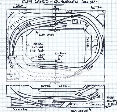

And finally..... I have drawn the Trackplan. I hope it makes sense and I'm sorry that it isn't one of those whizzy computer generated ones, I prefer the Mk1 pencil and graph paper - am I the only luddite? The upper level is not yet started although the gradient to get the trains from the lower level has been. The upper level is shown as a seperate cut away.
It looks very busy but that's why I like South Wales as a prototype, short trains, horrendous gradients and lots of tunnels (as scenic breaks). All of which are useful for a space starved modeller.
Re: Cwm Lanod & Gwynraven Colliery - Trackplan finally loaded!
Posted: Tue Dec 29, 2009 7:50 pm
by Michael Thornberry
Merry Christmas Si,
Contary to "popular working-practice in the Civil Service" your Lay-out appears to have been:-
1/ Well thought-through
2/ Well drawn and
3/ Well resourced, unlike every other Tax-payer funded Labour Government "mistake" :lol: This Plan/Lay-out of yours shows great promise so I will keep a watching-eye on your progress. My apologies for my Civil Service cynicism,
Posted: Tue Dec 29, 2009 9:25 pm
by pointstaken
I like that layout, appears to have lots of operational possibilities! Looks a nice job on the loco as well - hope I can do as well if ever get round to building mine. Only question in my mind would be about the gradients - have you tested your locos with the length of train you would like to run, before you get round to building the upper level/
Dennis
Posted: Tue Dec 29, 2009 9:53 pm
by Si_Donal
Hi Dennis,
Thanks for your kind words. I did test out the gradient. I mock up everything up before I build it. This is a hard learnt lesson from my past railway modelling experiences/disasters*. It rises 65mm (the very minimum I could get away with) in 1500 mm. 3 inches rise over 5 feet in old money. It is very severe indeed :shock: . If my lousy 25 year old CSE Maths is correct, then that is around 1 in 21. The unrealistic gradient is why I hid it in the tunnel and under the miners cottages.
The Bachmann 56xx and Pannier take 8 wagons and a brake up there at a steady scale 15/20 mph. They are heavy little locos and I have added some more weight with lead, whitemetal crew etc. I only use wagons with metal wheels which helps reduce friction. This is the maximum train length that the sidings will accommodate anyway. That gradient has a 1st Radius Curve in under the hill also which hasn't proved to be a problem yet.
The Hornby railcar, although it's a good runner on the flat, slips horrendously on the gradient. Weight has been added and that has improved things a little. The railcar will not run with tail traffic so I'll carry on with extra weight experiments until it works.
The Bachmann 2251and Hornby Large Prarie are banned from the branch anyway!
*delete as applicable :lol:

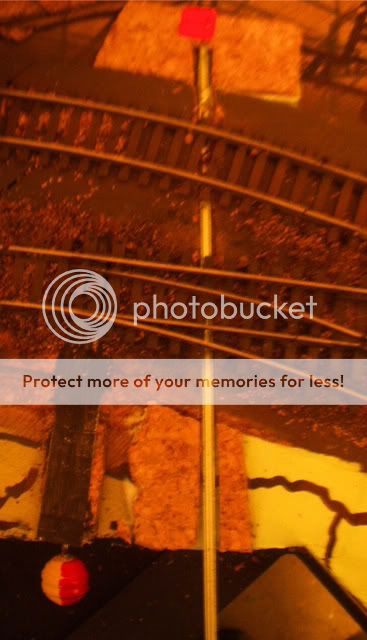

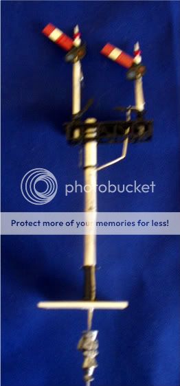

Another day being creative and losing my mind! :? . I spent alot of time adjusting those signals again but by jingo I think I've cracked it. The possibility of "simple" remotely operated and yet removable signals is close at hand. Muah! Muah!! Muah-ha-ha-ha! If it works before the sanity is lost I'll post a thread on it. Half of the Ratio Kits are still on the sprue though! Anyone familiar with the old toy Crescent Signals from the 1950's will understand my plan. This is the result so far.....
They are in fact lower quadrant signals but they look like upper quadrants. This is deliberate because the weights you can see under the base are pulling down and therefore pulling the arms up. They are connected by a single wire, not by the complex links that Ratio provide. It's a case of practicality over looks. Later I hope to show you how the weights will be lifted remotely and the arms will fall from horizontal to the down position. Well here's hoping. This picture represents a good six hours of work so far!

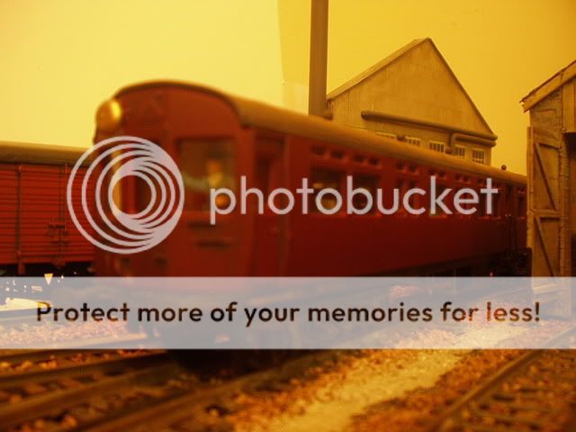

As I've mentioned before, I usually have a few jobs on the go, today completed the detailing on my re-painted Pannier tank! I also weathered my autocoach and painted the interior. I think it's looking good and I feel much more confident with weathering now, hey it's only taken me 10 years! :shock: I have to build up the confidence before I weather the pannier. Perhaps a scotch will help?

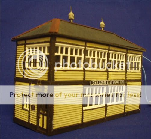

It was a Hornby Dunster signal box bought cheaply from ebay. Dismantled and then cut and shut into a larger signal box more befitting of the junction. The back of the box is just plain plasticard now. The original roof was a very low pitch and so I made a new one, that took ages. Wills sheets look brilliant but they are not my favourite to cut. I made a lever frame out of pins and signal controls made from bits of scrap sprue (those detailing kits are just sooo expensive). I have used LEDs to make lamps outside the doors with the plastic from the packing around paracetamol pills as lampshades. There is an interior light and I am just waiting for a signalman. Glad that's over, I think I may buy a Hornby or Bachmann one for the other signal box!

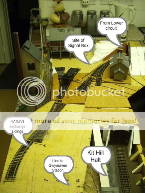

You know how it goes, your wife announces that she's away on Saturday night! You smile a little to yourself, knowing that you can use the kitchen to work on your layout without any complaints. :) You think you have everything you need to make some progress. She goes, you get the layout from the shed and.......the fishplates you bought are for N not 00, the PVA went off during the freezing weather! :evil: Such is life!
Anyway, I have started on the upper level of the layout. The cork tiles are being cut and the groove for the operating rod are cut in before the cork tile is glued down. This part of the layout is a scant nine inches wide and will have four tracks and a platform too.
Kit's Hill Halt is on the lower level, 70mm below the colliery. The bridge is in fact the entrance to a hidden siding for the autotrain and DMU. The exchange sidings will be partially hidden by buildings, hopefully giving the illusion that they are larger. The colliery can accommodate 8 wagons at a time. The house on the main road is a view blocker that hides a really ugly entrance to the line that takes trains to the lower level.
Re: Cwm Lanod & Gwynraven Colliery - snow causes more modelling!
Posted: Sat Jan 23, 2010 9:30 pm
by SouthernBoy
Looks like that's going to be another interesting 'character' area on your layout Si. Love the little speech bubbles :) The colliery area on the left caught my eye - do I see a narrow gauge line there? And is it for horse-drawn wagons or does it operate with an engine?
