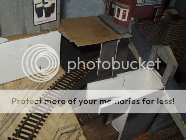

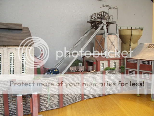

The Gwynraven Colliery - this is a module that fits onto the layout's main board.
If the buildings look "cut off" that's because the colliery is modelled in 3/4 relief. The headgear is a Bachmann Scenecraft Item with extended front legs (the angled ones), it sits on top of a scratchbuilt building with a curved tin roof. The engine house is also scratchbuilt. It houses an electric motor to run the pit wheels (sheaves). There is a 9mm narrow gauge railway at the pit and I built some tiny coal tubs for it too. I don't find scratchbuilding easy but I do invest alot of thinking and planning time before I cut any card or plastic sheet. I have now completed a concrete water tank using a kitchen funnel and a set of coal drops/washery too. I am very pleased with this.

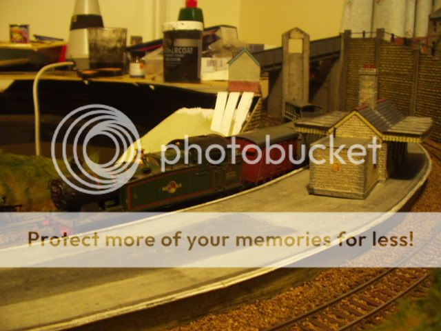

This is the Main Station of Cwm Lanod. It is a junction station although it is not obvious when you look at it. When I load the trackplan, it'll be obvious. Forgive the curious sky effect :D ! That station building needs to be well seated onto the platform.....another job for the list!
Looking the other way. The square hole in the bridge parapet is for the footbridge to he island platform and the bridge disguises the entrance to the hidden sidings. The slope on the bridge is typical of those I have researched for the area.

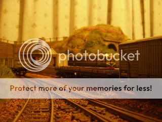

I have been ballasting. What a pain. This is the first time I have ever done it and I cannot recommend it as a relaxing part of the hobby! The method was simple it was just time consuming. I laid dry cork ballast onto the pre-painted track (Railmatch sleeper grime from a spray can). I wet it with a water sprayer then a 50/50 mix of PVA and water with a good dollop of washing up liquid. When it was dry (leave at least 24 hours) I spent an evening picking of the bits of ballast that had moved during the water spraying and an attack by the family cat. After that exhausting chore I used a water colour wash of very dilute black on the whole track. I did a double application on the sidings and a single one on the running lines. The ballast is now a nice brown.
I have also received a parcel from Hattons, with my Birthday present in it! Wagons.....lots of them too! They have been weathered this week using a wash of black poster paint (Early Learning Centre). The paint is then wiped off whilst wet. This leaves black in the nooks and crannies and also the gaps between the planks. This is the method advocated by Ian Futers in the Railway Modeller and I have to say it's pretty effective, well to my eyes anyway. I will also dry brush the chassis and lower bodies.

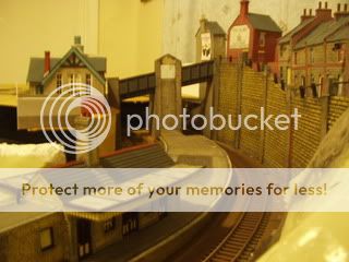

This is my favourite picture: Great angles/curves/variations in elevation and nicely toned colours too. I think your autumn colours are working well.

Thanks very much Gents. This layout has been a long time in the planning (2 years) and I too am very pleased with the look of this part. I am taking my time with everything and make mock ups before commiting to anything permanent. That curve around the curved platform is deliberately tight because the board is only five and a bit feet wide. Placing tight curves in a cutting with no obvious viewpoint from the viewers (in my case the operators) position helps to disguise the fact that they are so tight. The layout is basically an oval with a branch and the curves are even tighter in the fiddle yard so that those on view are a large as possible. I have one 12 inch radius curve in the hidden section that the Bachmann 56xx goes round with ease! :shock: Passenger stock doesn't use that line though - short wheelbase only.
That retaining wall is not just scenic, it is there to disguise the line to the upper level, where the collieryand branch station will go. The trains actually run inside the cottages on the right, that's why the wall is so tall. and the upper line crosses the lower one inside the bridge! I know it sounds daft so here's a picture........
Why? Well, I just didn't want to model a flyover bridge and have the whole branch line on view. This way trains heading for the colliery can leave the junction, pause in the hidden section (under the cottages) and then appear at the colliery. Like walking on/off stage between acts. Well at least it works in my mind, :lol:

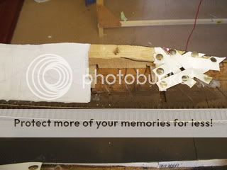

Wow, had a great modelling day. Dearly Beloved was at work,I am on leave, kids playing in the snow or on the PC......peace. So did I clear snowfrom the path? Did I wrap the presents? Did I do the chores? Nah - I set the other board of my layout up in the warmth of the kitchen and had a quality modelling day. :D To be honest, indoors was the only option as the glue and paint probably wouldnot have dried otherwise, because the layout usually lives in the shed. :roll:

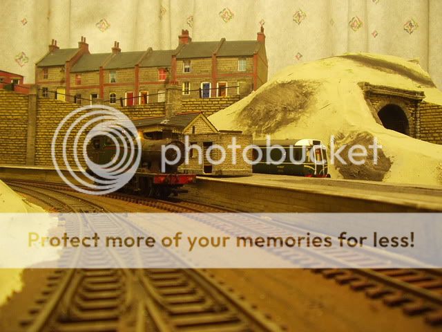

So what did I do? Well i did some landscaping. My usual method is to weave strips of old christmas cards (free) over balsa formers (cheap), glueing them down with evo stick. This is then covered with normal paper (which the MoD disposes of alot of and is therefore free) and painting it with olive paint (from the bargain aisle at B&Q!) I did a small bit in stages to show how it's done. It seems to be strong and it seems to work ok.

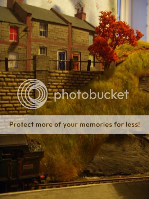

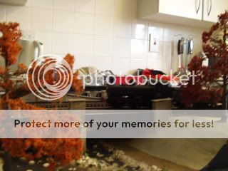

I also planted some trees. The trees themselves are Woodlands Scenics with their Autumn (Fall) leaves attached. I think they look great but on the advice of the Dearly Beloved, I am going to blend a few other colours into the mix e.g. Light Green with the yellow, Yellow with the Orange and Orange with the Red.
I spent alot of time positioning the trees and also taking photos to ensure the impression I created was like the one in my head (errr :wink: plan). During my armchair modelling days,I once read that tall trees can also be placed near to the front of the layout to force the viewer (me) to look around them at scenes on the layout. I have tried to do this although the full effect will not be seen until the backscene is on.
Judge for yourselves but it works for me - comments are always welcome, even adverse ones.

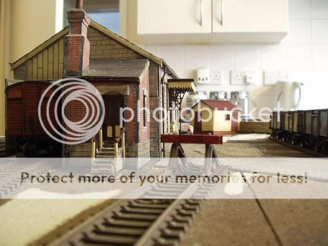

Final task of the day....I'd also finished the goods yard. Just need to buy and install a crane and it's all done. That Goods Shed is a Metcalfe one that has been covered in Slaters Dressed Stone and Brick plasicard. I took a few pics but most were too shakey to use. The yard can take three coal trucks on the coal/mineral road, four vans in the shed and two wagons on the crane road. The bufferstops are illuminated with LEDs. Quite an easy job once I had worked out which resistor to use. They look fine from the front and side but all the wiring shows at the rear. I guess it'll not be too obvious when the yard has grass/weeds etc. The hut at the end is for a trader that sells feed, coke and minerals,it needs a sign and maybe a van/truck at some point. The hut is a half a Wills Garage with a brick base.

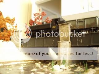

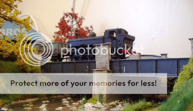

This is the bridge with teddy bear fur grass.

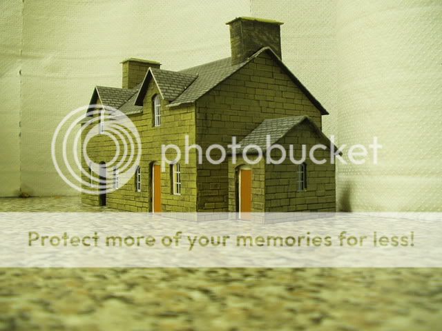

EDIT: Here's a picture of the Metcalfe Railway Workers Cottages as I have adapted them and clad them with stone. Only the roof to slate now.....

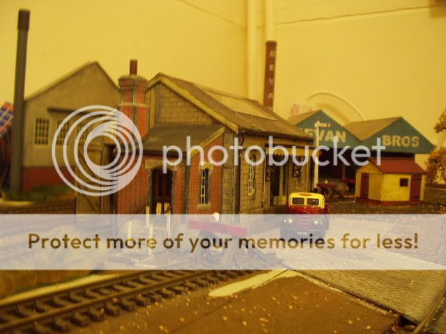

And as a reward for my efforts, I posed a picture of the goods yard with the Bevan (cats name!) Brothers Tube, Valve and Pipe factory in it's place. One of the factories is a Metcalfe kit which I made into a double storey one, the chimney was a broom handle(thank you sweetheart-oh is the broom missing :wink: ) and the other two are scratchbuilt, just to prove I don't only build kits and stick plasticard on them.
You gotta love those diecast vehicles! I hope to have another decent day's modelling tomorrow but as it's Christmas Eve I may have to be a family man again. I can't complain,the Dearly Beloved is very tolerant:lol:
