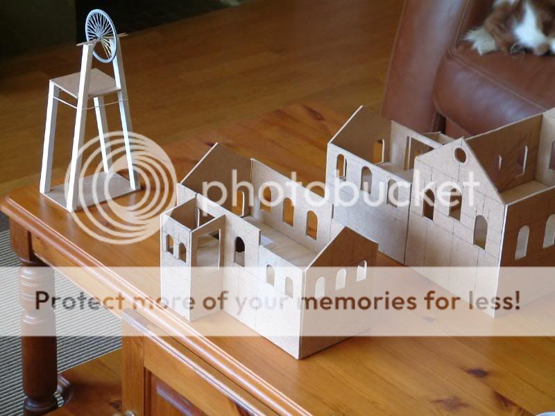

The coegnant Branch is an add on board for either the Blue line Garden Railway or the fiddle yard in the garage. Its is based on a model of Coegnant colliery in the Llynfi valley South Wales. The first version will be based on the colliery as it was soon after nationalisation. Here are the first pics

These buildings look great Paul. Any chances of some pictures of the rest of the layout?

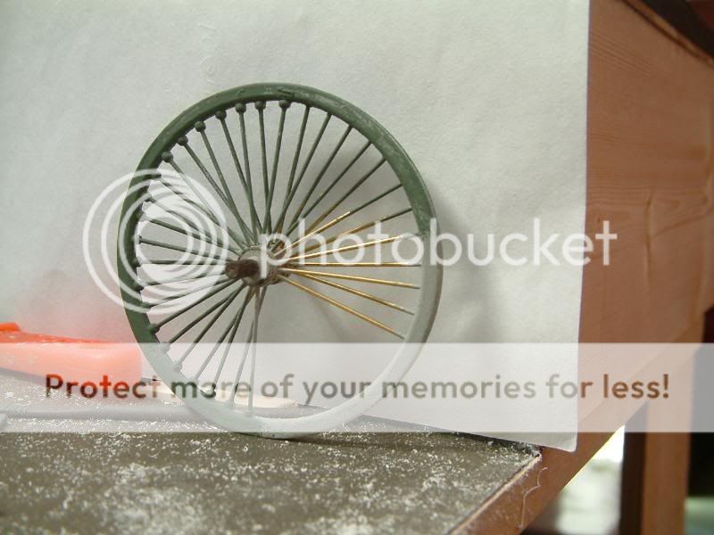

How did you build or where did you obtain the winding wheel? I really like the internal steam engine. Are you working from photographs or original plans?

The small windmill thing is the partly constructed steam engine driving the winding drum. Only the drum will move and is built to the correct diameter to give the correct position for the openings in the wall for the Overwind and Underwind ropes. The diameter of the drum being a minimum 150 times the dia of the rope.

Hi Grotland
I,ve done extensive research on the colliery mainly from photographs. The winding engine drum is made from mdf sides and a plasic bottle for the drum it,s self. This first model is set during modernisation in the 1950,s In fact the winding houses have been extended to allow for new electrical gear which has not been installed yet. I will not be installing the new fanhouse either as a number of railway line were removed to make way for it. More photos to follow

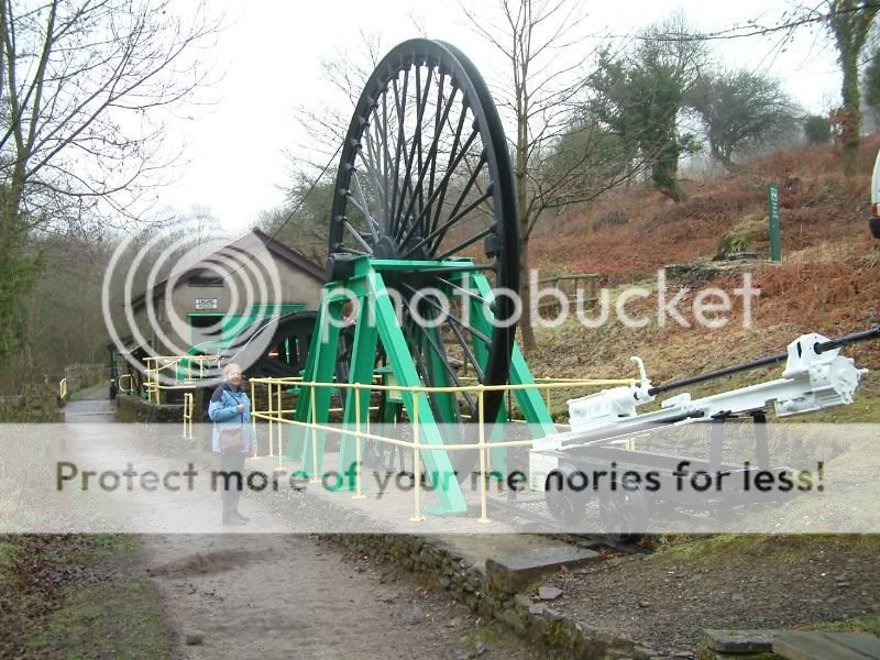

These photos show the sheave from the colliery and my model version

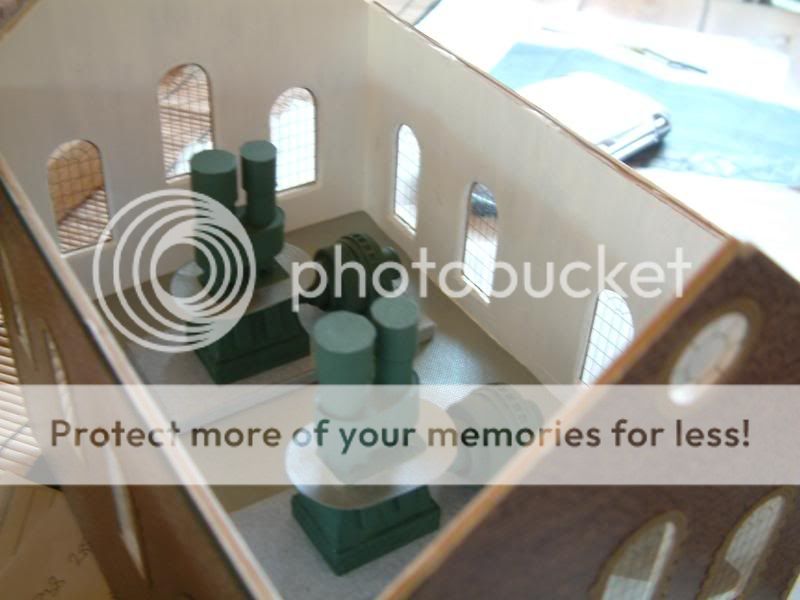

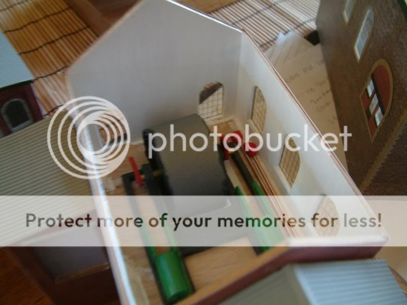

I decided to put some detail inside the buildings which will be lit. The winding houses will have a revolving drum but the steam engine will be static. Two commpressors have been made for the compressor house, these were made of card and the tops of Carex soap dispensers

Its nice to see some modelling like this your attention to detail is great, this will be a great looking project once finished.
I really like the wheel thats taking shape Keep the pics coming
