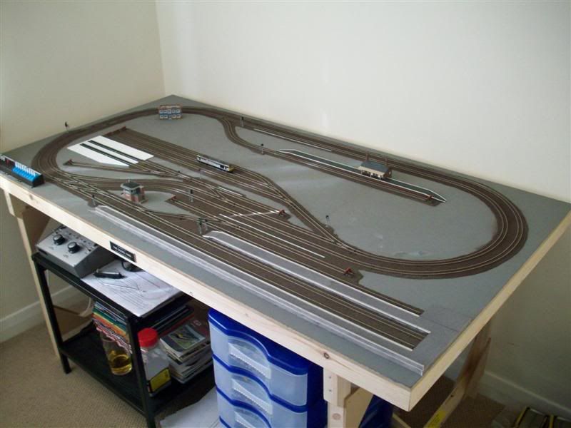

Here is my layout for everyones perusal. I've been asked about it a few times, and I've made a bit of progress now, so thought I'd post it up.
Firstly, credit where its due - the layout board/track laying and electrics were done by The Goods Yard, and a very good job they did too. I can't recommend them highly enough. Pictures of the layout as delivered can be found here.
I run stock on the layout from BR Blue to Sectorisation - basically anything with a TOPS number up until privatisation. In terms of operation, I try not to run Scotrail stuff at the same time as NSE for example but am aiming to go for a generic sort of feel to the layout, allowing me to run either as the mood takes me. The first bits of scenic work that you see here (ballasting & track weathering, basically) have taken me a long time - I prefer tinkering with locos to doing scenic stuff but hopefully the layout will move forward at a decent pace now.
Thanks also go to Grahame of Stoney Lane Depot for track weathering advice, Blooregard for depot floor and cable trough ideas, Sprintex for unknowingly giving me the motivation to get my ballasting done (due to his layout looking rather excellent and being done much quicker than mine!) and to Chris (Raider) and Simon (SASLord) for keeping the forum ticking over.
First up, a track plan (which I'm sure some have seen before):
The track is laid to Setrack geometry. Alot of people don't recommend this but I haven't found any problems. My 08 shunter is quite happy over the points (most of the time!) and I haven't found anything which won't run on it (although my VGAs don't like the crossovers!).
I'm sure the rest of the pics will speak for themselves apart from the first, which was an abortive first attempt at the platforms. Any questions, feel free to ask.

Thanks for the kind words gents. The depot floor is now done, although not weathered.
engineer dave wrote:What sort of scenery are you going for? I'm guessing that the terminus and the country station will call for a mix of urban and rural.
Hi Dave,
The tightest corner of the layout will be covered by a tunnel, on top of which will be the edge of a town plus the main terminus building. There will then be a road down into the middle which will lead to the depot - the ground around the middle will be wasteland. Theres so much track I don't want to overdo it with buildings.
There will also be a level crossing which will lead to the branch stations car park.
Or at least thats the plan at this point!

Great intro, but you've not posted much details about the baseboard construction (seems to be quite common, that many people don't post about this process)
Two questions...
The baseboard looks like 12mm MDF
Has the surface been painted, if so what with?
What method has been used for the ballast?
Glasgow Queen Street Model Railway layout : modern image N gauge using DCC
MrT
Posts: 431
Re: Long Newton: BR 1980ish - 1993 in N
Postby MrT » Mon Jun 01, 2009 11:18 am
Hi Marcus,
The baseboard is 9mm MDF topped with cork and painted grey - more info can be found on the Goods Yard site, linked in the first post.
I ballasted the track using Woodland Scenics fine grey ballast - this was 'misted' using a fine spray containing water and a little fairy liquid and then fixed in place using a 50/45/5 mix of water, PVA and fairy liquid (normal method I guess) applied with an eye dropper. The track was not weathered prior to ballasting. I then used a Precision Paints 'Track Dirt' aerosol to weather the track and ballast, having put masking tape on the points where they contact the rails. Initially, I was disappointed with the finish, thinking that the paint was too dark but I quite like it now - it seems to have faded slightly and doesn't look quite as bad.
