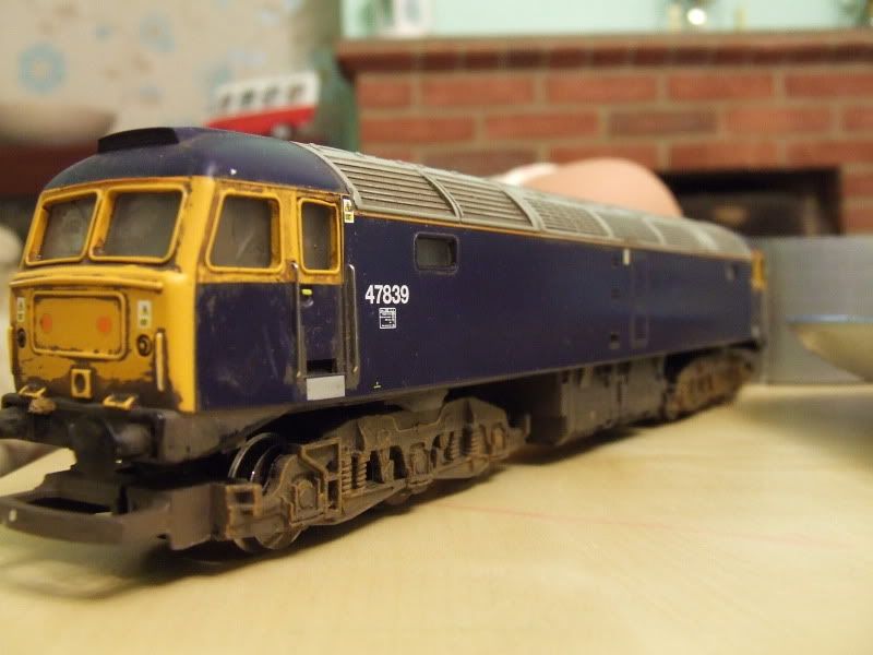

i dug out my only train set which i put away when my trackmat went, but as i need more traction on my layout i thought id put up with the fact that its not the most detailed version in the world.
so heres my first attempt at weathering an engine, its not as good as i thought it mightve looked but one has to start somewhere!
whilst stripped down i gave it a good service and bu**er me it runs superbly at slow speeds which is just what i wanted!! i aslo gave a couple of wagons a thin coating of grime.

Yes I'd agree that the loco's weathering leaves something to be desired ...... what paint did you use ? By that I mean acrylic or enamel. What you have is a distinct line where your brush laid the paint. With Enamel I wait until a coat like you have on that 47 is becoming quite sticky, to the point of being well on the way to being dry. Then using a touch of white spirit on a clean brush tease the edge, regularly washing out the brush and taking most of the spirit out on a rag/kitchen roll before you work the edge. That way you can fade the painted sections hard edge.

hi
the paint im using is watered down railmatch acrylic, Frame dirt and sleeper grime with a little brake dust on the bogies.
one thing i will say is the colour differences in the sleeper grime and frame dirt is minimal to say the least!

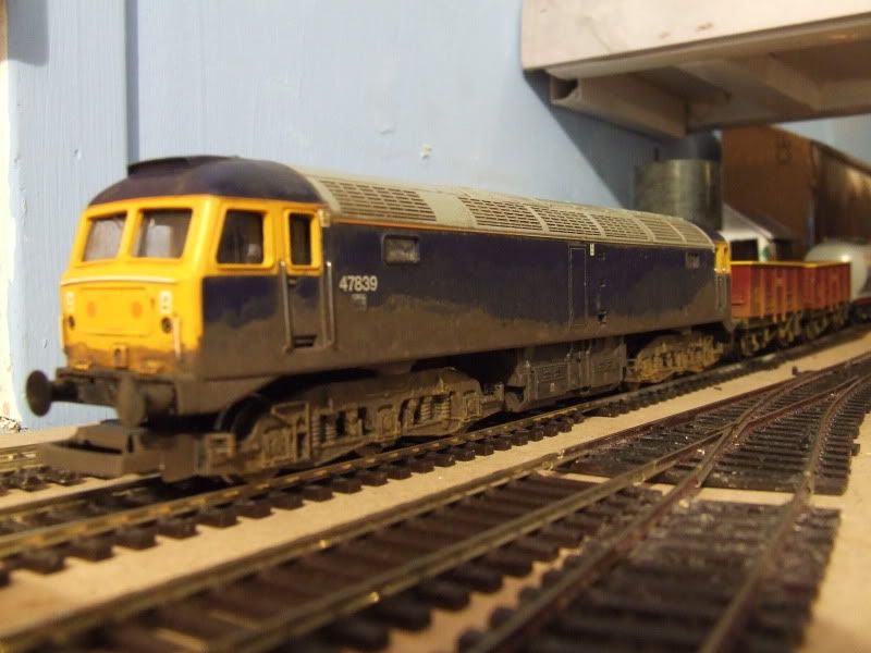

i stripped all the paint off for a second attempt, the underframe im happy with the roof im happy with (just need some black for exhaust stains) but the body is naff!
i still cant get the paint to blend in without the difinative line. it looks too thick and splodged even though its watered down layers!
ive been looking at pictures of a dirty 47 trying to recreate its thousands of miles work, not just slapping paint over which it looks like!!
so night 3 im back to this
just gotta finish removing the dodgy paint on the yellow front panel!
Geoff, i did try waiting until the paint was almost dry then trying to fade out with water as per your method but once the acrylic was almost dry and i added water it pulled great chunks of paint off, hence i tryed watered down layers.
any more ideas that might help? (apart from an airbrush !)

This new project is really showing all the lessons and skills you learned on you trackmat setup. Without wanting to demean your earlier efforts (after all I've only been modelling a very short time) this layout looks much neater, your attention to detail is much better and it shows in the photos.
Your weathering on the locos and stock is really good - the rust patches on the wagon looks fine to me and the end effect you achieved on that blue diesel was well worth all the experimenting to get it right. It looks like a time served engine that's had the paintwork kept relatively clean, I'm going to try the technique on our 4MT so cheers for the inspiration!
