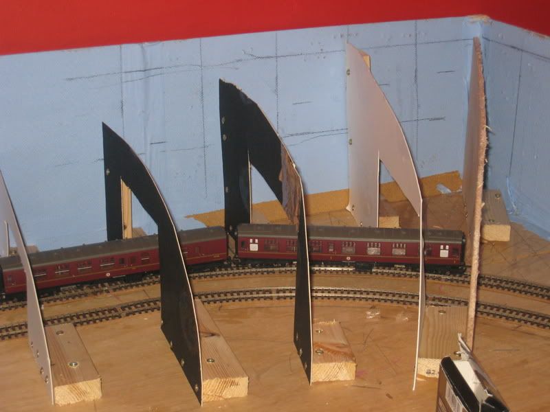

Re: Lordsbridge
I'm sure you'll get the tunnel right this time mate!
Heres how I do it and although its not finished the current progress is on my layout thread:
1 - Glue the tunnel portals down in their position
2 - Put some profile boards up where the tunnel will be, this will make it all far easier in the long run.
3 - Using plywood or hardboard cut a square piece with a hole at the bottom big enough to span the tracks and let your locos through. Like this:
(Notice the plywood one in the corner, thats the main one)
4 - Repeat the proccess making the boards smaller (like detailed in that picture)
5 - Now cover the whole thing in a bubble wrap sheet and either staple or sellotape it to the sides and tunnel portals.
6 - Papermache over the bubble wrap.
7 - Once the paper mache is dry plaster over that using plaster cloth
8 - Apply scatter.
Thats just the way I do it, thought I'd mention it. You'll get it right this time i'm sure!
