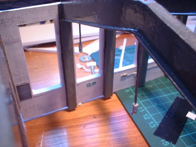

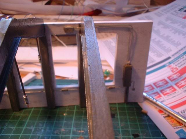

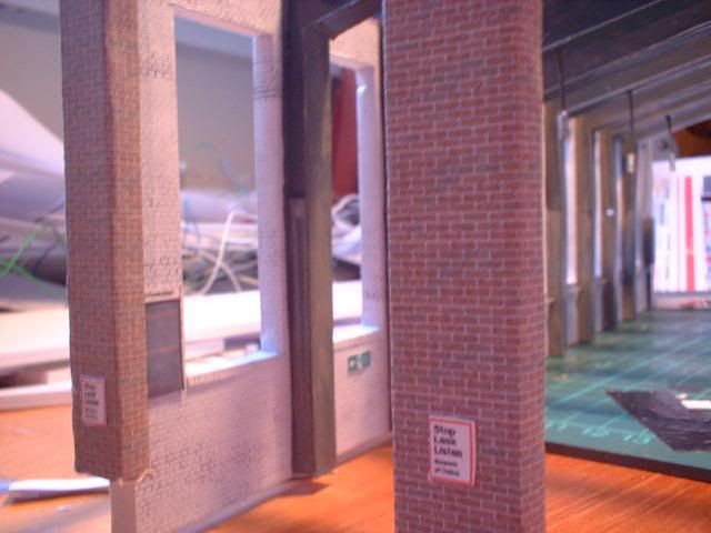

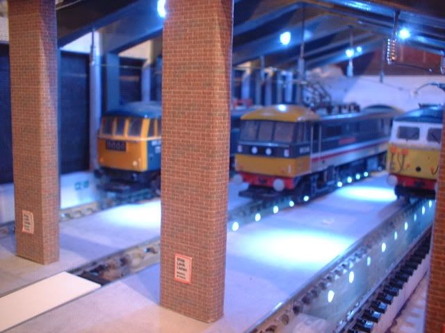

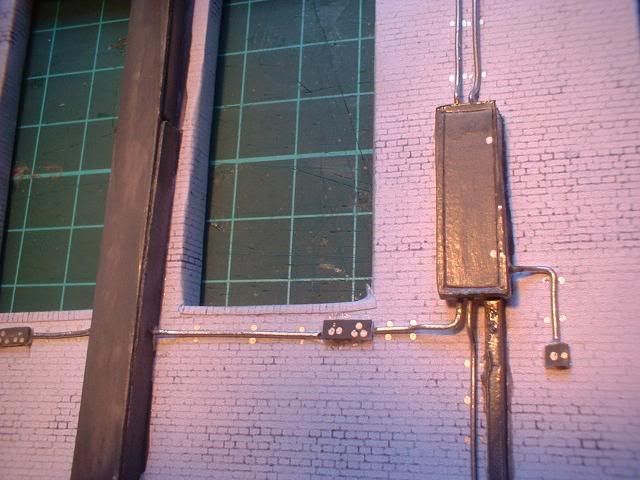

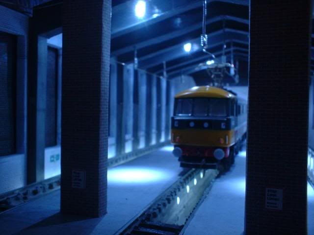

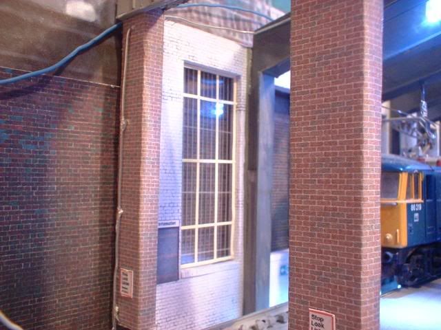

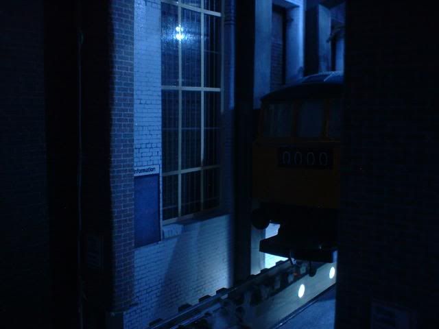

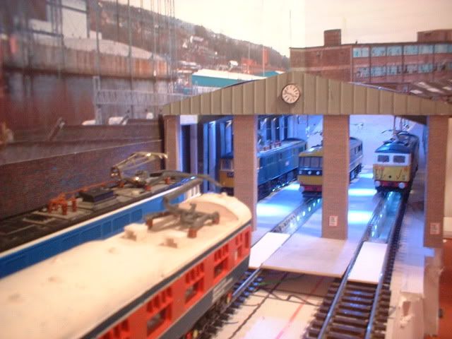

Todays progress. As there won't be much room for stock movements whilst the module is used as part of the YMR layout I need to add as much intrest as possable. So some scraps of wire and a few boxes makes....
To suggest that the conduit is fastened to the wall I used a silver marker to give the impression of the wall saddles....
Once stood up on the bench it starts to look more relistic...

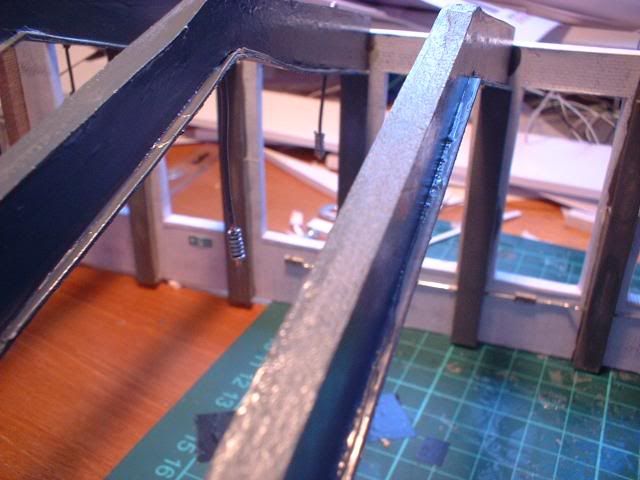

More scraps of wire produce the OHLE hangers...
Another view of the switch gear..

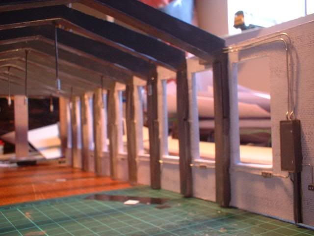

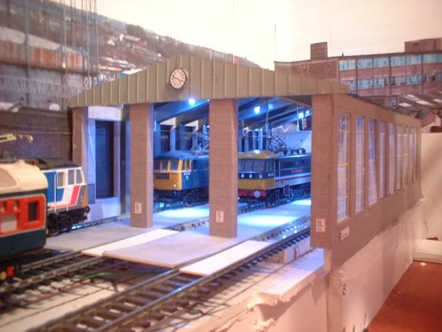

Shed in position....

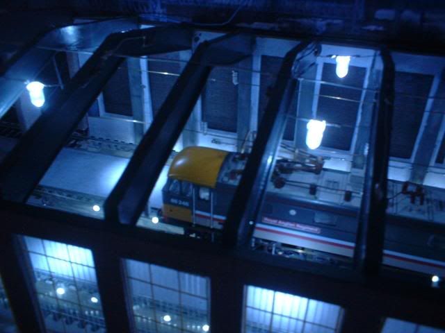

Lights on....
Have figured out a way of making a working loco lift so this will have to be fitted before the shed can be fitted in place just seems a shame to fit a roof!

Postby beerandpies » Sun Aug 02, 2009 8:29 pm
I had to look twice at that detailed wall. It looks amazing.

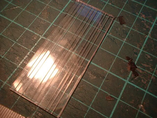

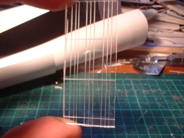

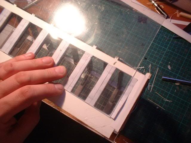

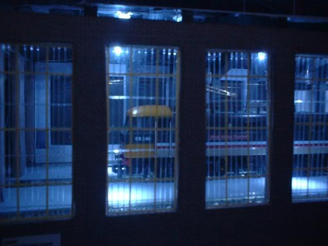

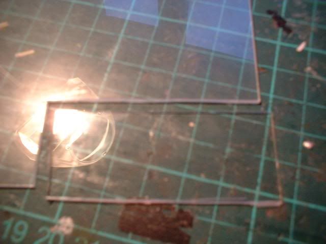

Ok I have had quite a bit of feedback regarding the shed build so far and one of the requests that keeps cropping up is how I did the windows so note books out I will be asking questions later!

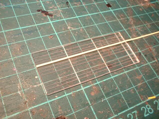

1. Take a sheet of 1mm thick acrilic and mark out the shape of the window...
2. Cut out and then remove the protective covers...
3. Using the grid on your cutting mat score lines on one side to represent the strips of glass.....

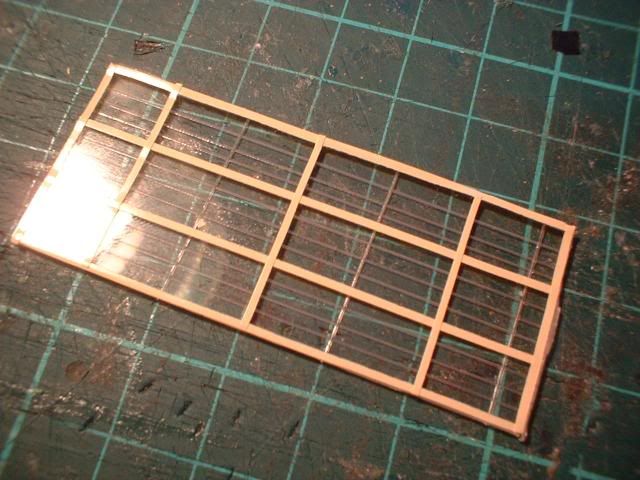

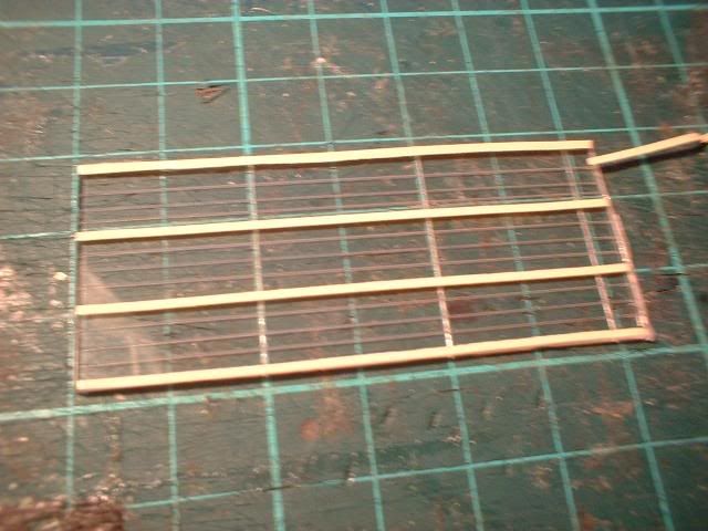

4. Add the horizontal bars the same way...

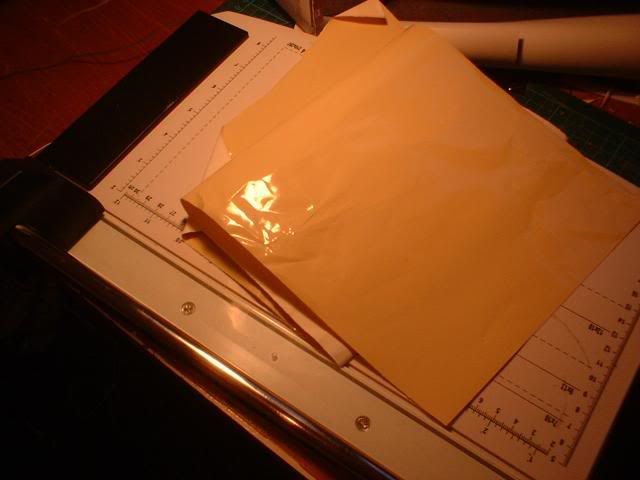

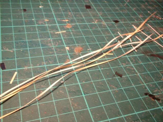

5. Take some sticky backed coloured vinyl....
Then cut into 1mm strips...
6. Again using the cutting mat grid stick on the glazing bars...

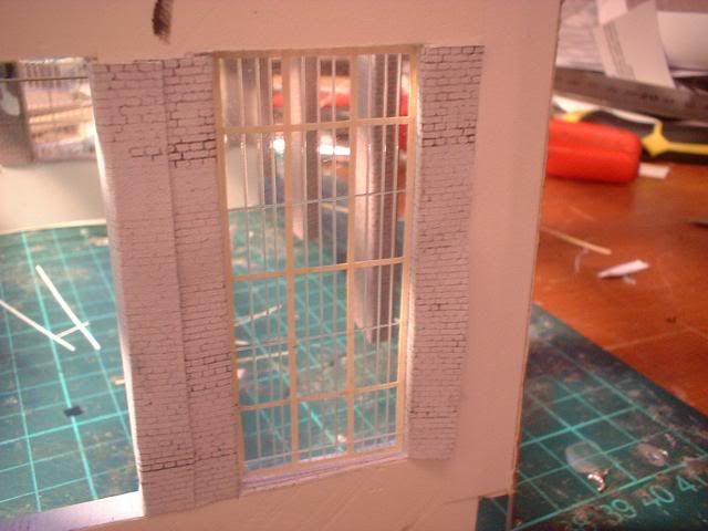

7. Fit window into hole in brickwork...
8. And thats it, nice and simple.....
As the vinyl is coloured there is no painting and no gluing either!
9. With the lights off the reflections realy bring the building to life....
Right only another eight to do.

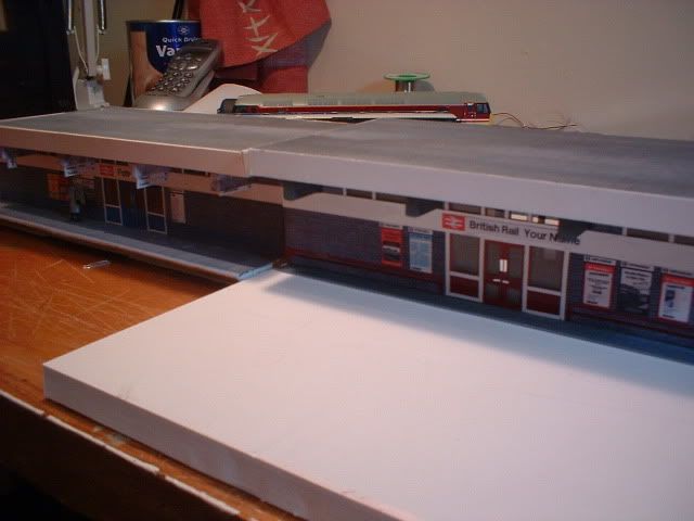

Postby 87 101 » Wed Aug 12, 2009 11:53 pm
Then there were two!
This second station building is destined for the bay to raise some funds to buy the track. :wink:
