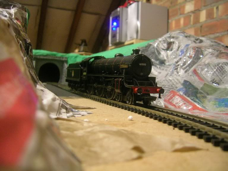

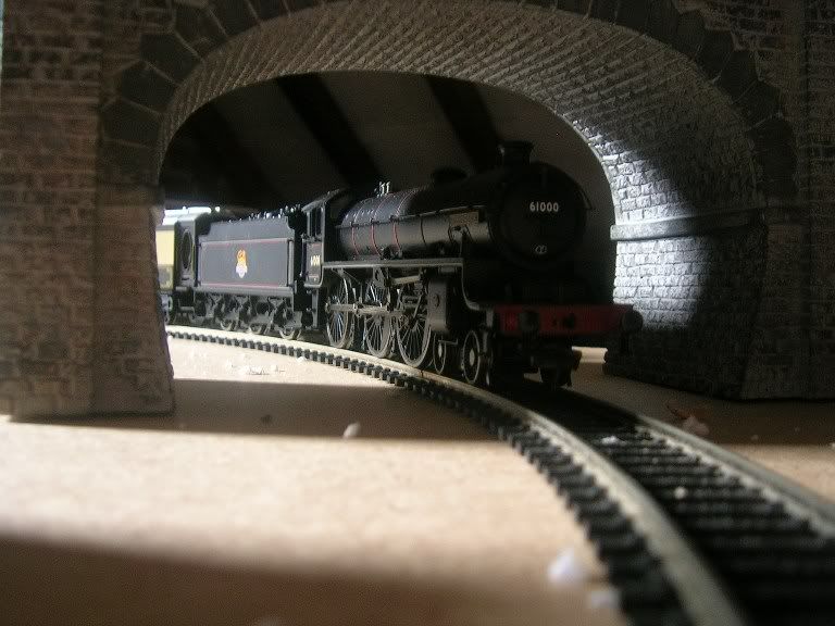

‘Springbok’ comes into view through the new addition to Lodge Valley.

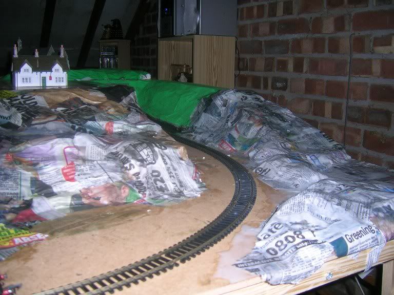

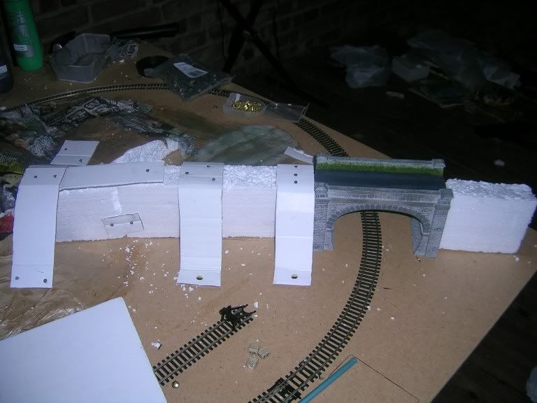

More polystyrene and cardboard!!! :evil: This will create the road leading to the bridge.
When the cutting is complete….a look back at progress. ‘Springbok’ is on the main branch line passing some sidings.

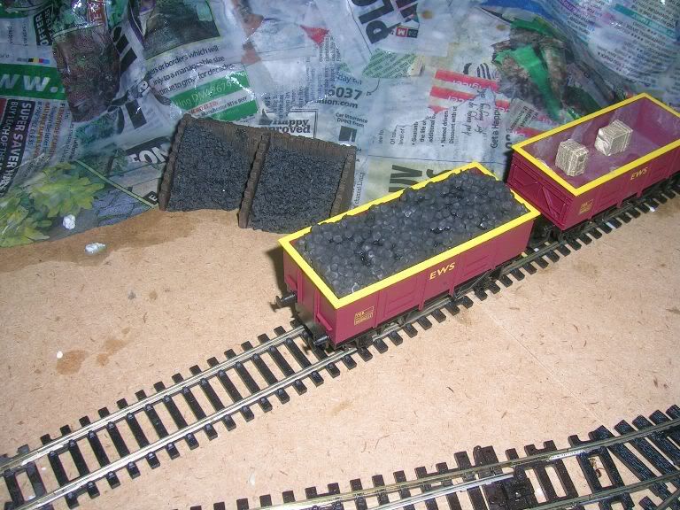

A close up of one of the sidings. My wife was feeling creative and decided to make some coal from polystyrene. :)

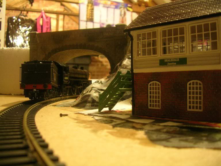

‘Springbok’ passes the signal box and proceeds under the bridge.

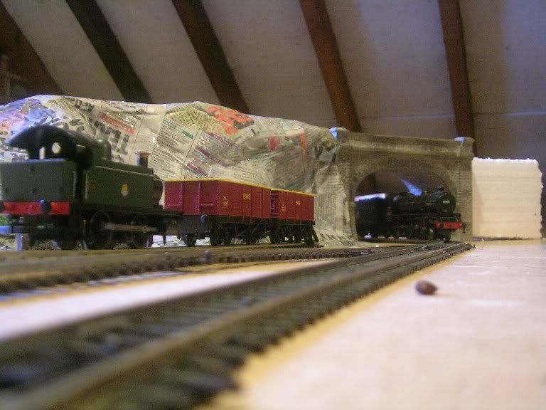

An overall look at the progress at the other side of the layout. The cutting leading to the tunnel is now complete.

Looking really good, i like the bridge a lot, i had to do a "double take" on the first pic, looks like you've been away taking pics on a preserved line for the weekend.. :wink:

I'm sure you'll pick it up as you go along, thats mostly what I did :D The wife likes that first picture too :wink: I do admit the lighting at that particular time was pretty good, just hope I can recapture it in future when I progress further on the layout!

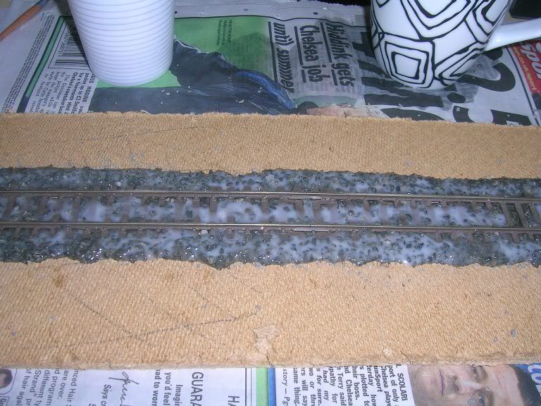

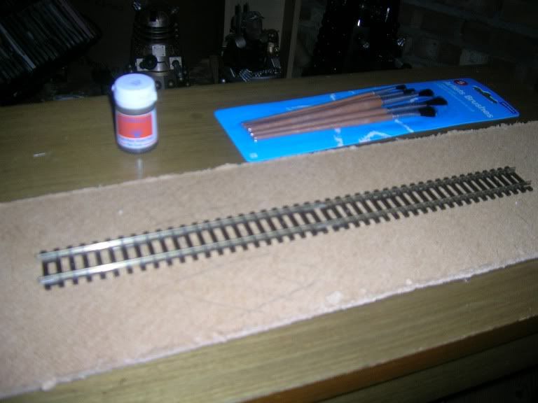

Had a delivery from the post lady on Saturday, Railmatch Sleeper Grime so I’ve had a play on a piece of tester track and thought I’d share the results.
Phase 1: Bought Sleeper Grime

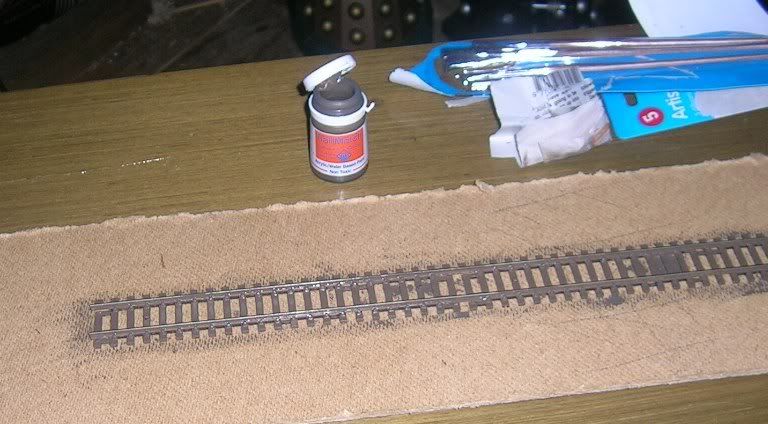

Phase 2: Before: Black, shiny track attached to some spare MDF.
Phase 3: After: Coated with Sleeper Grime

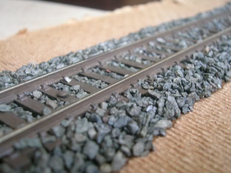

Phase 4: Added some ballast

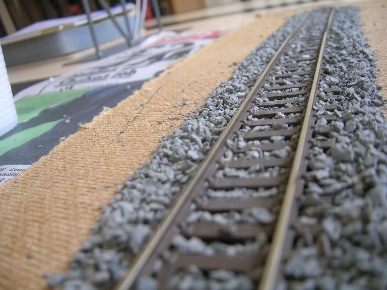

Phase 5: Glued the ballast via the usual method, spray of water followed by a 50/50 mix of PVA/water and a drop of black paint.
Phase 6: Sat around waiting for it to dry

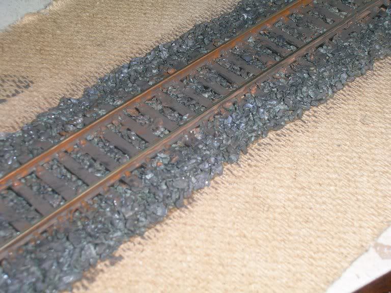

Phase 7: Weathered the track and the ballast some more

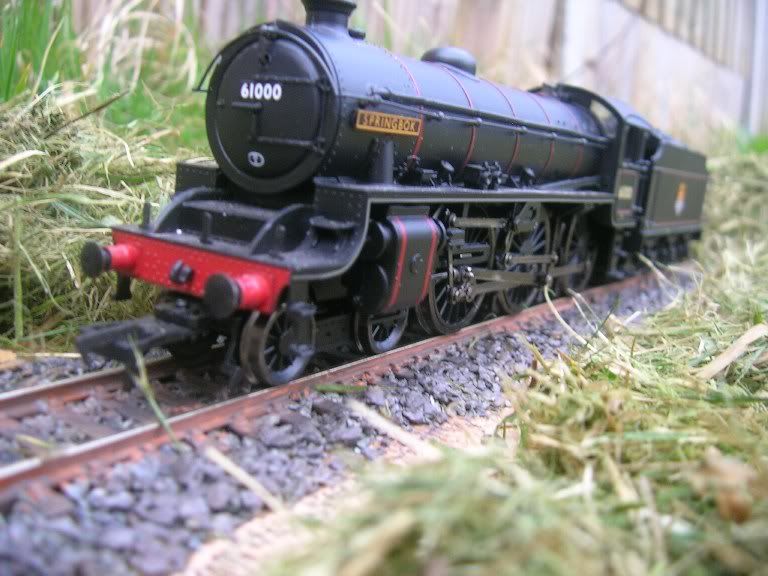

Phase 8: Enjoyed the results 8)
Now I’ve just got to do this on the whole layout! :twisted: Let me know what you think. Any improvements or changes you would make?

Great stuff. Just one observation... What type of ballast is that ? The stones look rather big.
