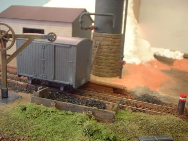

Troysdale goes green!!!......
... well a tiny bit of it anyway :shock: :shock:
I fancied a change from the last few weeks so decided to do a little ground cover, earth/grass scatter plus some field grass, finished the Loco coal staithe and fitted some "low-budget" but effective buffer stops

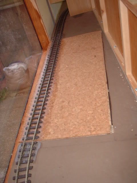

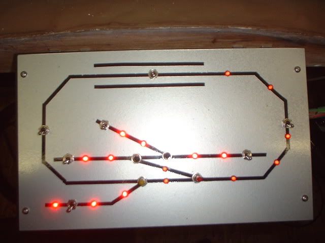

Firstly I properly wired up 1 lane of the traverser/fiddle yard, then I wired in led's to show the state of each isolated section, i will wire point route indicators next time I feel like wiring
Traverser track
Route "live" indication

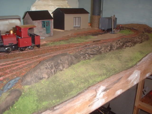

Then I built another loco, its on the left in the next picture, its a Springside kit on a heavily cut-down dapol "pug" chassis

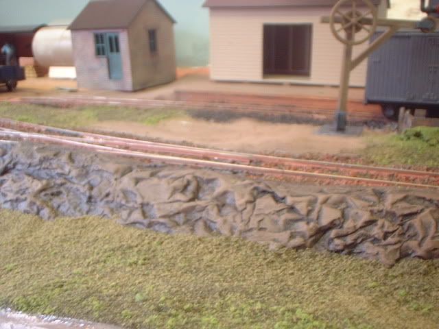

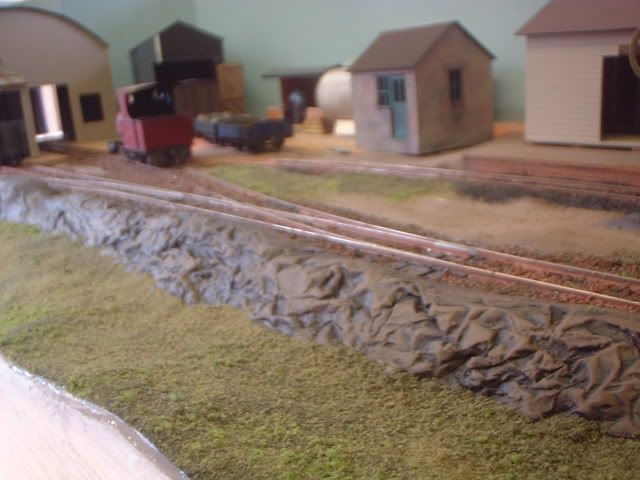

Next I had my first "PROPER" go at doing a rock-face, I'm pretty pleased with it, I used finishing plaster with poster paint mixed in, then used the "tin-foil" method on the wet plaster. When dry I applied a few black/dk brown 'washes' over it.
The full run of rocks here,
This made me turn then to more "greenery", this is the 'loco-service' area with water coal/crane etc...
And the same area but from afar showing more of the layout progressing

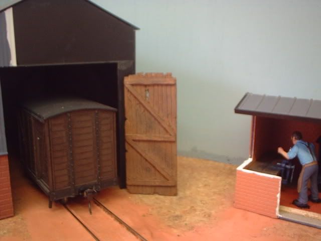

Next came my favourite part of it all...Scratchbuilding. I made a second workshop/shed building on the left in the next photo

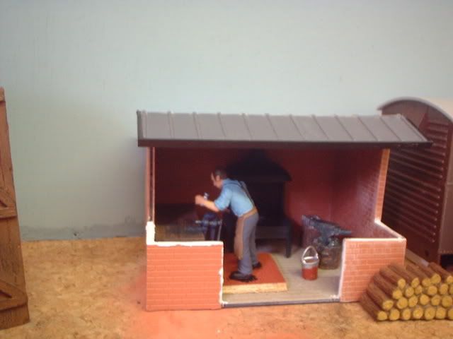

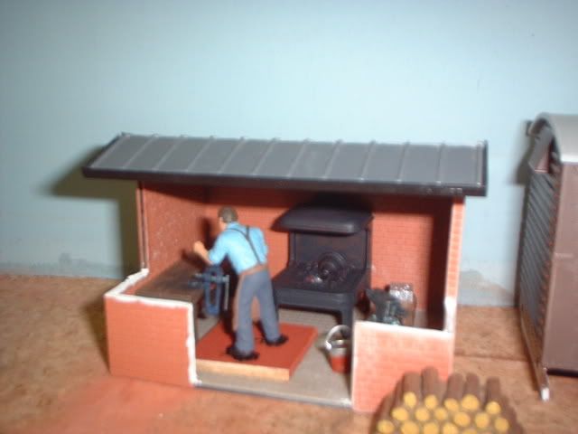

to the right is the Blacksmiths shop, scratchbuilt once again and I ordered some whitemetal parts to detail this buildings interior
The last photo shows the forge centrepiece, I am going to fit an led to the hearth to hopefully give a nice red glow from beneath some coals, lots of detail here with the bench, vice & tools, "Smithy" will look better with the plywood under his feet removed!!!, but this is my first proper bit of large gauge figure painting too, I now think its much easier in O gauge than OO to actually paint details but its more unforgiving at showing up your mistakes too.

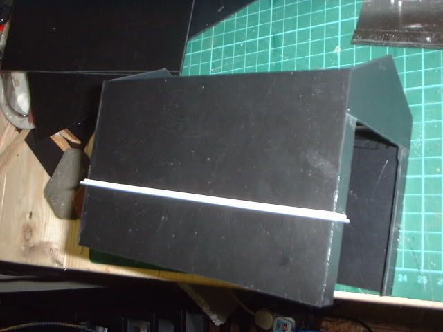

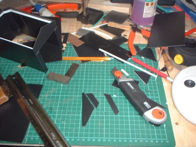

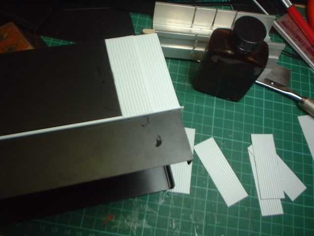

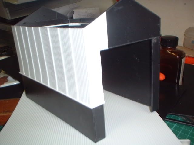

Last few piccies for now just show "in progress" shots of the 2nd workshop hopefully will help people to have a go at scratchbuilding,
A tidy organised workplace is the key to scratchbuilding?????

I particularly like the loco service area and the new workshop. The forge is nice too.

And the next three pics show my lack of ability to take good photos???, its either my limited camera or my limitations on knowledge/abilty to take a decent photo???
This one has focus on the trucks but nothing beyond,
this one the opposite rubbish foreground, but reasonable distance
and this one is just "average" all round
I have tried switching the camera between distance/close-up, flash/no-flash, resting it on a stand etc.. etc.. perhaps it may be my 8 year-old Fuji finepix 1.3 meg camera???
constructive critisism/assistance welcomed
