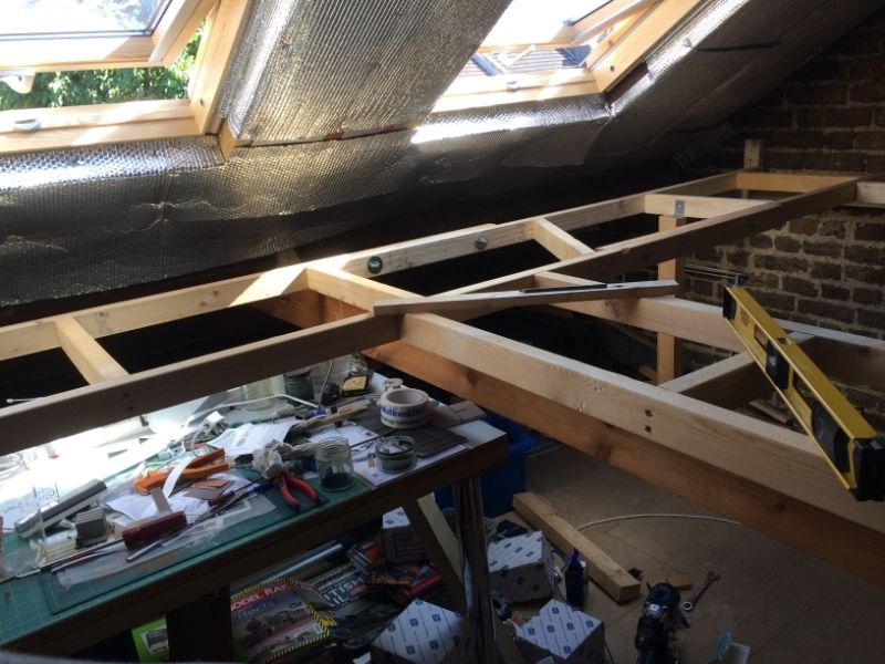

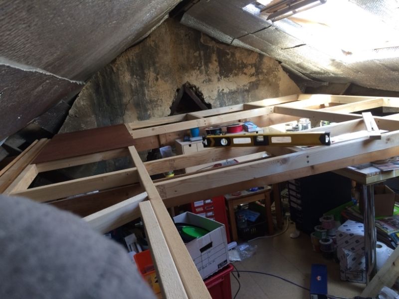

This weekend I completed the basic framework. This time instead of using small lightweight battons, I invested in some CLS studwork timber to use as the support. I have some big spans to cover and lessons learnt from the original layout dictated I upgraded the basic frame with something chunky. So out came the chop saw (as featured in one of my first posts) & we completed something I had started some months ago...:
I chopped a pile of 1' lengths & screwed them to the wall to act as fixing points for a horizontal section which when levelled supports the west end of the layout.
Then I extended building on what I had constructed previously to complete the studwork frame. I used coach bolt to extend across the longest span. It is pretty solid!
Next I was going to thread a bus wire round the whole frame work before I start any track bed construction. My usual choice for a bus wire is 2.5mm twin & earth. I strip out the live & neutral to use as the bus wire & the save the earth for droppers from the track. Previous posts in this thread describe this on previous layout. Worked well!
