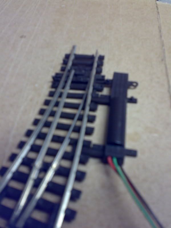

Have taken delivery of 4 of the new Peco PL11 side and surface mounted point motors, have just done a little test setup to see how they work andI have to say they are in my opinion very good.
Very easy to install, to my mind a vast improvement on having 300 small huts on your layout (if surface mounted), So much easier and tidier than cutting a massive great hole in your baseboard and they appear to work very well (so far)

Right Ok, whats involved with the wiring, switches then. How do you set it up?

odd question, but keep with me.
could you mount one of these upside down?
still adjacent to the point but in a trough cut into the board?
asking since that way you could ballast over the thing and never see it (or hardly see it) with a fake point machine adjacent to the tiebar to hide the connection?
also does the motor latch? i.e. if you took the spring out of the point would it still work?
wondering on the last point for driving home made points, the first point for hiding the things.

just wondered, i know the idea is to avoid having to do anything to the baseboard but these would be ideal for situations where a sub surface motor isn't practical - e.g. there is a whacking great cross member below the board, or a running line.
I take it there is no aux switch since i can only see three wires (a pity that)
I just think these things look daft ont he surface.

OK Questions:
For those who missed it in the track thread, Yes this will operate the new Hornby points (with the slide bar)
Upside down: yeah will work, id suggest that you put it at a bit of an angle so you only have the end showing which could be hidden even more with ballast, bit of weed. Most of the body would dissapear into the baseboard.
Points without springs: No it wont hold it. there is now force applied in either direction once the solonoid has fired, it just swings around.
As for setup, well as a DCC man, im using Lenz LS150 accessory decoders and my NCE powercab so its just a case of wiring it all up. But they operate/wire up etc exactly the same as a "normal" solonoid point motor. 16V AC and a siwtch of some descrption.

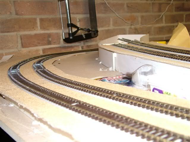

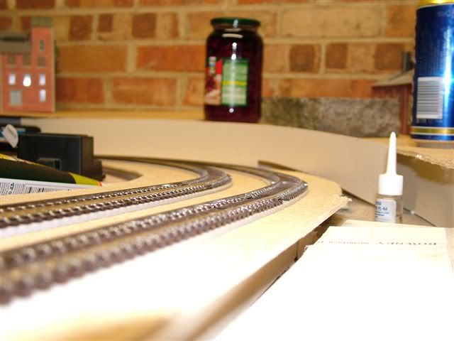

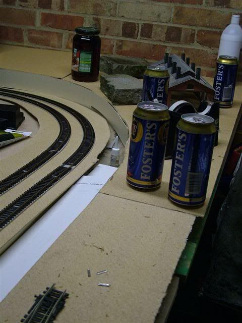

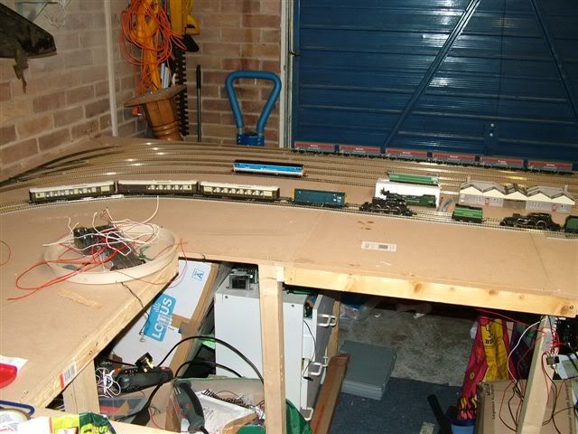

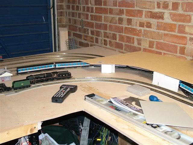

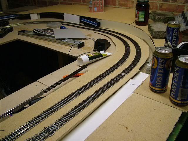

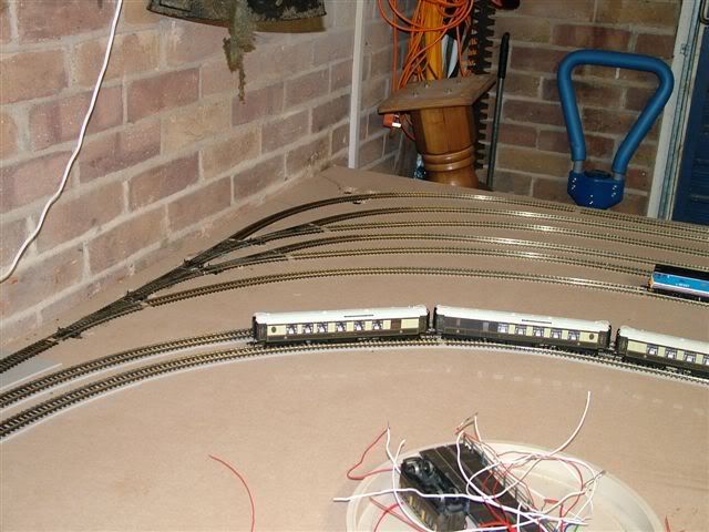

Postby B@rney » Mon Feb 18, 2008 9:43 pm
Well more track laid,
Mainlines now getting there, both inclines now accesisble by most locos hauling 6 coaches. (remaining locos will be "fixed" so they can too)
All six hidden sidings now all electrified with working points and actual exlectric too.
The railfreight ferry wagons are sitting in siding number 5, one more between them and the drop of death, the NSE 50 is in siding 1 and the coaches are all coupled running from the mainlines to the same siding. This is the access in from one side of the layout and you can just see the point work on the pics for the other side access.
The track switches take place on the inclines as the sidings are only accessible from the outer track of the mainline.
Next step is to put a temporary board over the sidiings and run a length of track so some full testing can be acheived especially of the hidden stuff. Cos if that dont work once the boarding for the station is down then I got problems.
Ok enough waffle Pics!!
Cans etc. weighting down the board while the No nails sets., this higher level will contain the station throat and a kick back siding out of the station
Looking the other way
Pointwork for the siding access (hidden remeber)
Sidings, the Turntable is about in the position where it will eventually sit, this will become loco yard, steam sheds off the turntable and at the other end to the right will be deisel sorta depot/ stableing
Couple of general veiws of the mainline inclines in each direction
