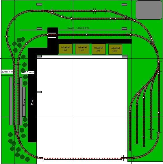

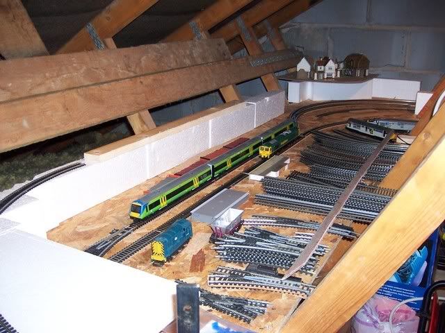

A year on and it's time to return to the loft to carry on or start again. I have decided to start again as I was unhappy with the plain, flat option I had started with (everything on one level). I have been playing around with a few ideas and have come up with the following plan (using winrail):

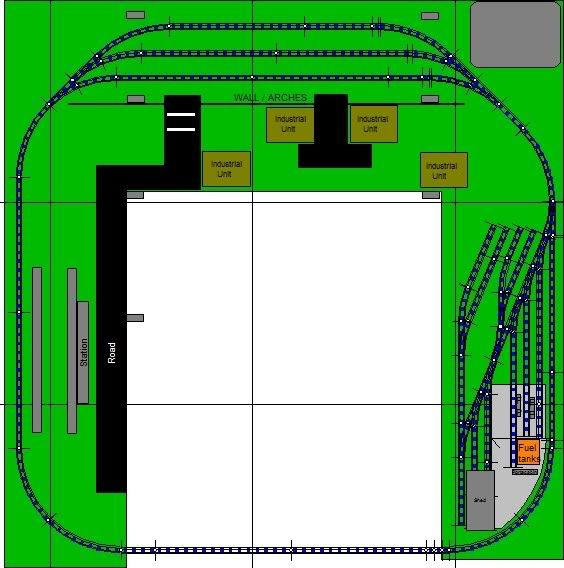

Freight would run around the blue lines which would all be raised on viaducts, etc on top, bottom and left boards whilst the majority of the right board would be totally raised for the shed, fuel, sidings, etc. My 170 DMU and 43 HST would run around the red lines.
My existing stock is (1 of each) class 37, 31, 43 HST, 08, 170 DMU (central trains) - just odd trains I have collected over the years!

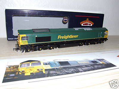

I would like to add a Bachmann 66 freightliner, simply because I like the look of them.
Anyway any comments, concerns, of alternative ideas would be very much appreciated as I really am new to this and don't really know much about trains either!! I just like the idea of giving it a go.

Postby S_Jay » Mon Feb 09, 2009 1:19 pm
How do trains get from the red section to the blue section :)
Nice plan by the way it's very easy to see what you are trying to do :D

S_Jay wrote:How do trains get from the red section to the blue section
My plan was ... they don't.
I was just planning to run them as 2 totally seperate lines, keeping the freight on the upper section.
Would that look silly?

Postby zabdiel » Tue Feb 10, 2009 5:11 pm
I don't think it'd look silly, in fact I think it's got potential too look rather nice. The good thing about the plan is that you don't have any problems with gradients as there aren't any!
I think the station might look a bit odd with the island platform and the platform to the right too. Maybe just have the island platform and save yourself a bit of space? I feel like the depot area has something missing but I'm not sure what. You might be able to get the passing loop on the freight line a but longer if you used curved points and long freight trains are always good :D Is that loop going to be hidden btw?
Have you though about access for the red fiddleyard? How about adding a second fiddleyard under the depot? (even if it's just a loop big enough to hold a DMU?
Ignore my comments if you don't find them helpful!

Postby Rammy » Tue Feb 10, 2009 7:01 pm
zabdiel wrote:I don't think it'd look silly, in fact I think it's got potential too look rather nice. The good thing about the plan is that you don't have any problems with gradients as there aren't any!
Ignore your comments? No chance! That's exactly why I posted here - I want some comments. As a newbie, I don't want to keep starting layouts and then changing my mind.
I think the fiddle yard under the depot is a great idea. I'll have a play around with the plans to look at that.
I'll have another look at the station too. I really want to use the Superquick A10 station kit I built (line side version not terminus)
Thanks for the comments - more welcome!

Mighty wrote:Nice plan - I am assuming you can run locos on both blue and red at the same time?
The superquick terminus is in my 'inbox' ready to build - I'm fairly sure that it's one and the same - you can either build it as a terminus or as a through station, probably by rearranging various bits and pieces. I'll try and check for you.
Yes, red & blue will be running at the same time on different levels. I've made a few changes last night.
This is the lower track running the passenger trains:
The right hand side under the depot will be a small fiddle yard as suggested by 'zabdiel'
and this is the upper track running the freight:
Still some work to do with the trackwork in the depot. Not happy with that yet.

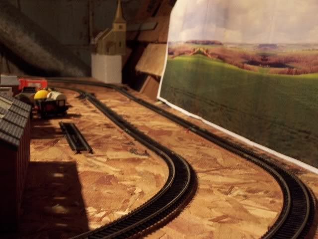

After a bit more tracklaying and running the 170 DMU on what was down, it was clear it didn't like the curves around the industrial estate. So I have now change this area to straight track to run behind the industrial units. Although this will make the trackwork rather plain, I feel it may look good with the trains running behind the units.

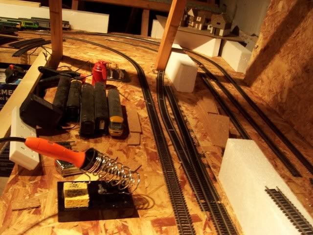

I finally managed to get a few hours in the loft this week to make a little progress.

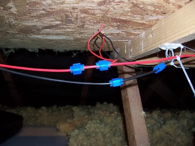

I have been adding droppers linking in to the bus wires. Probably need to add lots more but I've just added enough to make the whole track that is laid live so I can play around and make sure I am happy with it.

Here's the track laid & live so far:
This will be Chadwood station with a freight line running on the raised section:

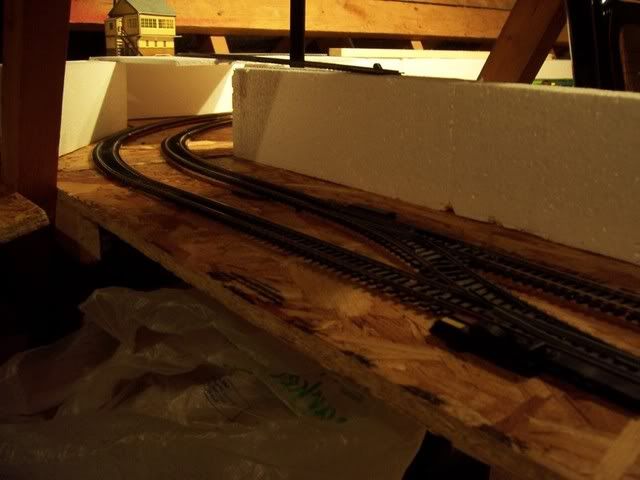

The approach to Chadwood station. I am thinking the freight line running above will cross on a girder bridge.
The industrial estate on the left and passenger train storage (behind a backscene) on the right hand side.
This plain looking board may eventually get covered with a fuelling depot & sidings at the height of the freight line. It is currently just the return loops for the passenger lines.

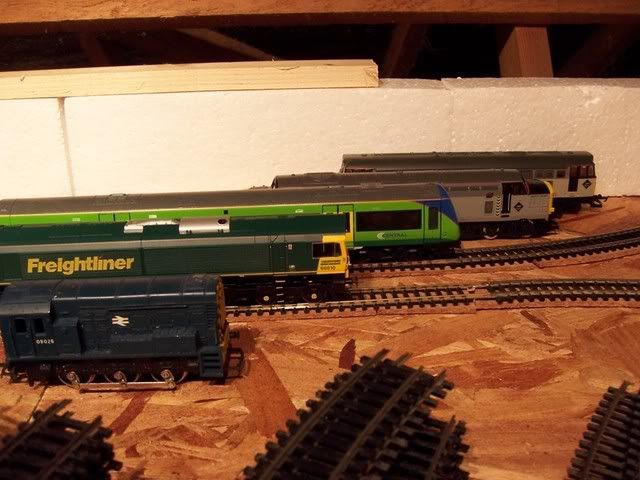

The current stock - total mix of eras for now (all with Hornby decoders fitted):
and the non DCC stock awaiting chips:

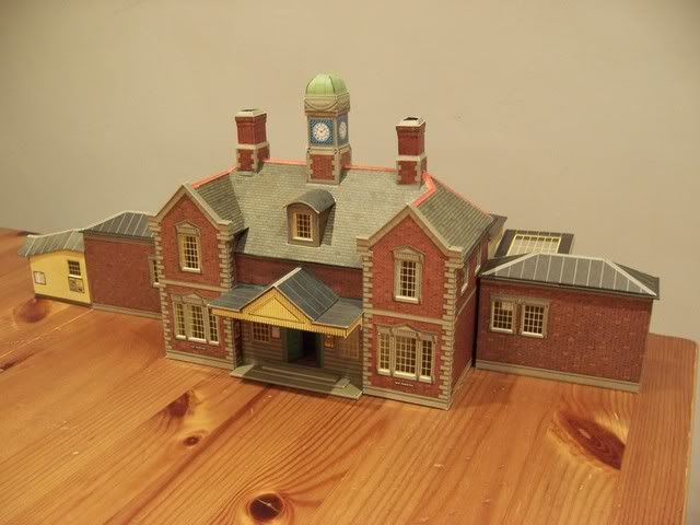

On the nights I haven't been able to get in the loft, I've been making progress with the Metcalfe station building that will be used as Chadwood station. I picked this up still in kit form for £3 at the small Mickleover club exhibition last year.

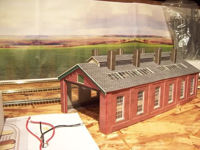

Not sure if my Metcalfe engine shed will really fit in with the space or era I am modelling. I assume this is more steam based?
