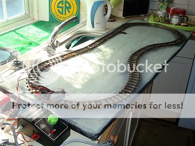

Posts: 2353
Re: Code 75 OO on Celotex?
Postby Emettman » Sun Feb 12, 2017 5:41 pm
hockeyshooter wrote:I wouldn't use Celotex - way too fragile.
I've used single pieces of Celotex or similar brands up to 4ft by 2ft in 50mm, with no issues with fragility.
With 3D scenery of the same material firmly attached, producing something of an L girder effect I'd probably br happy with 25mm thickness.
The outside edges I seal with duct tape.
If using several boards I would use a plywood outer frame to take pattern-maker dowels.
My latest usage has been a 4ft by 20" by 1", board carrying a 32mm gauge display track for my kitchen window-ledge.
No risk of breakage lifting the thing in and out.
(but it is well supported when in place: if that was at the ends only I'd use 2 1" pieces to give a sandwich structure.)
