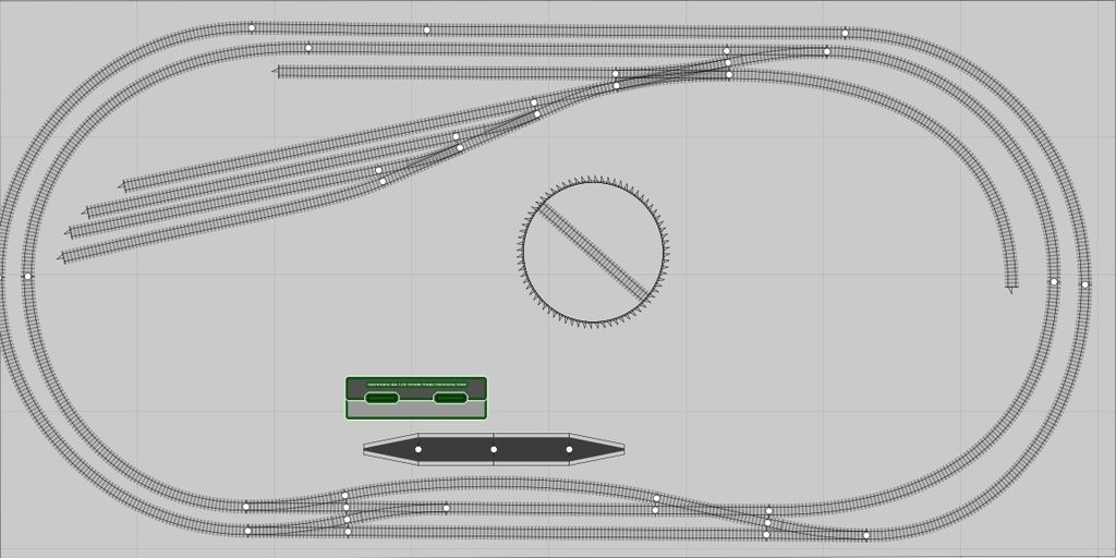

had another tinker - will the tinkering never end! - and now have a proper double loop with 'round and round again' (or whatever it is supposed to be called), still messing with good area but I am content to get the loops right as phase 1 of the build and then judge where the landscape and stuff will go - really dont want to stuff it full of track
the build will be DCC and is intended to run 2, maybe even 3, locos at once - one passenger on the loops, one freight fiddling

OK you now have a double track oval! You can run three trains with that, one on each circuit and one shunting. I'd get rid of the section of track past the station and that diamond crossing.
You have the crossover from the outer to the inner track, add another going the other way (from the inner to the outer) just after it. That does what that strange piece of track with the diamond crossing does but a lot simpler and more prototypical!

LittleSkink wrote:had another tinker - will the tinkering never end! - and now have a proper double loop with 'round and round again' (or whatever it is supposed to be called), still messing with good area but I am content to get the loops right as phase 1 of the build and then judge where the landscape and stuff will go - really dont want to stuff it full of track
That's an improvement on your previous sketch, apart from the short loop with the diamond crossing, which doesn't achieve anything now.
Are you definitely back to one level for this plan: we looked at looped 8's with gradients when you had a smaller area in mind...

Use that in a double oval (with the slight dent to the inside : put a signalbox on the outside_. and you will have both the twin track option and the twice-round looped 8 option available in a compact space.
