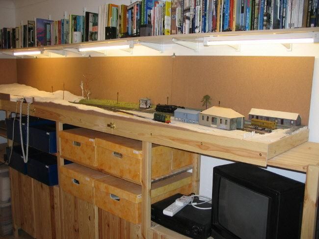

You could do worse than old kitchen units - 2 feet deep and about 3'6" high or thereabouts, with a chipboard or plywood top. (I wouldn't build the layout directly onto it though, just treat it as a rough worktop).
B&Q used to do a value range but that seems to have died the death, if you know anyone who fancies a new kitchen see if you can blag the old units.
Failing that build a carcase from 1/2" chipboard or Sterling board, and bung some sliding doors on it. Sliding ones have the advantage that you don't have to faff about adjusting the hinges.
This was built on Ivar shelving units from Ikea, which gives you a much higher baseboard height if you want it, but only about 18" wide:
Portwilliam - Southwest Scotland in the 1960s, in OO - http://stuart1968.wordpress.com/

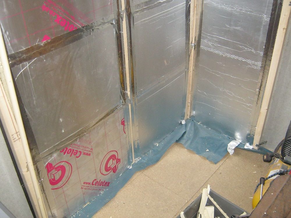

stuartp wrote:Thanks b308, my garage is almost ready for fitting out so that might save me sawing up a lost of OSB ! There used to be an even cheaper range - no legs, just full height chipboard - and including some very cheap and nasty melamine doors for about the same price as the one in your link. I wouldn't have put them in a kitchen but they were fine for the garage (which, come to think of it, is probably why they didn't sell...)
Have you insulated the garage walls ?, at the moment I have a kitcar in their and it has been sat there for around two years now (long story) and only a minor amount of dust is on the shell, and I mean a minor amount.
The rafters are open, no ceiling, which I would like to keep as I can also store things up there like bits of wood etc.
that leaves the opening between the top of the wall and the tiles, but as I say, it doesnt let anything in..apart from the cold :lol:
I have to sort some idea for this, I can have heating in there, but seems a waste of time until I can come up with some idea for the gap.

negativepitch wrote:Have you insulated the garage walls ?
Oh yes:
The walls are battened out with CLS then lined with polystyrene veneer, then 50mm Kingspan between the battens, there will be a lining of 12mm OSB over that. Mine has a flat roof so no storage potential, so I'm going to make a false ceiling once the walls are all finished. It would probably have been easier to knock it down and put a nice new wooden shed up, but I wasn't allowed.
