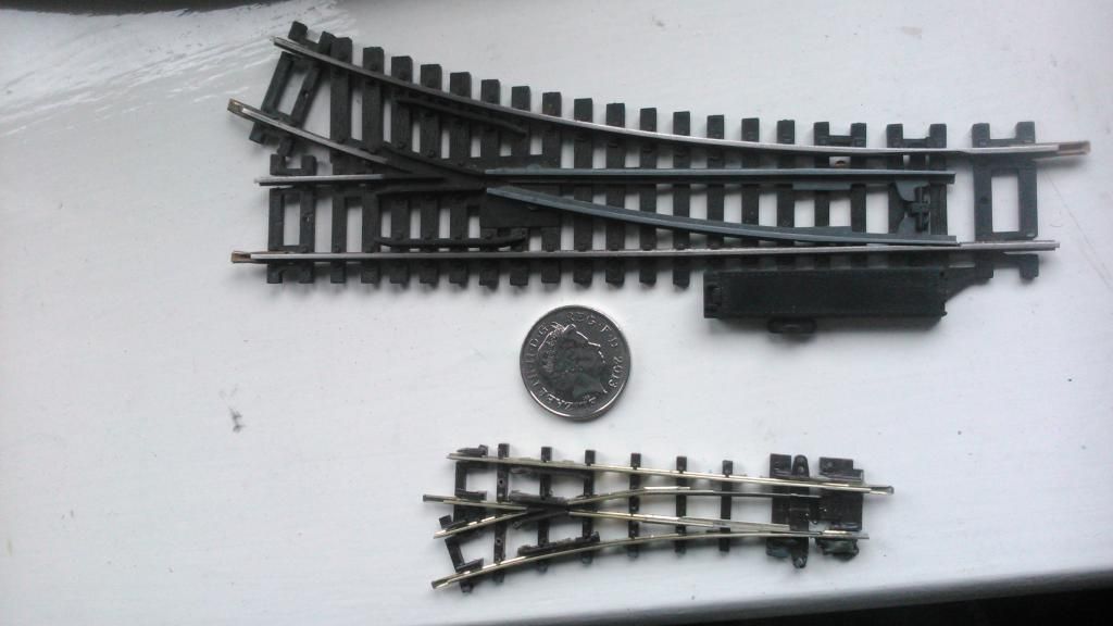

Does anyone have a side-by-side photo of like for like?

There's a definite size difference, I am amazed that people can model such detail in 2mm. I'd agree to go and have a look at things in real life, but here's a picture of a set of OO gauge points and a set of N gauge pints with a 10 pence piece to give you an idea (ignore the sleeper spacing on the N gauge point, it's a possibility of OO9...):
