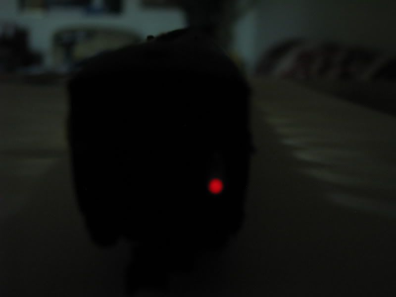

Anyway I use DCC Concepts flicker free kits. For me far more flexible, I can get the correct lighting and spacing between compartments right plus they last for about 3-5 minutes without voltage....flicker free.
Flicker free in Dapol Gresley.
Yes that red is on but has being sitting without voltage for about 3 minutes.
As I said if your on a budget they will do fine and have many other uses.
