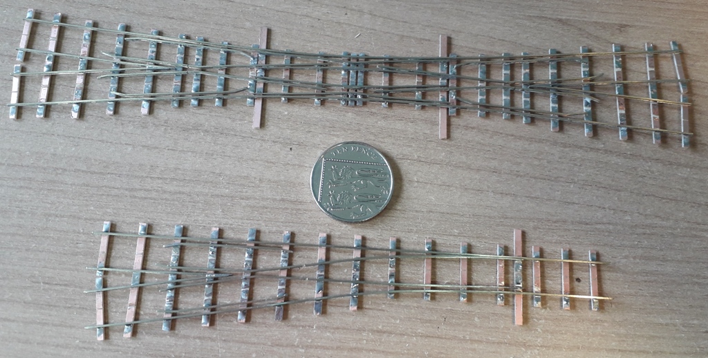

Bufferstop wrote:I'd suggest for isolation you slip in an extra sleeper so that the bit that needs cutting is as short as possible. Once its firmly stuck down cut the rail with a slitting disk in a small rotary tool. Fill the gap with Plastic Padding, two part epoxy glue or even Milliput, then file it smooth.
Thanks Bufferstop,
I really meant to say, I don't know where I need to isolate it! I think I've got that worked out now. I ended up filing away the copper as, given the size of these, I don't think that I could get the control needed using a slitting disk. I cut the rail between the common crossing and rails using a piercing saw.
I've finished my first attempt at the double slip. It isn't perfect (it does work) but it is encouraging enough to have another go taking into account what I learnt from this attempt - ten pence piece included to show the size of these.

Thanks b308, I'll have a look at one of the ordinary types but I was hoping to find something that could give me the check rail clearances as well. Unfortunately in that respect, the 2mm Association one wouldn't work as, while the gauge wouldn't be too much of an issue in isolation, their tighter tolerances on the check rails would be.
