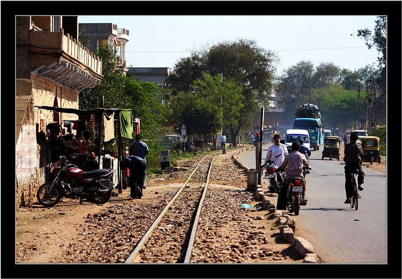

Have you seen some narrow gauge railways?
You can't see the sleepers!
It might be mud and stone fragments in quarry areas, or grass on cane railways.
The track was as rarely "freshly maintained" as the locos were.
In the model form you can't count on the loco cutting its own swathe, however.
In the past I've used Plasticine for this, in grey or brown. Laid in soft snakes it's quite quick, and it can then be textured and adjusted, unlike any material the sets solid.
Not saying that's the best way, but it worked for me.
Chris.
Spot a sleeper:
