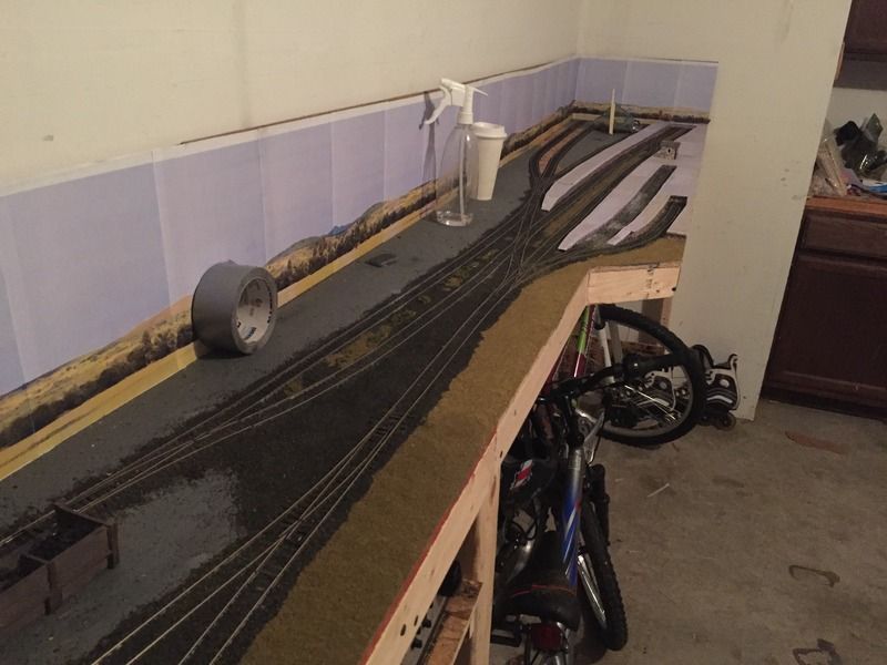

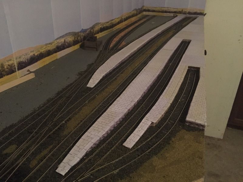

Ok so probably got just enough in that pack to signal my main passenger platforms
Here is a pic of my station - you can see the start of the two exit routes bottom of pic
The platform use from right to left is as follows
Parcel bay
Normal bay platform
Main platform 1
Main platform 2
Goods inbound line (possibly going to fence the left side of the platform off - or could it be an "overflow platform"???)
Last 2 sidings on the left are pure goods traffic/loco stabling
If someone can let me know where they would place the signals here that would be awesome :)

Good news. (So much easier to see the track plan as I write! Thanks for adding the photo). Looking at the track layout, the first three platforms can only send trains in one direction so only need one signal, not a junction signal.
It is only the final two platforms that need the junction signals.
The two sidings which don't have platforms need ground shunting signals.
There is a point I would add a signal in the other direction. This is near the clear bottle for trains to be held prior to entering the platform or the loop (They can only go into the one platform from here).
Ideally a single signal with two ground signals next to it, the two ground signals sharing the same ground post. The ground signals to allow trains to enter the sidings. The line next to the holding line where the trains pass over the double slip is a through running line and the signal would likely be before the back scene.
It is hard to see from the pics... I would put signals near the coaling stage on the way in. Not so easy to signal this bit, so maybe an idea to assume signals are off stage.
