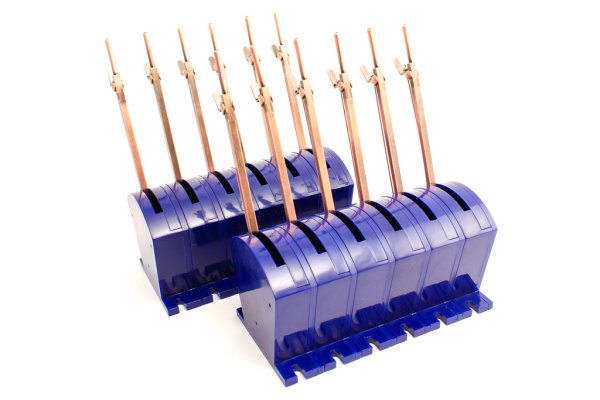

hey guys,
i was just wondering if you can get pre made switch panels? my plan is to wire up all of the points but want the switches etc spread out so they are close to the points themselves rather then having a single large panel.
it got me thinking and i was wondering if anyone does a 'kit' or pre made panels so i can keep it neat and tidy?
kind of like the Hornby switches that you can place into a bank or the DCC concepts ones (which i would love but are just to much)
but i would be using normal flip switches like
