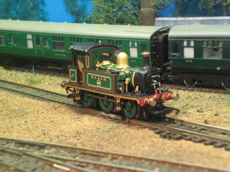

A few of mine.
(All side transfers tanks, bunker, splashers, and cab)
(Custom side transfers for tanks)
(Latest custom transfer job Bachmanns lbsc E4)

It varies from printer to printer its never the same. The new printer I had which was a brother I think, was very picky on colour mainly and getting it correct to match, so needs a lot of fettling to get right. The printer is generally set to thick or photograph paper, The old printer which sadly packed up was a lot easier to print with in terms of colours ect...
Forgot this one which was a big step forward with the homemade transfers at the time for me.
