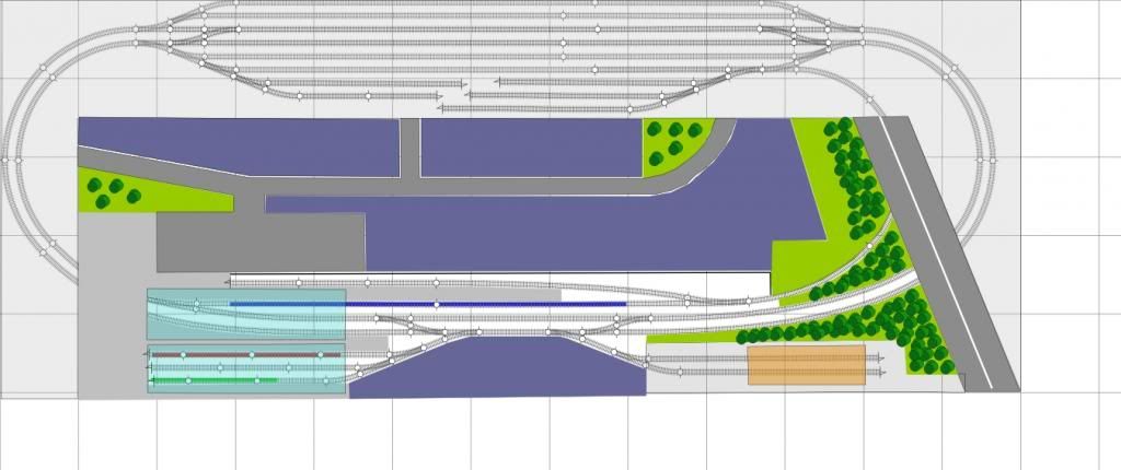

Postby N-ooby » Mon Apr 07, 2014 10:24 am
Right, I have come up with something.....any feedback/criticism will be greatly appreciated...
The station is on the bottom left corner, 2 x through platforms and 3 terminating platforms. The bottom right hand corner is a small maintenance building.
Also on the right is a 4 lane flyover as a scenic break
The purple coloured area's I am yet to decide on, I am wanting some kind of busy town/city scene, shops and businesses etc, no homes.

A few things spring to mind with the plan.
If a train enters from the left it cant stop at a platform without going up the branchline.
Access to the maintenance could come from a headshunt in the station. This will allow a larger area to modelled and also protect the main line without the need for trap points.
The facing crossovers in the station are then not needed
eg
Good luck with your build
