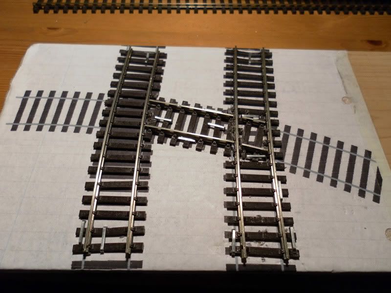

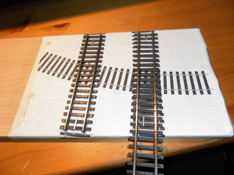

I have just tested the rotary tool option and it's simply a walk in the park.
This is a Clarke and incredibly cheap compared to a Dremel especially with all the accessories.
http://www.machinemart.co.uk/shop/produ ... ower-tools
I have used a diamond blade and the cut is neater than I would ever have imagined.
