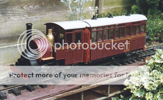

Unless rich, I'd suggest G (or other "large scale") is best for making large models of little trains.
I custom-built this to cope with 2ft radius curves, and that coach section length was maximal.

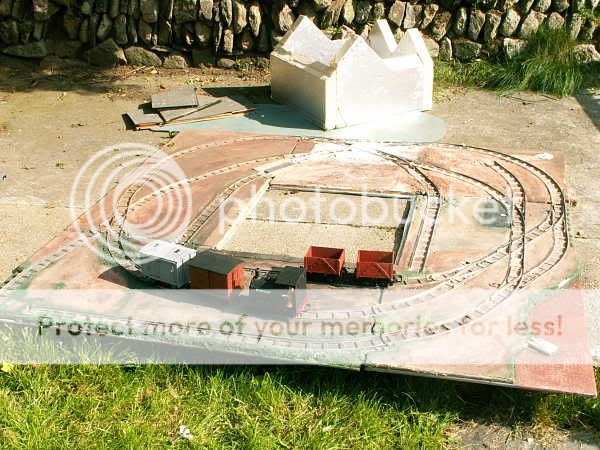

These made for a portable G scale layout for the public to drive:
Five sidings, a loco siding, an oval and a run-round loop in 6ft square.
Track plan visible during constuction:
