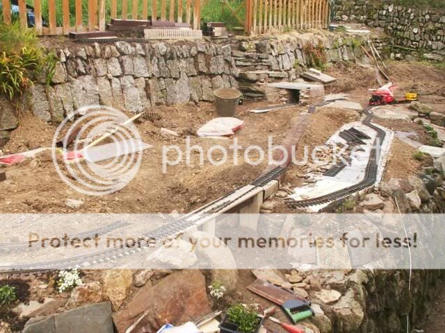

Two materials that can be very economical and low maintenance: twinwall polycarbonate sheet, and square section drainpipe.
Here are both in use in the construction of my (cheapish) garden railway in G.
It's been an effective technique for 10 years in a previous garden and six in this one, compared to some more conventional approaches.
Chris.

We are talking a double-track line, principally?
In which case I'd definitely recommend the square downpipes as the lower stratum. It produces even gradients, or none, very quickly and easily.
(By putting the line in first, looking like a low viaduct, then raising the rockery up to it and around it. Levelling and truing that 12ft straight section of embankment trackbed in the photo took about fifteen minutes.minutes.)
Cosmetically, if just for winter, the brown colour pipes won't show much, or they can be given loose gravel for the winter, (Dysoned for re-use at the start of the season?) or maybe have strips of wheelie bin cover vinyl stickers of plants applied! (probably cheaper than gravel.)
