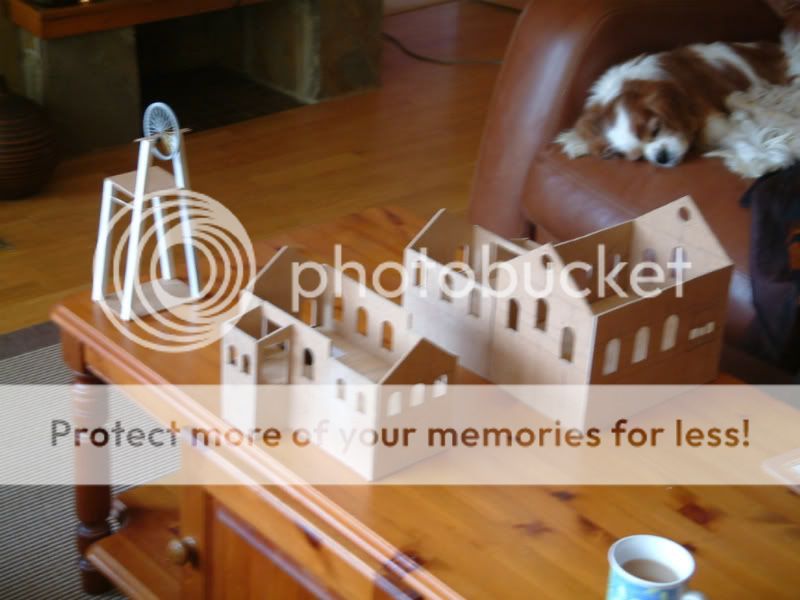

Hopefully i will be able to resume work on the Blue line soon, during the winter i have been building an addon board to be used either in the garage as part of the indoor layout, or during our long hazy days of summer, as part of the outdoor blue line.
This addon board will be a model of Coegnant Colliery in the LLynfi valley South Wales

More details of the construction of the colliery buildings[Image[/img]
