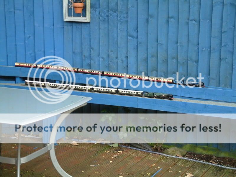

The garden railway is called the blue line because i wanted the layout to be a Railway in a garden, not bits of garden in a railway layout. In other words i wanted the Railway to blend in as much as possible, so to this end a lot of it was painted blue.
[[/img]Image
Other parts of the layout will be painted brown.
[[/img]Image
There is no track laid yet the rolling stock was iust laid on odd bits of track for the photographs
