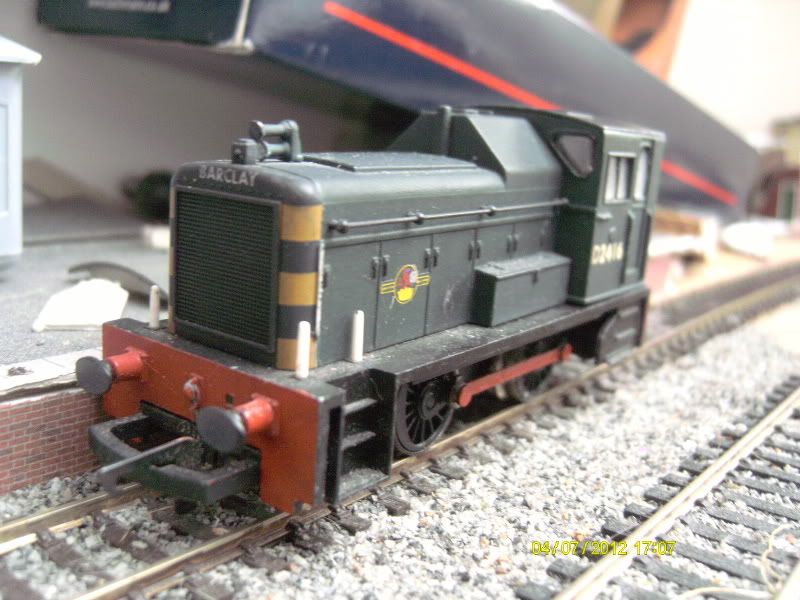

Has Hornby ever done a Green class 06 with wasp stripes?
Ken Shabby
Posts: 292
Joined: Thu Jan 15, 2009 12:20 pm
Re: Hornby Pug Other Body's.
Postby Ken Shabby » Mon Jul 09, 2012 8:36 pm
No, I do'nt think so. I came up with this one by repainting a BR blue one. I also added flush glazing which was a real swine to fit an added weight to the chassis. Look at all that dust.
Ken
D605Eagle
Posts: 2476
Joined: Mon Mar 22, 2010 12:58 am
Location: Staffordshire
Postby D605Eagle » Mon Jul 09, 2012 10:28 pm
Ken
Thanks Ken, that looks real sweet BTW!
