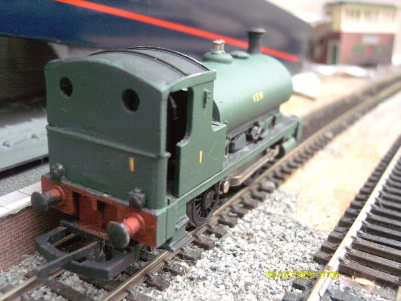

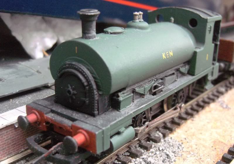

Here's a reasonably easy conversion of the Pug into a freelance industrial tank. It cost £7 for the loco which was in Midland railway livery plus another £4.00 including postage for another body which was cut up and used to extend the saddle tank and build the back wall of the cab.
As usual the camera is not my friend, Photobucket have changed their site and I can't work out how to make the photo's smaller, you can see every fault and every grain of dust.
Ken

Don't shoot yourself, that looks really good. It makes you wonder why on earth Hornby don't do a similar body with the saddle tank extended over the smokebox like 99% of 0-4-0 industrials are. I'm just doing a minor conversion job on an Andrew Barclay 06. Fitting small bachmann couplings makes a massive difference, and fittng a match truck with picups makes shunting a load easier. Is there a better 5 poll motor that will fit? or some sort of conversion to reduce the gearing????

I concur with Eagle, it looks okay to me. I tihnk you have to keep two things in mind whilst modelling: namely, that you're modelling something oily, dirty and noisy, and that it's a model. There's bound to be a few flaws here and there.

The loco looks very good and is less dusty than some of my stuff!!!
You should be very proud of your work.
It just shows the potential for the humble Hornby 0-4-0 I just wish Hornby would improve the chassis.

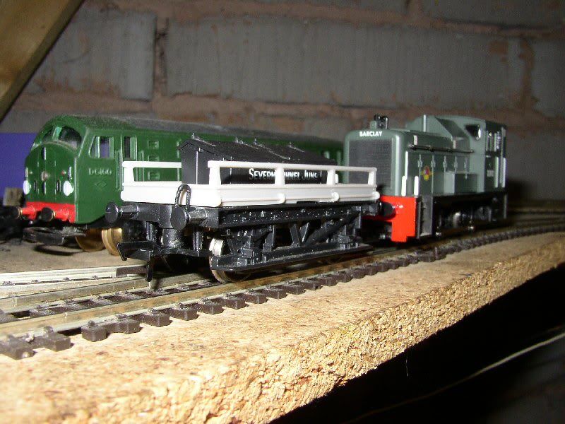

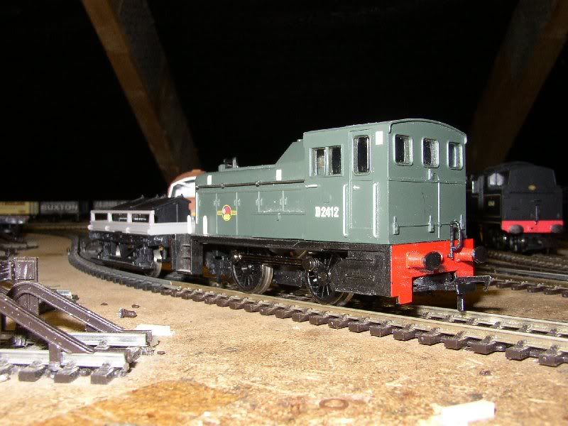

This is interesting. I've nearly finnished upgrading my 06, I've stuffed it full of lead in every space possiable, permently coupled it to a weighted old Hornby shunters wagon with picups on its wheels, fitted bachmann small couplings, lubed up all the axles and bearings with white RC helicopter gearbox grease, and I'm just wating for a flush glazing kit to arrive. It will happily pull 20 PO wagons and a guards van, not including the shunters truck at a prototypical walking pace using my feedback controller, get it up to running speed and flip it over to pure DC and it runs beautifully. It will go over any pointwork too without a hicup. Not bad for £7.83!
I'll pop some pictures up when I'm finished.

Postby D605Eagle » Wed Jul 18, 2012 4:01 pm
heres some pics...
