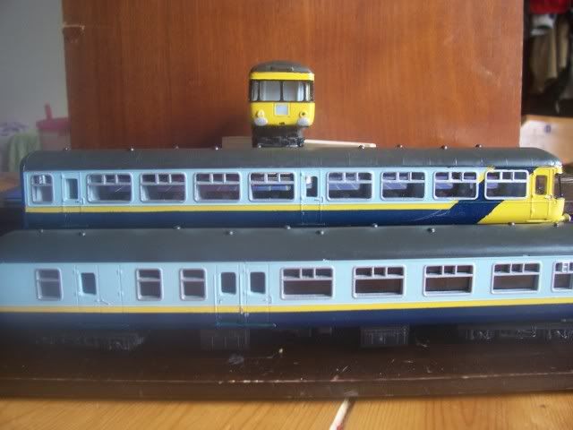

Gladly it has turned out just as i wanted . Onto the lighting now but i've still to get the thing powered.

I like the look of that, very nice ideed, do you mind if I steal the idea for a unit of my own? I have to get a couple of railbuses for a project I'm going to be working on, which will leave me with two spare cabs. How well did the cab fronts actually fit?

Superb work and good choice of livery. Are you going to get Decals made up for "Kelvin Scottish " ? that would really finish off a very nice job.

Yea gonna get Decals made up if i cant find a model bus maker that supplies them . The Dapol railbus cabs fitted perfectly apart from the roof section which i fitted at an angle then filled the spaces that were left. If you look close enough at the 1st pic you will see that the destination part of the roof is angled forward, i also cut away a small section of the roof to allow for the sloping front.
These were really old MkII's (apart from lima carriage as the centre car) . I've been debating whether to power the centre car so that the motor bogie will be hidden which will let me super detail the interiors of the cabbed cars.

Just fitted the original railbus cab glazing . I cut the glazing in half then trimmed some of the edging so that it would allow for where i've joined the cab onto the carriage. This allowed me to fit it back in with little effort.
This is how i have joined the cabs and the small section of roof. As you can see the dimensions of the cab and carriage are almost identical.
With the glazing , it's really starting to look quite believable now.

Right thats me finished for the night . Just spent the last half hour modifying a Lima 117 Dummy chassis to fit . Looks like a DMU now! :D :D :D
